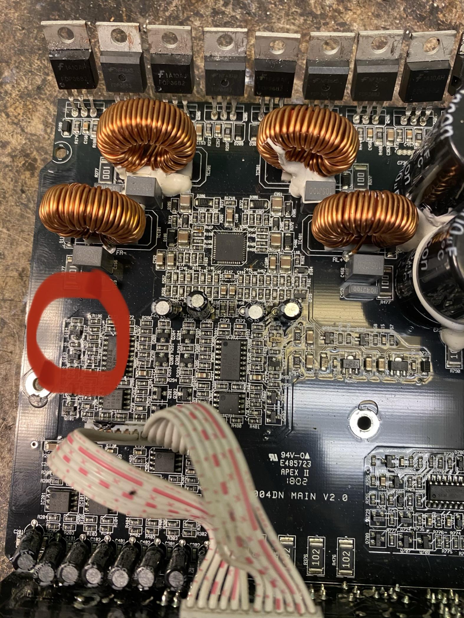

Isn’t the led supposed to be blue when the amp is working normally ?
I’m getting rail and regulated voltages .
But the led is red if I remove the regulators the led will turn to blue .
Ok I’m getting a problem with IC706.
It’s a LM317
With it in circuit I’m not getting proper voltages .
With it removed from the board this is what I get on the pads for it

I removed all of the regulators off the board since it didn’t make any sense .
Here is what I get on all of the pads now
IC705
Leg 1: pulsing voltage
Leg 2:-27.25
Leg 3: pulsing voltage
IC704
Leg 1:-0.68
Leg 2:-0.71
Leg 3:27.33
IC706
Leg 1:-25.36
Leg 2:-25.36
Leg 3:0.00

Ok I think I have figured out what IC705 and IC704 are .
IC704 is a LM317
IC705 is a LM337
IC706 is the issue not sure what goes in that location since no matter if I put a 337 or a 317 the 3rd leg has no voltage at all

IC706
Leg 1 is fed off the middle pin of the negative rectifier
Leg 2 goes to a pin 8 ( vb2)on the driver ic IRS2093M
Leg 3 goes to the source leg of half of the outputs
Any ideas what goes on location IC706?

Are those direct connections (0 ohms) or do they go through resistors?
Leg 3? High-side or low-side FETs?
leg 2 makes sense but not the others if they are 0 ohm connections.
Leg 1 goes to 1 side of a 2k resistor then to the middle leg of the negative rectifier.
Leg 2 goes to a 240 ohm resistor then to pin 8 of the IC
Leg 3 goes to a smd cap then to the source leg of the of the outputs . The middle leg of that output is connected to the output filter inductor
I can't understand the circuit from the information you posted. Maybe someone else who has worked on one of these can. Try getting the diagram from Rockford.
Ok I think o figured this out now .
IC705 is a LM337 which controls the -15 volts on pin 4 of the opamp .
IC704 is a LM317 which controls the + 15 volts for the power led
IC706 is a LM317 which controls the +15 volts on pin 8 of the opamps
Now I have a new problem . The led is supposed to be blue when the amp is powered up and playing audio . The light remains red even tho the amp is producing rail and regulated voltages .
I get no drive on the outputs .
Is there a way I can test for drive at the driver ic or how do I test for drive in this amp ?
