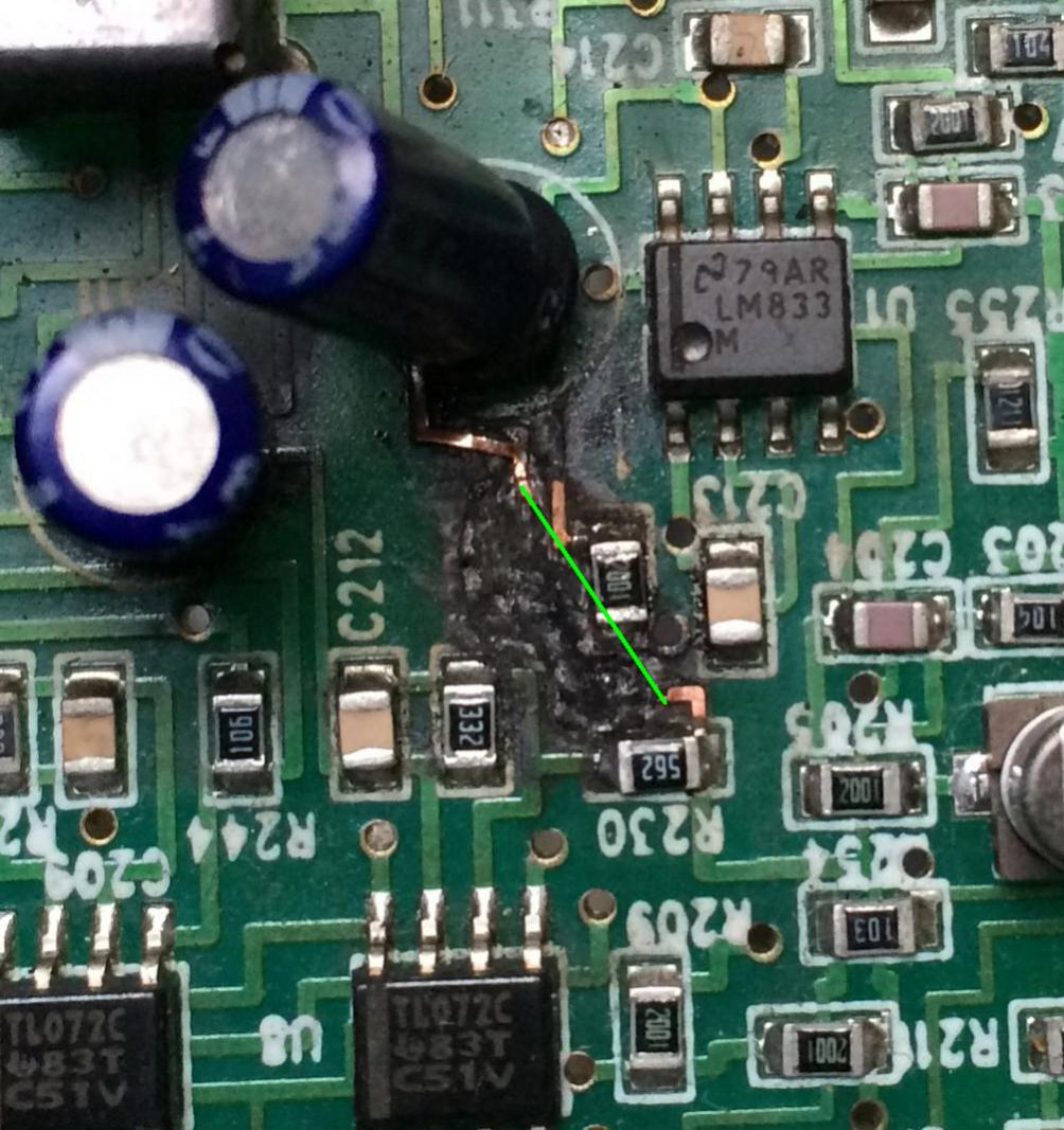

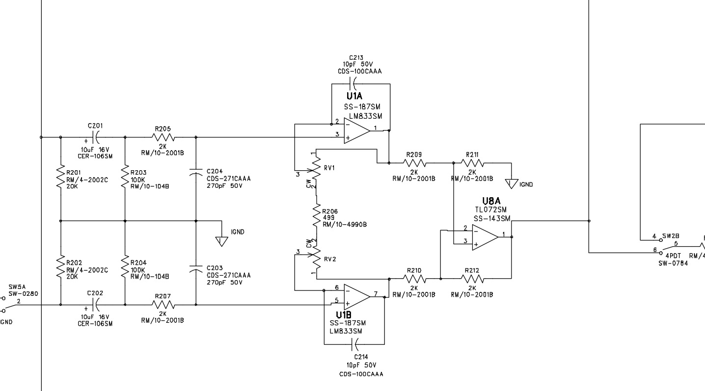

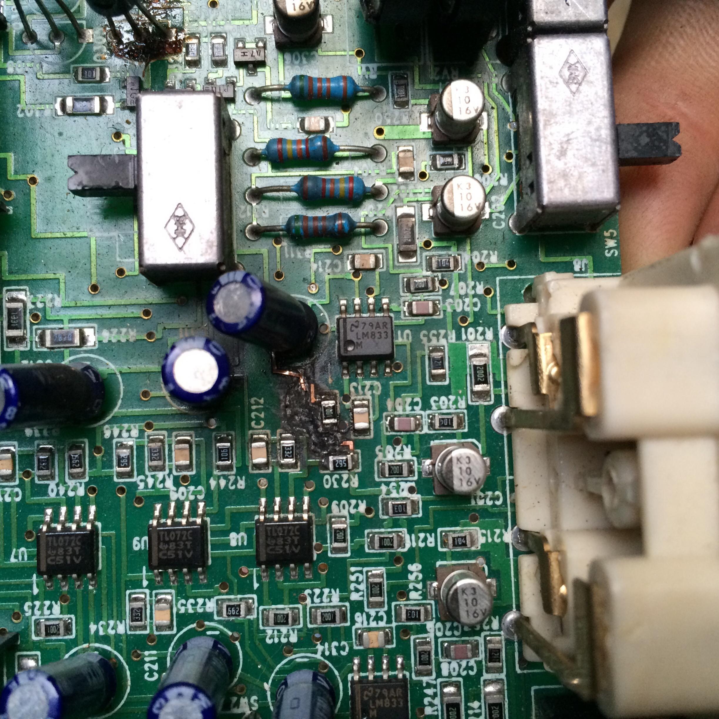

And does that resistor '1002' connect to anything? I bridged the connection. The other channel plays audio now but it's staticky.
