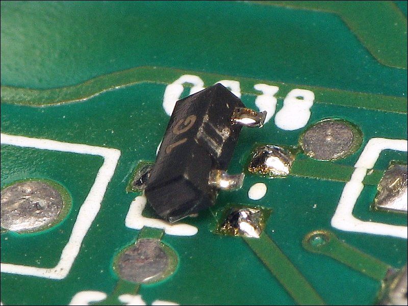

I am a little confused - the -24VDC on the outputs is gone. but i dont know why.
i had a gate resistor R197 which was out of tolerance- a new one measured 9.99 ohms and R197 was 9.6 ohms.
After changing that resistor i still had DC. So i measured around C126, C127 and C128 but i didnt change something.
But DC is gone now. i soldered Q17 back in place and amp is working, now it is possible to adjust the idle current .
Thank you for all your help, its a little frustrating that i dont know why the amp is working again. Can the difference of 0.4 ohms of the gate resistor
cause the problem?
Or a bad solder-connection of the SMD caps?
Best regards!

Those aren't likely to cause the problem. What may have happened was the DC was present but not driven to the speaker terminal. It wasn't pulled down because the output stage was disabled. The test with touching the load was to determine if the DC was driven there or simply present and insignificant.
