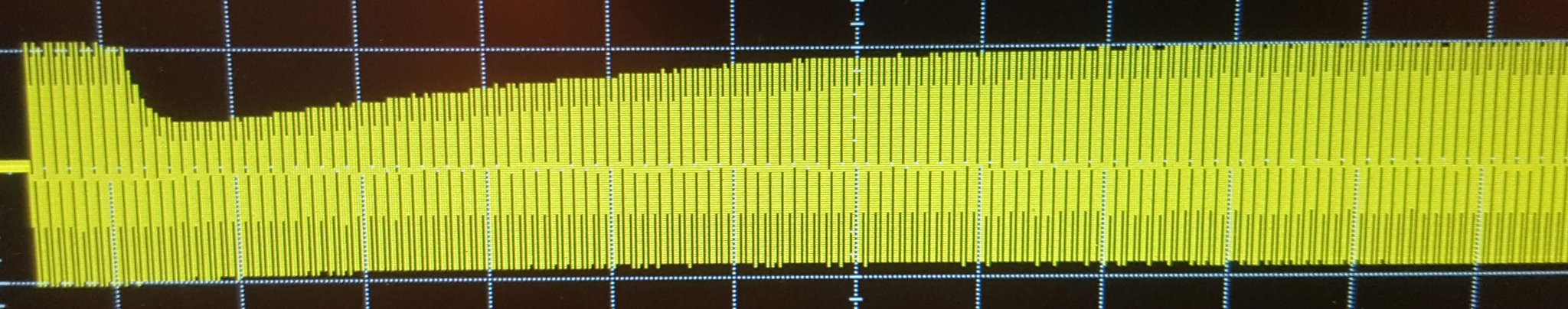

There is another problem with this amp, sometimes it leaves one half of the waveform out on the left channel.
It seems like its ok with a continuous input signal, but if i use a bursted 1kHz signal with 20ms , the firs 3 cycles are ok and then the next cycles drop
extremely to near zero and then start to grow up the longer the burst signal is.
I will take a screenshot of the sope. Its weird because it is not always and with music everything looks ok.
Thanks so far!!
Screenshots:

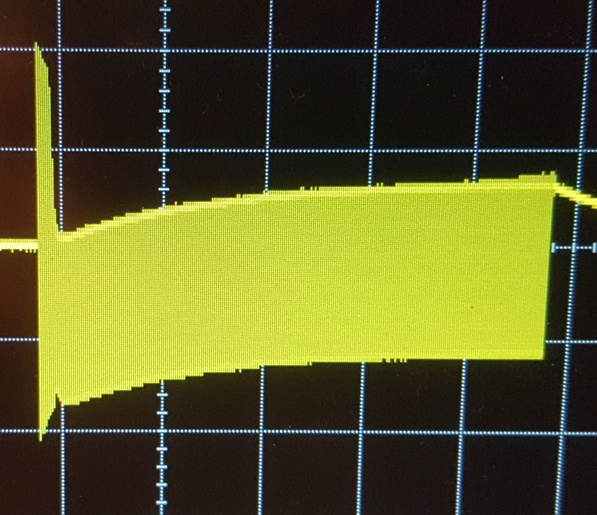

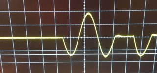

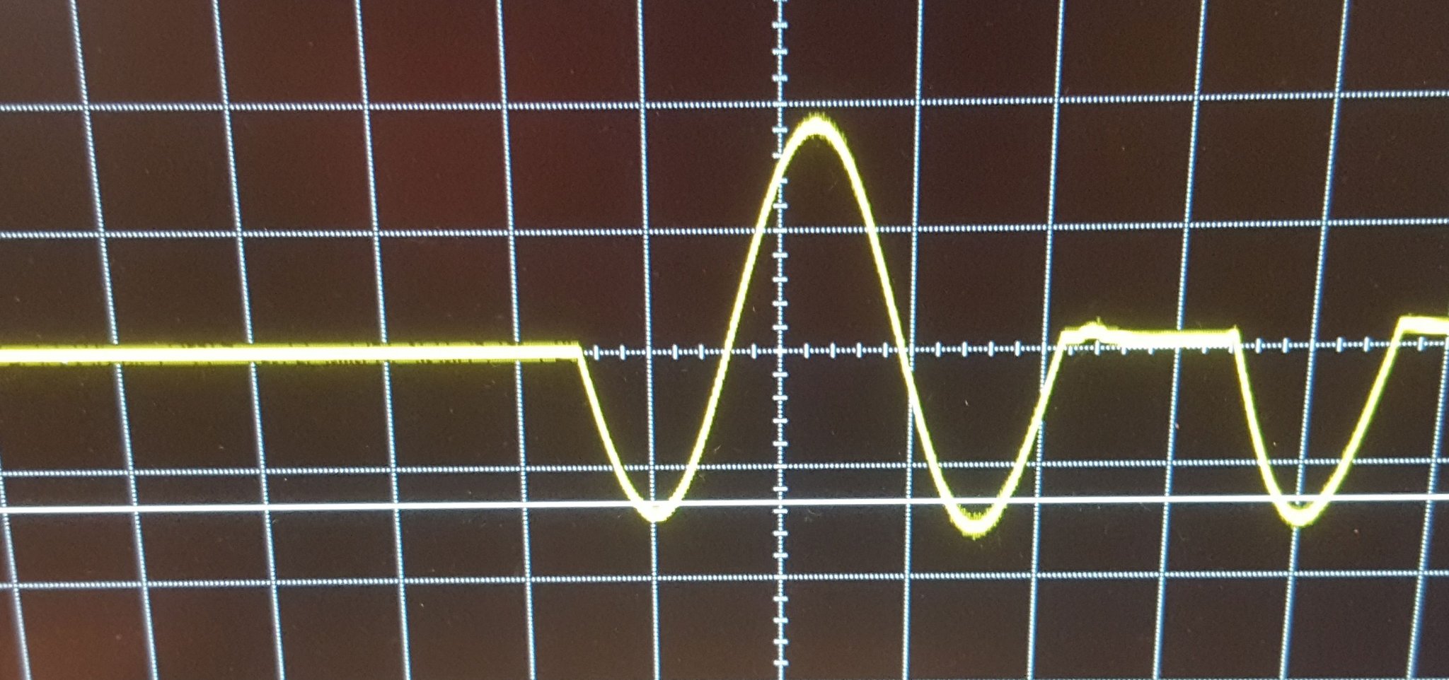

left channel 1 kHz and with a 40Hz burst it gets more worse, last pic is mono 4 ohm 1 kHz burst. left1chburst.jpg40Hzburst.jpgmono4burst.jpg

It seems like the amp needs some time ( around 400ms to produce a full waveform ).
Testing with 40Hz took the amp down much earlier.
Yes!
Desoldering the diode leads to clean cycles. 😀
I guess this diode is leading to a protection circuit?
With a 4 ohm load it sometimes was clean, with a 2 ohm load it was always bad after 4-5 cycles.

Mono 4 ohms i got more than 1000 watts with a short burst and clean cycles
Yes it was confusing.
first i tested one channel 4 ohms and the problem occured on the 200 channel but not always. With 2 ohms per channel it occured always.
After that i made a test mono 4 ohms ( still thinking 300 channel is ok ) and i lifted diodes one at a time and thought after desoldering D205 everything was ok.
I resoldered D202 and D302 , everthing was fine, I resoldered D305 and the cycles were still gointg down. So i doublechecked it and i have to leave D205
and D305 out of the circuit to get clean cycles.

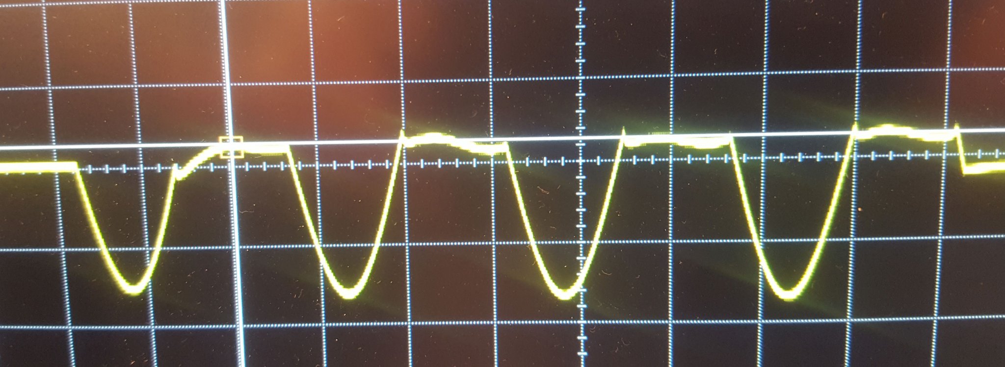

I resoldered D305 and this happens with a 4 cycle 40Hz burst
I think i have to desolder all 0.1ohm resistors and test them with constant current and measure the voltage across them to get more accurate readings.
Its not possible with the Fluke to get good readings 🙁

If i put a 1kHz burst with 20 cycles into the amp the first 4 cycles are ok and the rest is down, same like in last pic of #42.
This is with one burst in 1 second.
If i send 5 bursts per second, then i get 10 clean cycles and the rest is down.
If i send 15 bursts per second i get all 20 cycles clean.
Its crazy , i never faced such a behavior.
If i start continuous test immediately with a high level, it leaves the waveform out.
If i slowly start with low level and increase gain to the clipping point, everything is fine.
