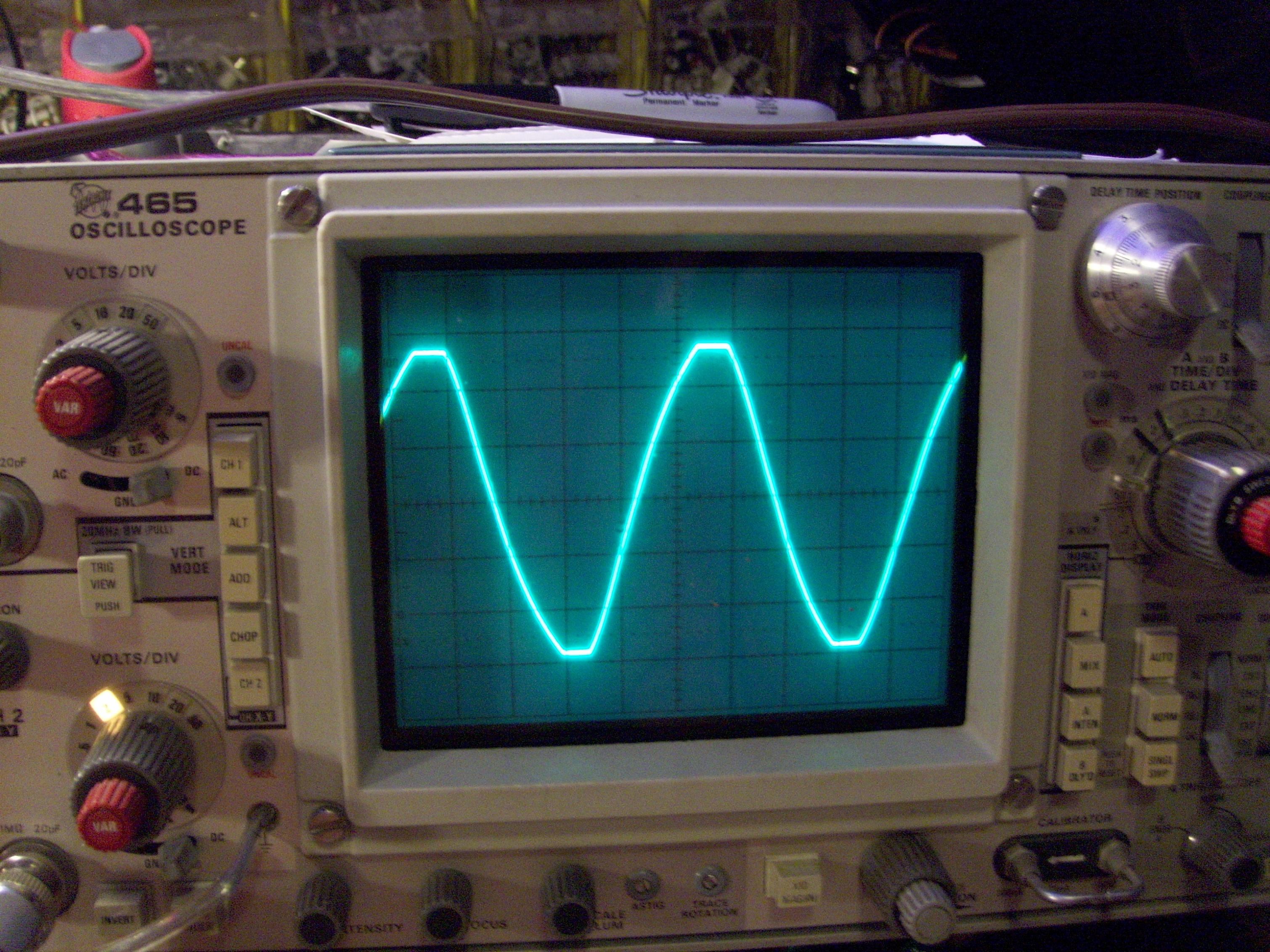

Just a 100Hz signal no load.

Leave it directly connected to the supply but connect it to a speaker or dummy load and post a photo of the defective channel driven to clipping.

Im sorry Perry I should have been more specific, all parts are in the circuit except D202.
The load signal you are seeing is with D202 removed.

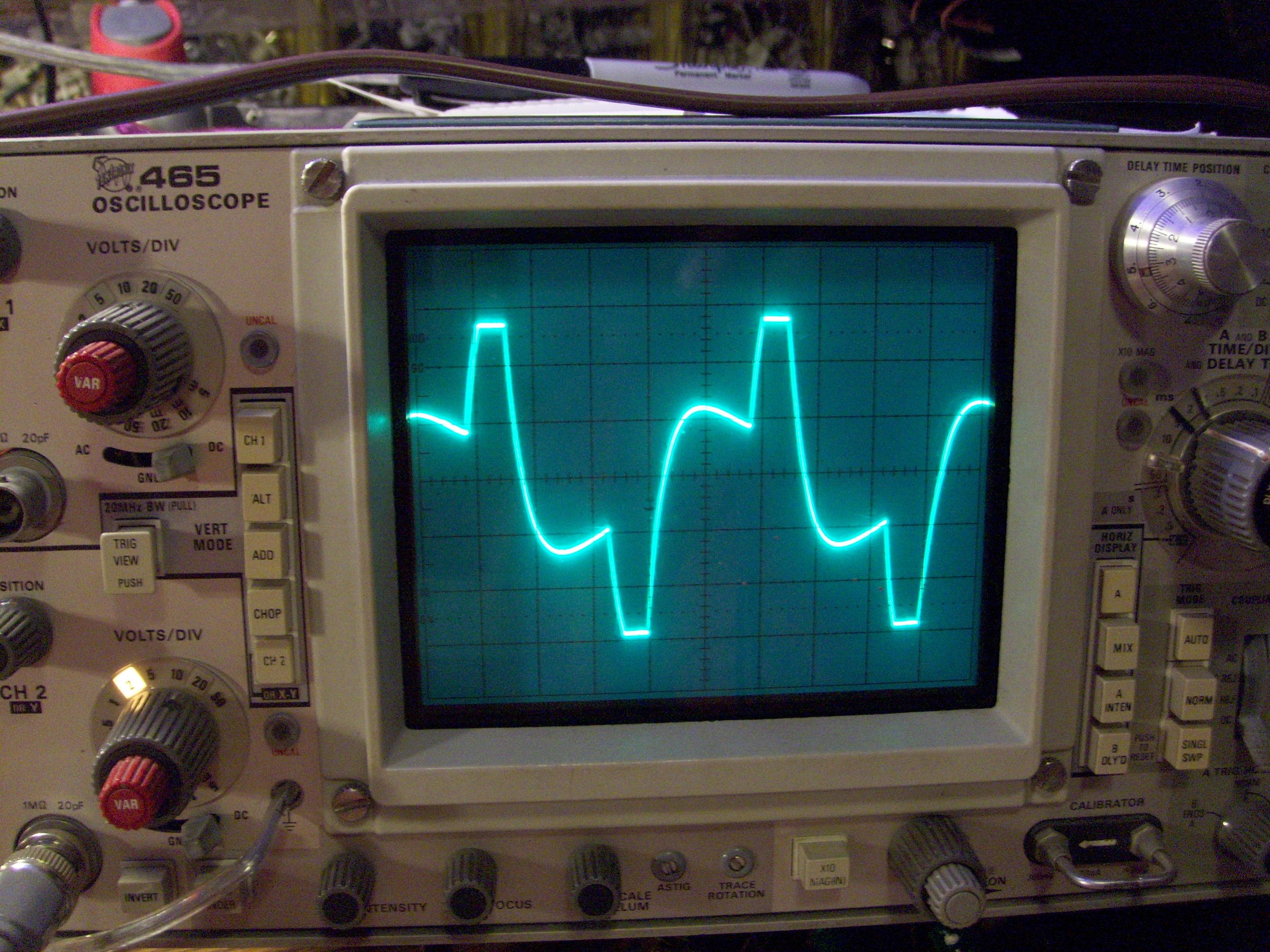

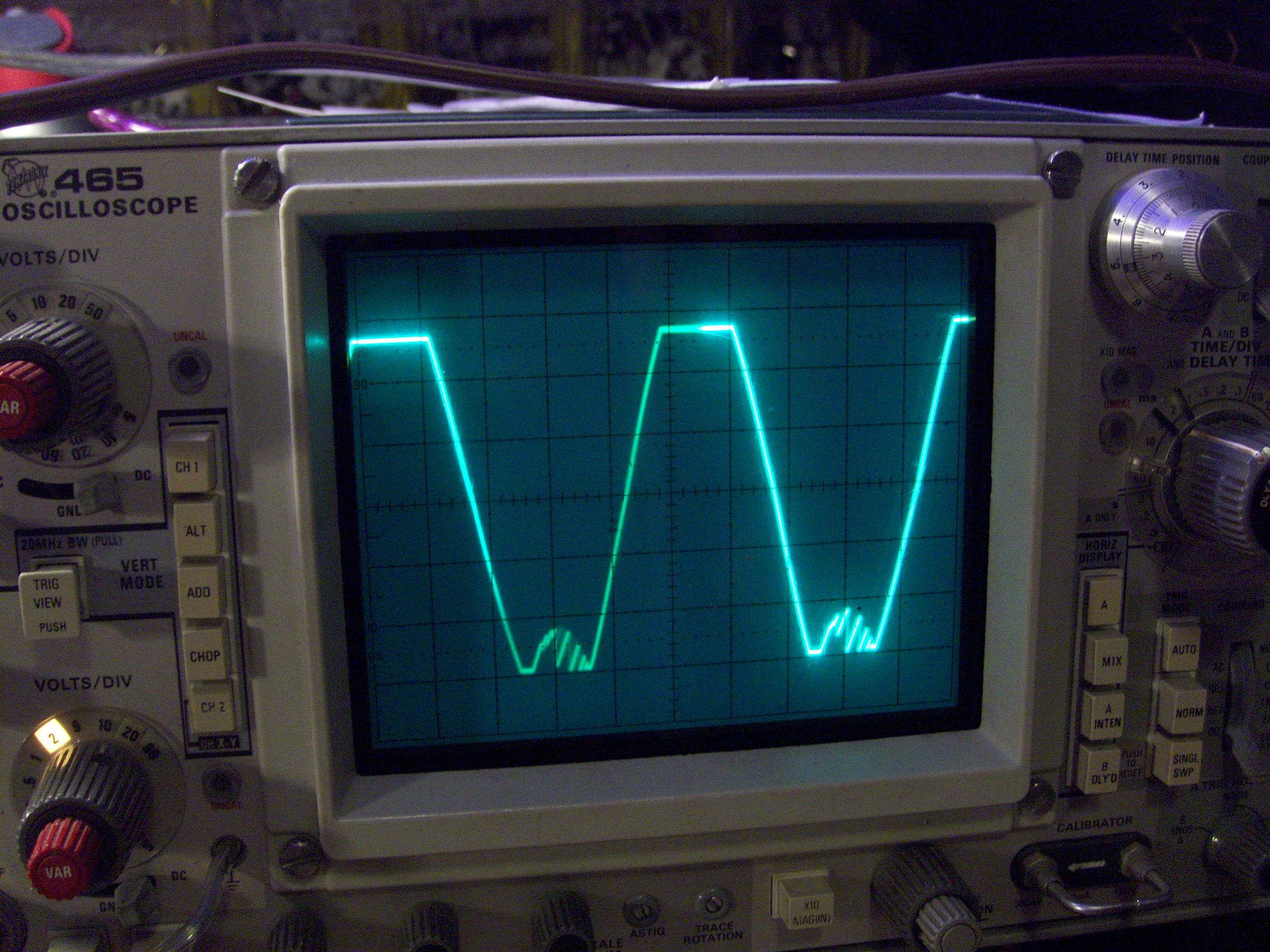

Try this with both a higher and lower frequency signal. Does the distortion always happen precisely the the bottom of the waveform?
Is there possibly a small ceramic capacitor near the components that were replaced that was damaged?
Amp connected directly to supply, all parts except D202 in circuit, all 3 jumpers installed, 8 ohm load, scope setting 2ms/20vd.
1st pic: high frequency
2nd pic: low frequency
It seems to be more sensitive to the higher frequency.
The lower frequency still kinda looks funny at full volume.
