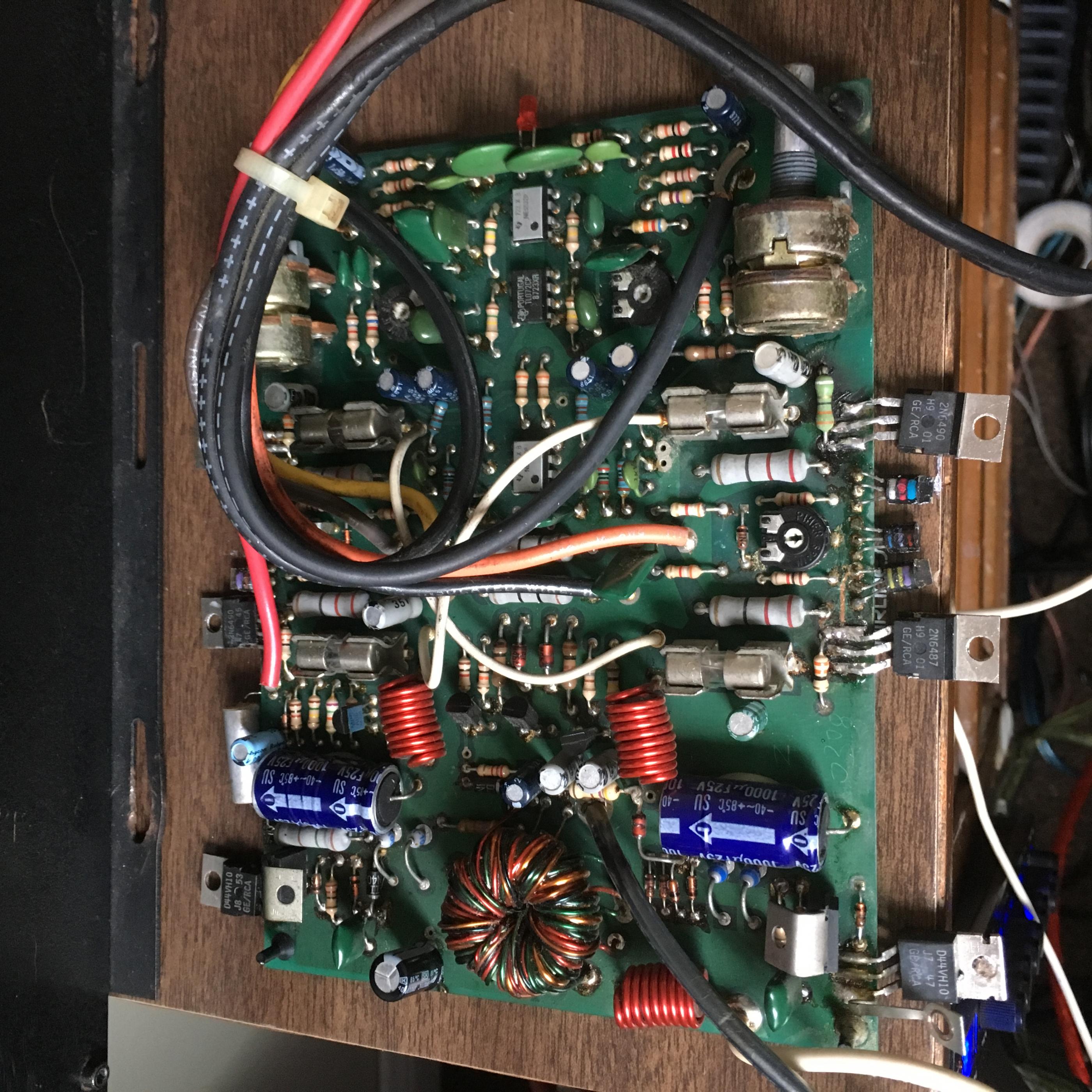

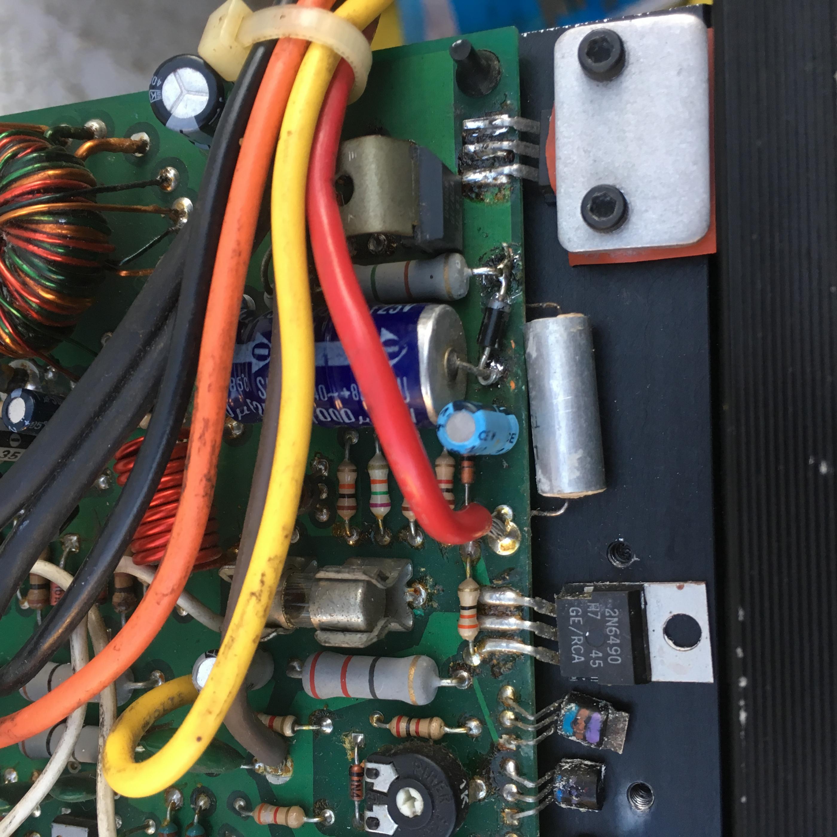

Hey guys I have a Rockford fosgate punch 75 that I purchased to use if I can get it working. The problem is no power non of the power supply transistors appear to be shorted. All I get is a slight buzzing sound from the transformer. There is 28.82vdc at the speaker fuses and when the red led is on (even without remote applied) there's 34vdc present. What should I start on this amp? Amp produces no audio either.
