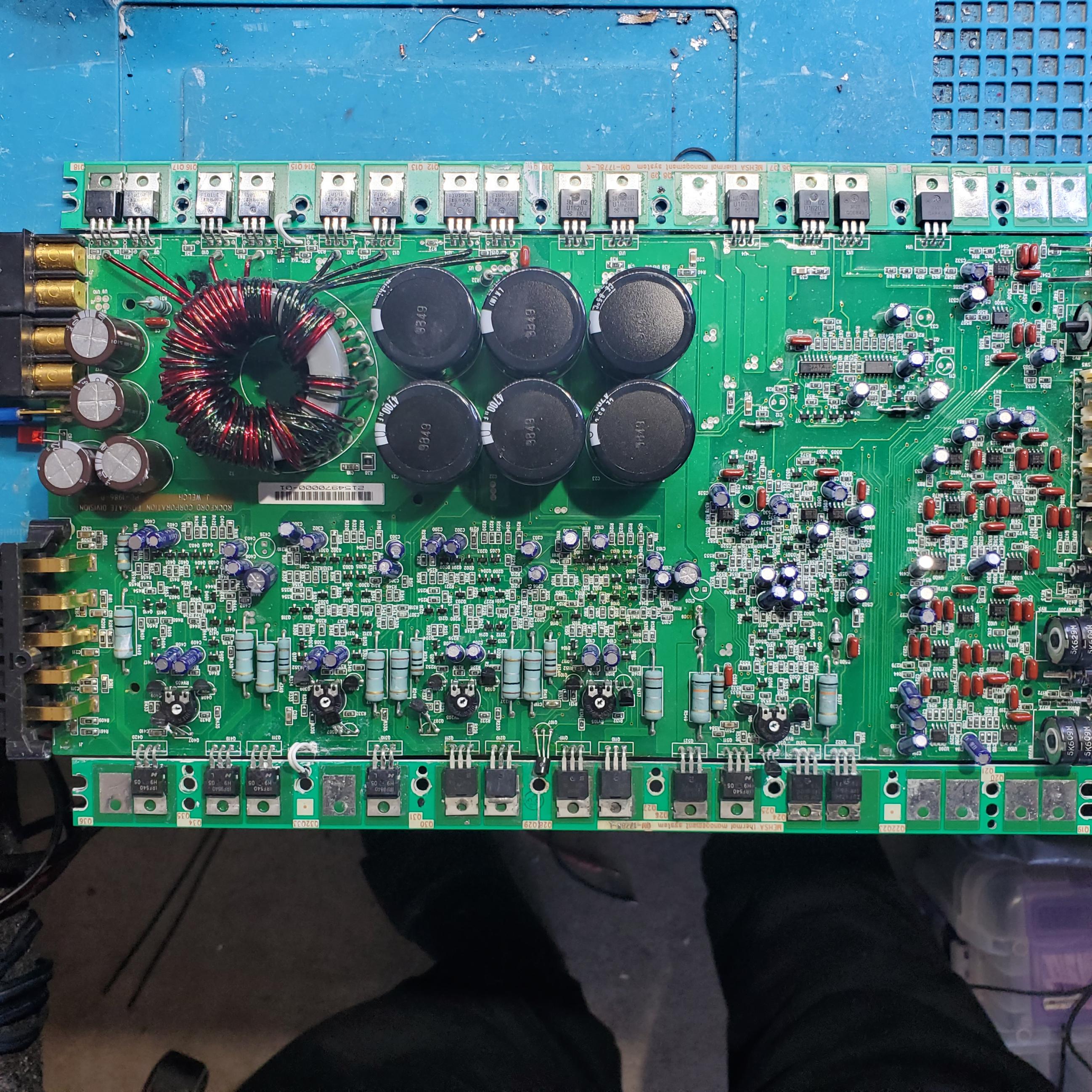

I have a Rockford that despite changing the n and P channel transistors and all the mmba06-56 transistors and the 5d diode I have the rail voltage present on the speaker terminal.
Does lifting D102 and D104 make a difference?
If not, leave those out of the circuit and lift Q106 and 106. Does that eliminate the DC?
Yes lifting just D102&D104 transistors eliminates the DC. It now has the same DC present as the other channels
