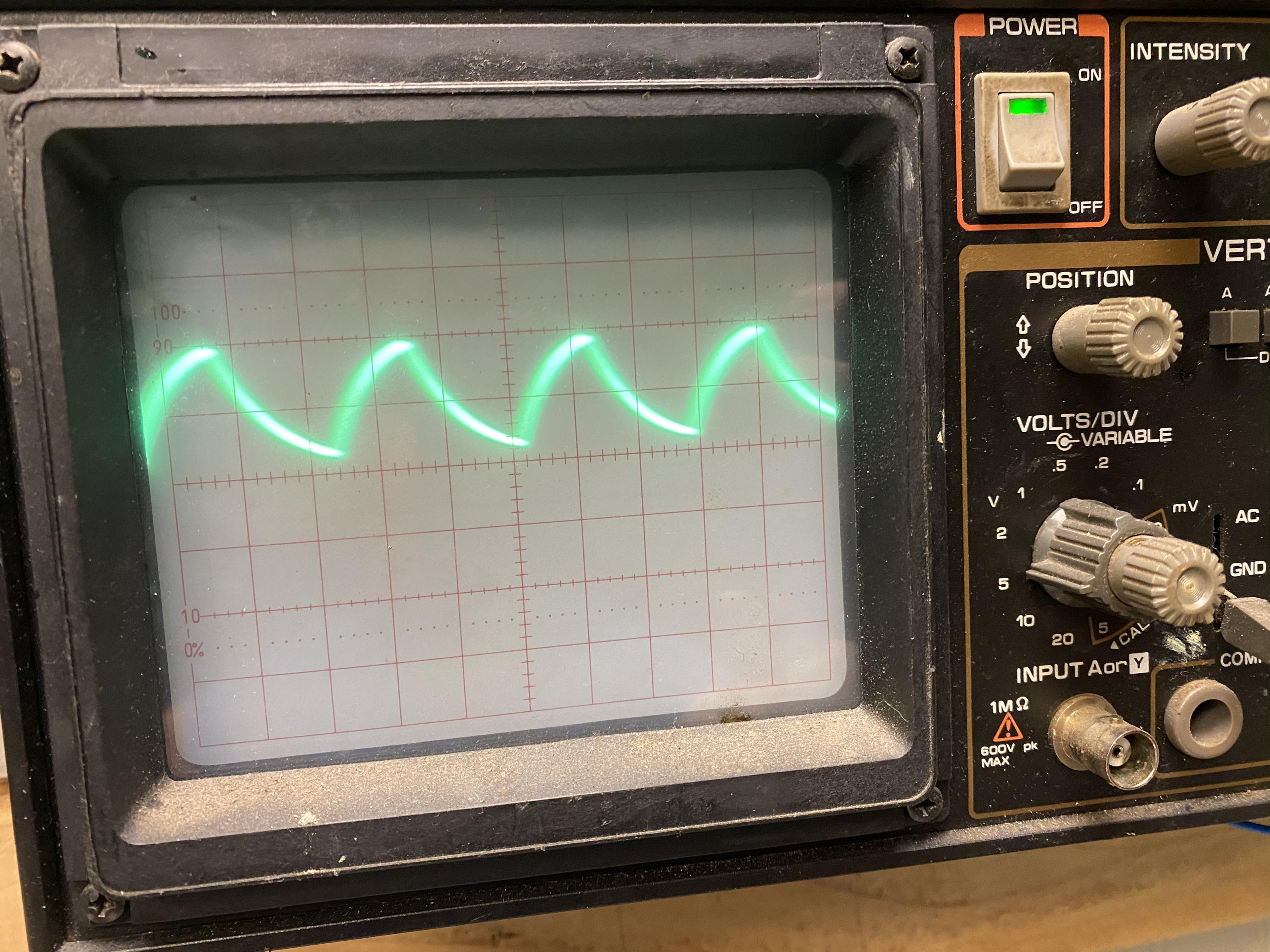

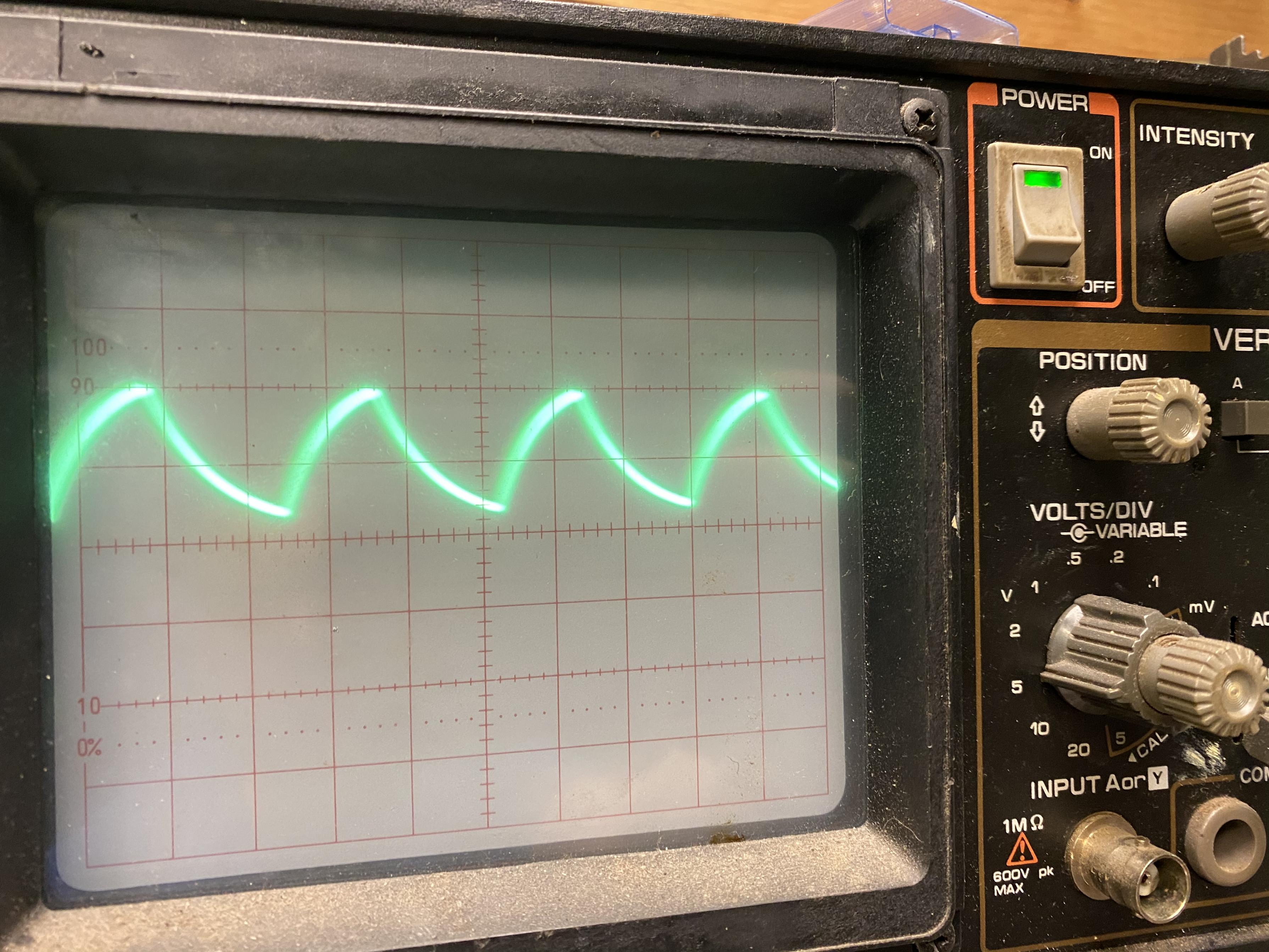

I dont think it’s the channel causing the issue now .
I pulled the outputs from that channel and amp still draws 40 amps of current .
With the fet locations loaded with a 0.1 if cap here is what I get for drive signals .
Do these appear to look good ?

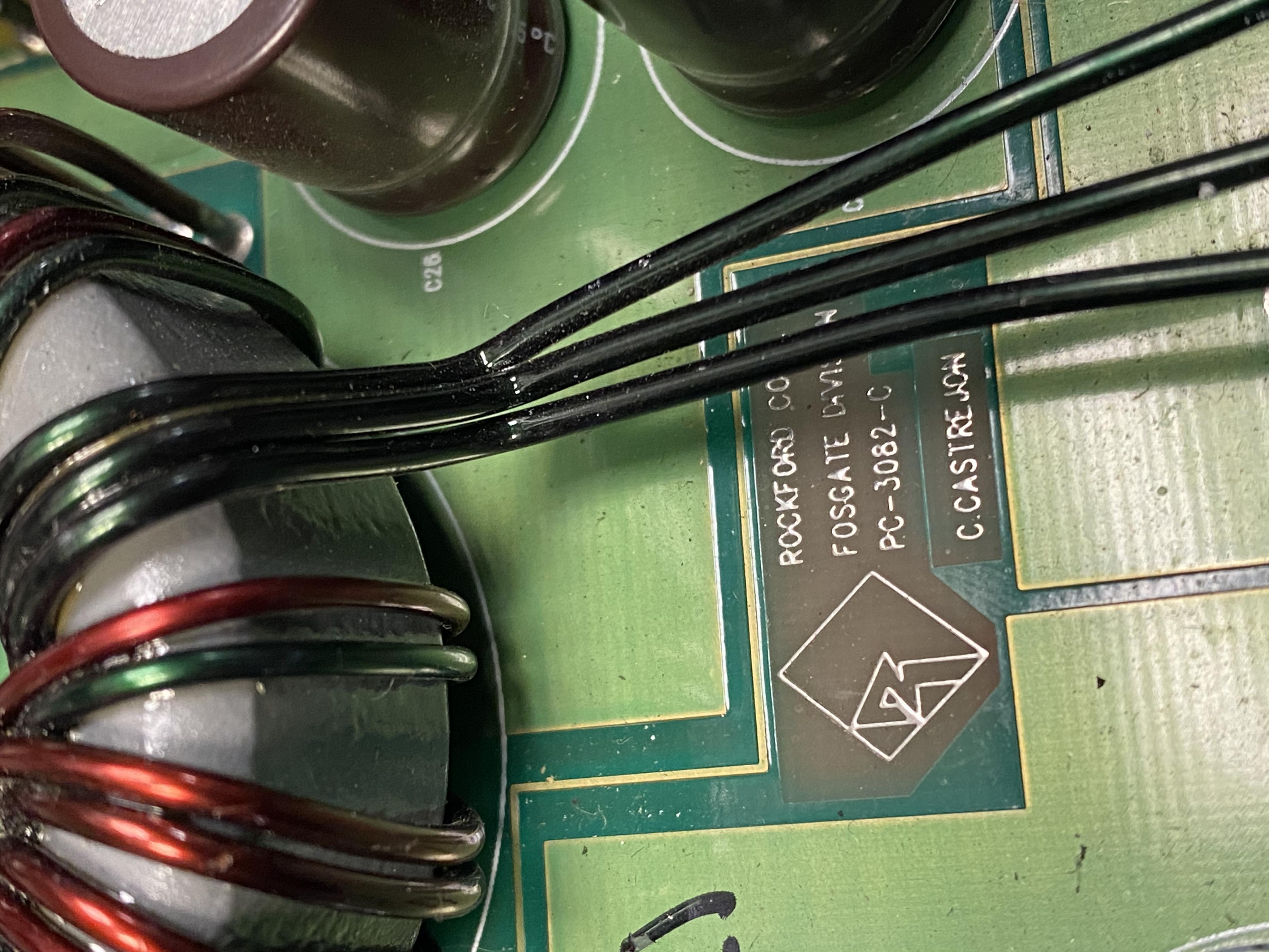

Also since someone tried repairing this them selfs .
Wondering if the regulators and rectifiers are in the correct locations ?

I replaced the power supply fets , regulators and rectifiers
The 317 has positive voltage on leg 3
337 has negative voltage on middle pin
Checked all of the outputs out of circuit and all test fine .
540’s are on negative rail 9540’s on positive rail
Amp still draws 40 amps of current when applying remote voltage
I did some more checking
If I leave the rectifiers in when the amp draws excessive current the outputs in both channels get hot within secs
If I remove the rectifiers the amp will not draw excessive current
If I leave the negative rectifier out the amp will power up normally
