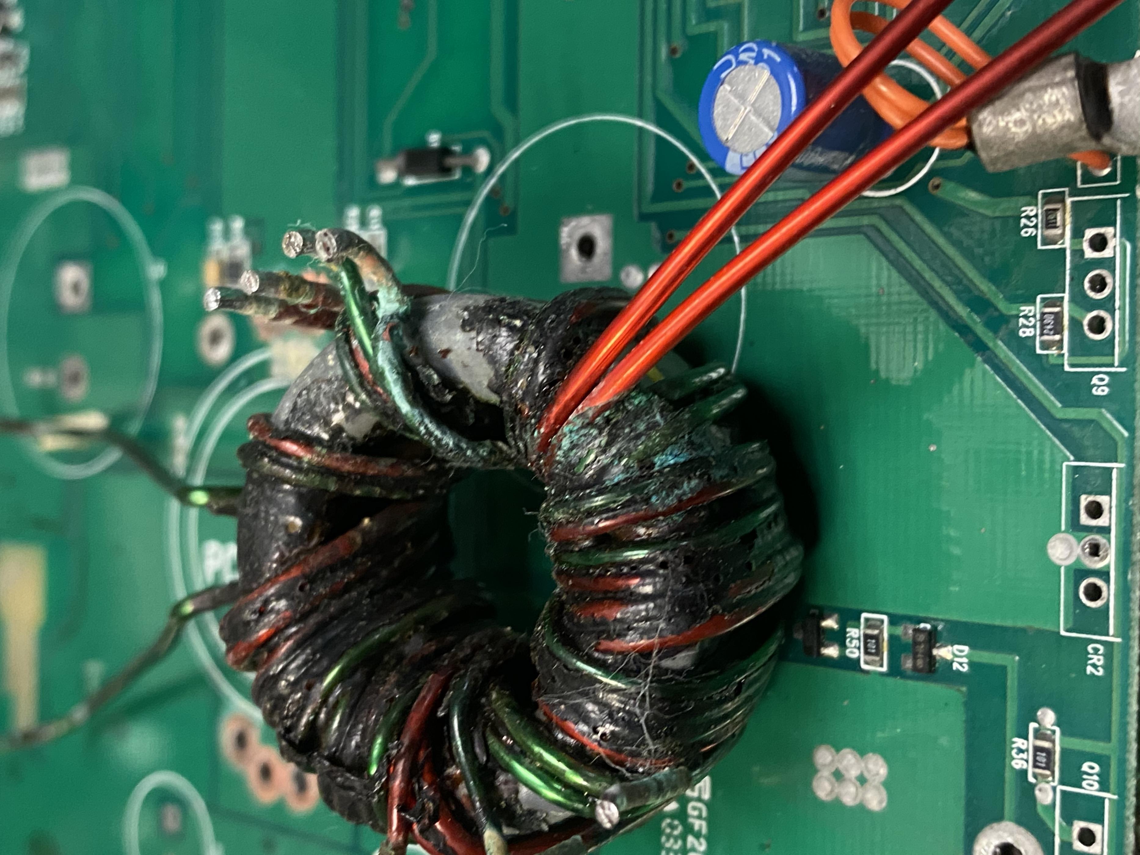

C caraudioguy2100 Member Joined 2010 2021-03-01 11:38 pm #1 2021-03-01 11:38 pm #1 Wondering if this was done by the factory or is a manufacturer defect? The pot is for the crossover frequency Attachments 52066078-BC6A-4186-9B37-846C7EDB9920.jpg 955.8 KB · Views: 87 P Perry Babin Member Joined 2003 bcae1.com 2021-03-01 11:43 pm #2 2021-03-01 11:43 pm #2 defect C caraudioguy2100 Member Joined 2010 2021-03-02 12:02 am #3 2021-03-02 12:02 am #3 Also what’s the best thing to use to clean the corrosion off the transformer ? Attachments 712F1881-9D5B-4EFC-B3E2-E1D9ECA77C12.jpg 979.3 KB · Views: 90 F46ADE99-BC21-4D16-8863-89964A135224.jpg 906.4 KB · Views: 79 P Perry Babin Member Joined 2003 bcae1.com 2021-03-02 2:58 am #4 2021-03-02 2:58 am #4 I'd use a toothbrush and alcohol of acetone. Did a capacitor leak? C caraudioguy2100 Member Joined 2010 2021-03-02 7:24 am #5 2021-03-02 7:24 am #5 No I pulled the caps to make sure they weren’t leaking . The amp had a lot of corrosion so wanted to make sure the caps weren’t leaking P Perry Babin Member Joined 2003 bcae1.com 2021-03-02 7:29 am #6 2021-03-02 7:29 am #6 Double-check any vias where there was corrosion. You must log in or register to reply here. Share: Facebook X (Twitter) LinkedIn Reddit Pinterest Tumblr WhatsApp Email Link
