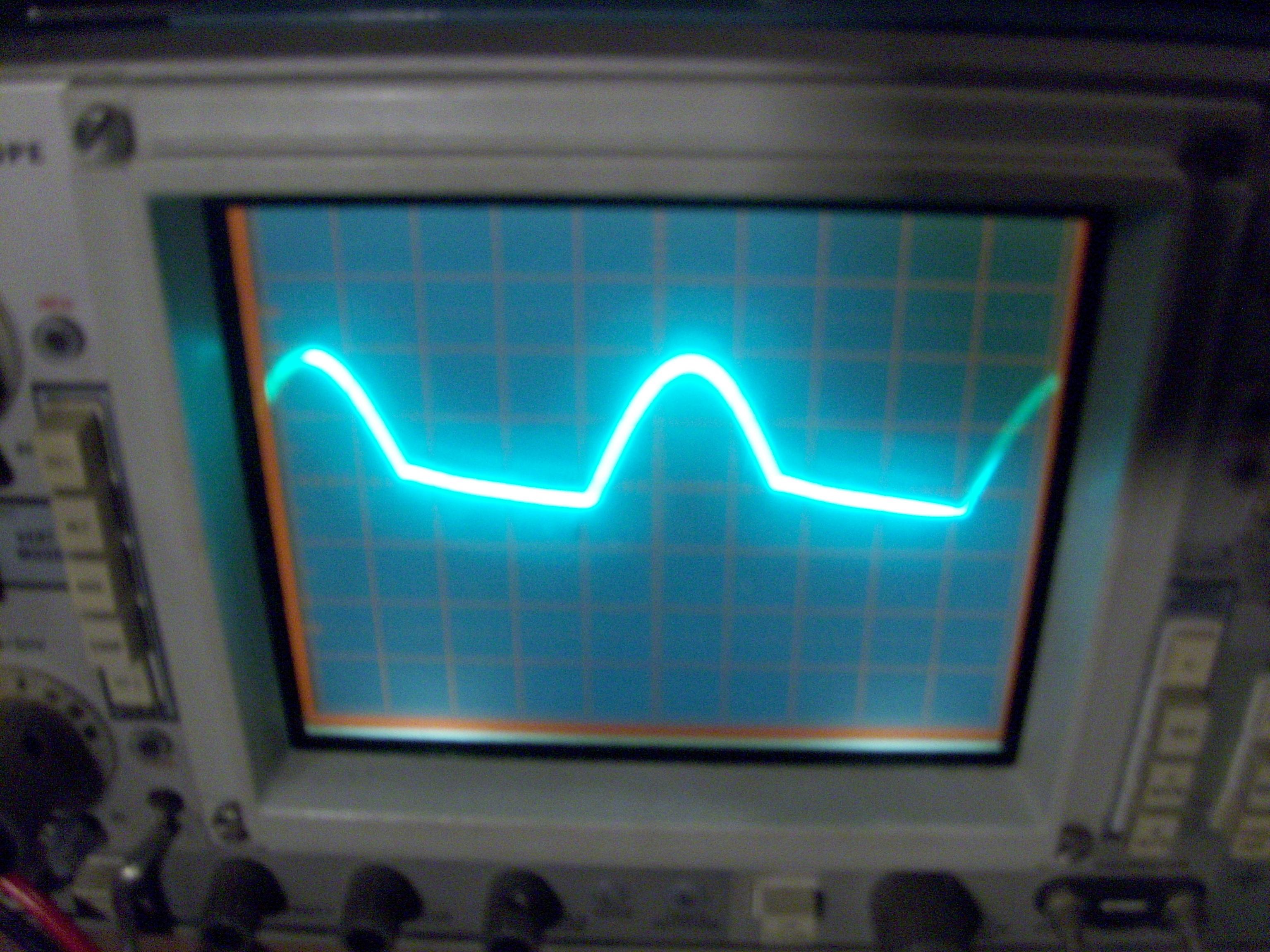

Im still having trouble. I just dont understand how the output can look clean on the scope but be distorted through the speaker. The only time the signal looks funny is well into hard clipping.
I have been testing various components vs working channels and still no luck yet.
Are you saying that if you drive a 100HZ sine wave into the amp with a speaker or dummy load connected to the speaker terminals that the signal looks perfectly clean right up to clipping but it sounds distorted?
No... without a load or speaker hooked up driving a 100hz sine wave into the amp with the scope set at 10vol/div 2 ms the amp has a clean signal on the scope up until hard clipping then it looks distorted.
If you hook up a speaker to the amp and play a musical CD the sound is distorted and the higher you turn the volume the worse it gets.
I put my meter on the bridging terminal of that channel and as the volume is increased DC begins to appear and increases with the volume. There is no DC on the bridging terminal at an idle.

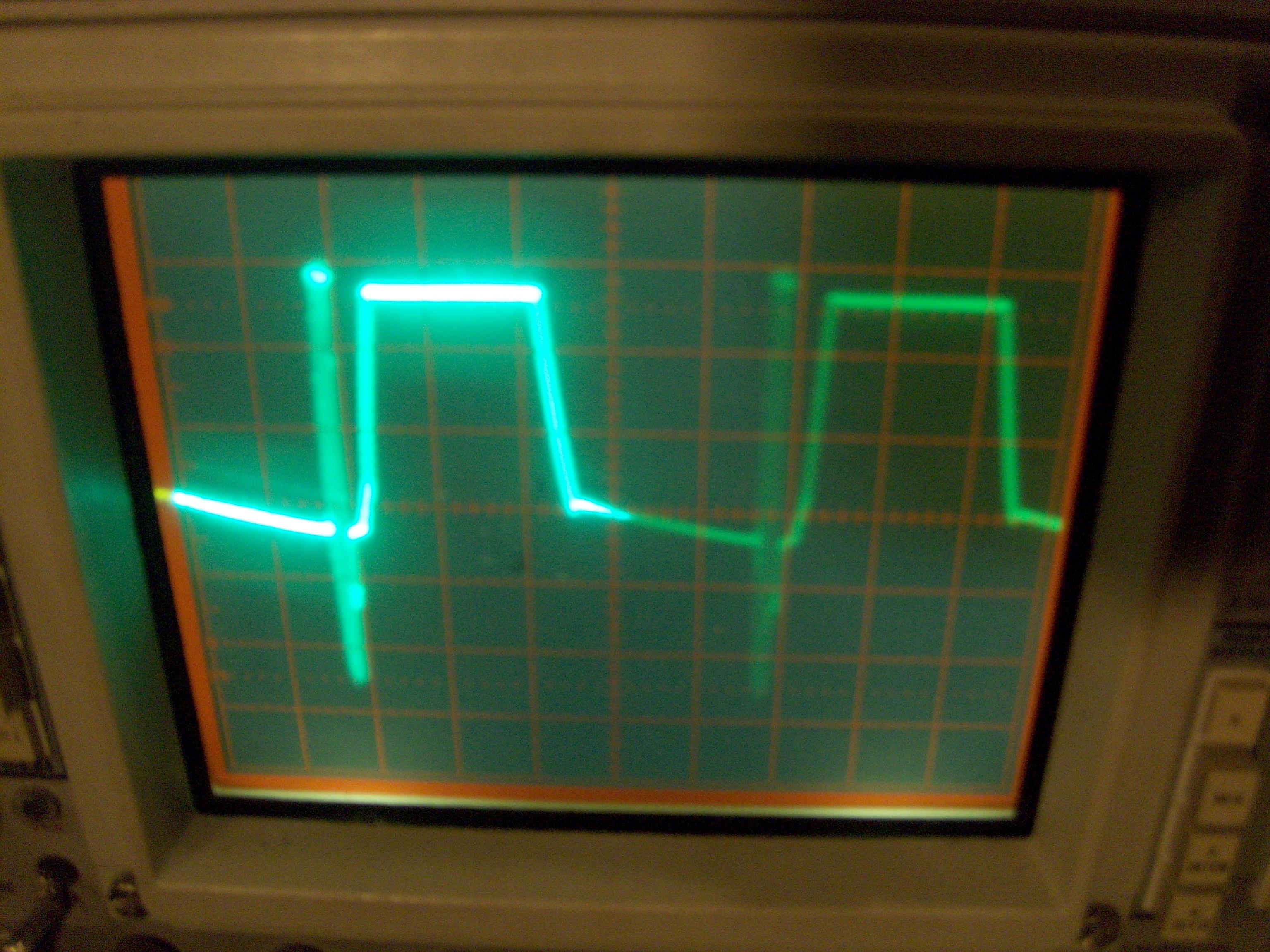

With a load the signal is not clean. I drove a 100Hz sinewave into the amp scope setting were 10vol/div and 2 ms.
First photo is at low volume, second photo is clipping at half volume.

The protection circuit transistors monitor the voltage across the 0.1 ohm source resistors and have one that clamps the drive signal to the outputs. When the outputs fail (and especially when the 0.1 ohm resistors fail) the protection circuit transistors fail.
Lifting the diodes (high or low side, depending on whether the top or bottom is clipped) disables the protection circuit to allow you to determine if there is a problem with the protection circuit or the audio circuit.
Does any other channel have output transistors from the same batch as channel 3?
I found 2 defective transistors, Q316 and Q317. I replaced them and the amp will bias fine now on the 3 series channel. Why was the sound not distorted on the 3 series channel like on the 4 series with defective protection transistors????
