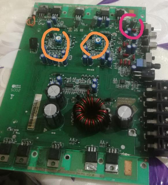

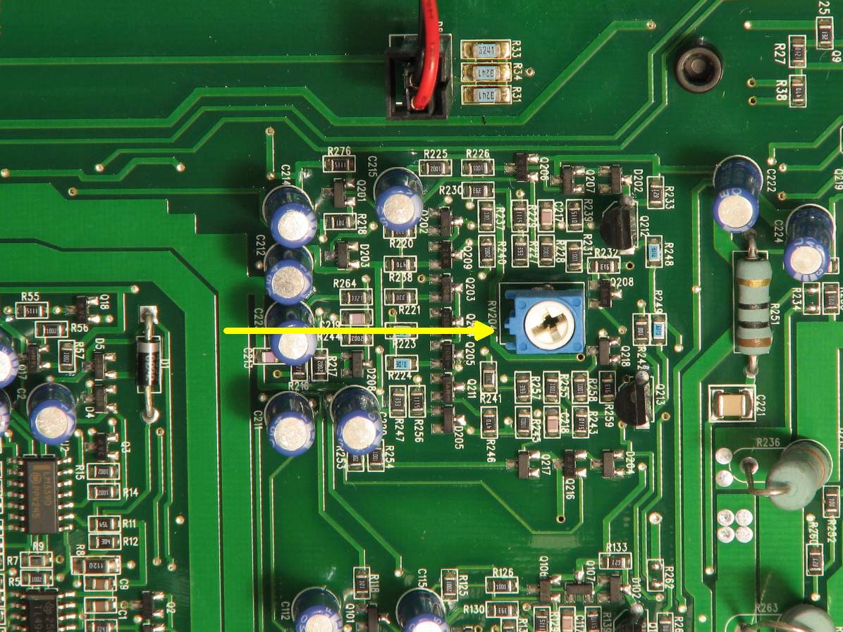

The left channel is working now with the MOSFETs of the right channel is taken off the board. I think I'm going to adjust the bias of the right channel referring to the bias of the left channel based on resistance.
the bias of the left channel (working channel) is now in the middle of the way and its resistance is 1k ohms which is also half of the value of resistance indicated in the schematic.
Am I on the right path doing so before fitting the new MOSFETs?

If that gets the bias set right, you should buy a lottery ticket.
Changing any components, and especially the output transistors with non-matching replacements, requires a different bias setting (compared to the other channel).

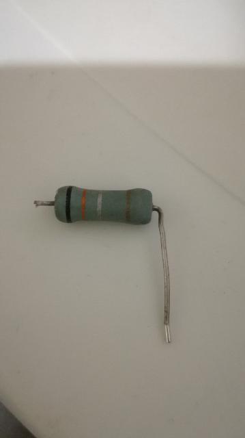

If the source resistors opened (value after heating well higher than 0.03 ohms). there may have been damage to the protection circuit. Those components need to be checked before you install the outputs. To check the resistors, you may need to remove the resistors that you just installed. The resistors that often burn are connected to those low value resistors and will skew the readings of the small resistors.

I didn't replace any resistors, by the way. I only measure them out of the circuit board and refitted them. It was hard to read those 0.03 ohms as you said.

The protection circuits for over-current are localized in these amps. I've highlighted them for one channel. The other channel is the same. The two resistors across the 0.03 ohm resistors are the first you need to check.
