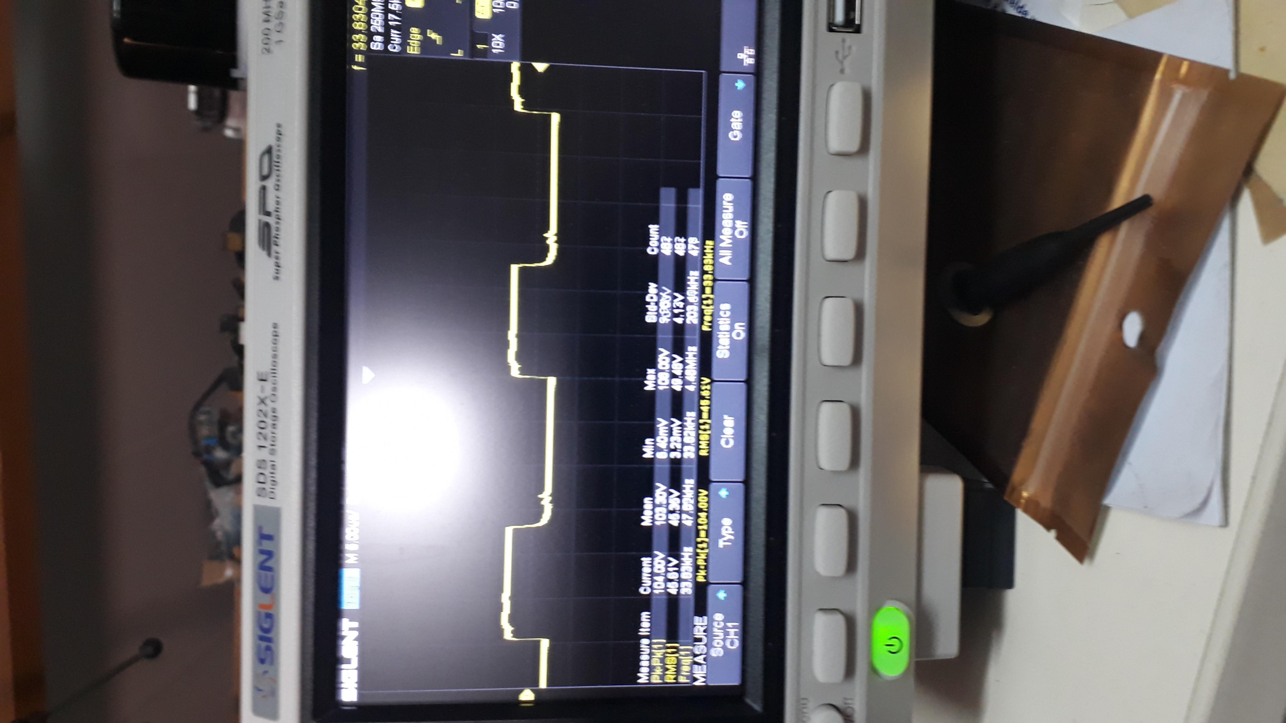

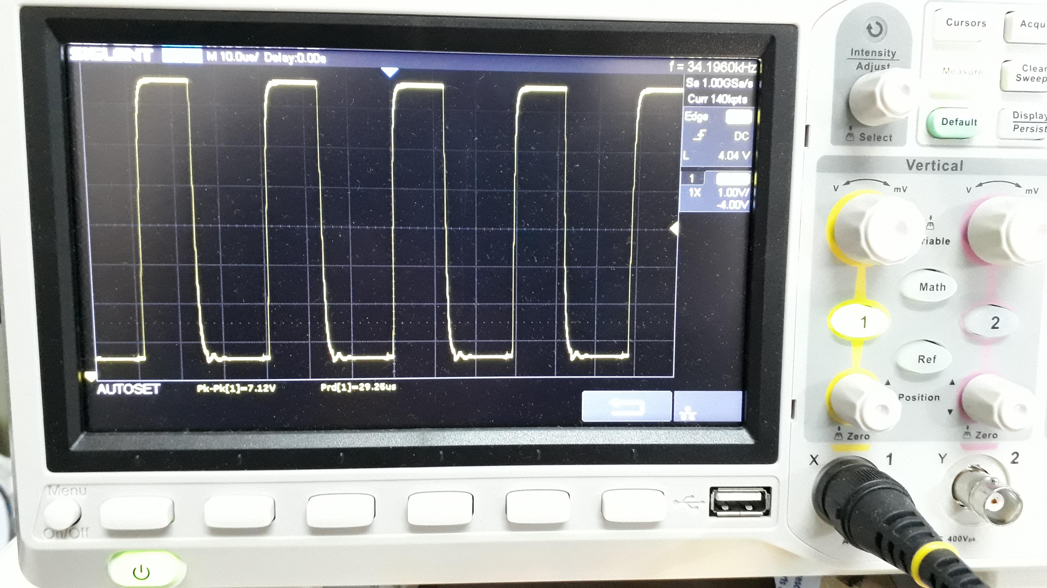

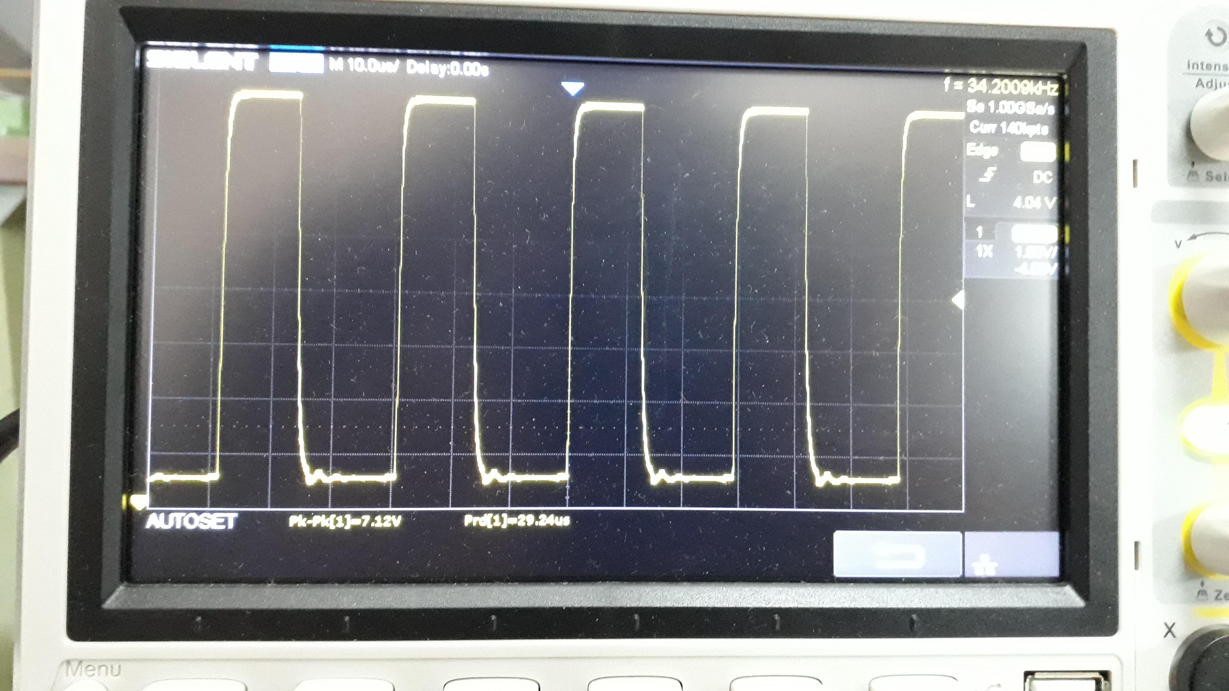

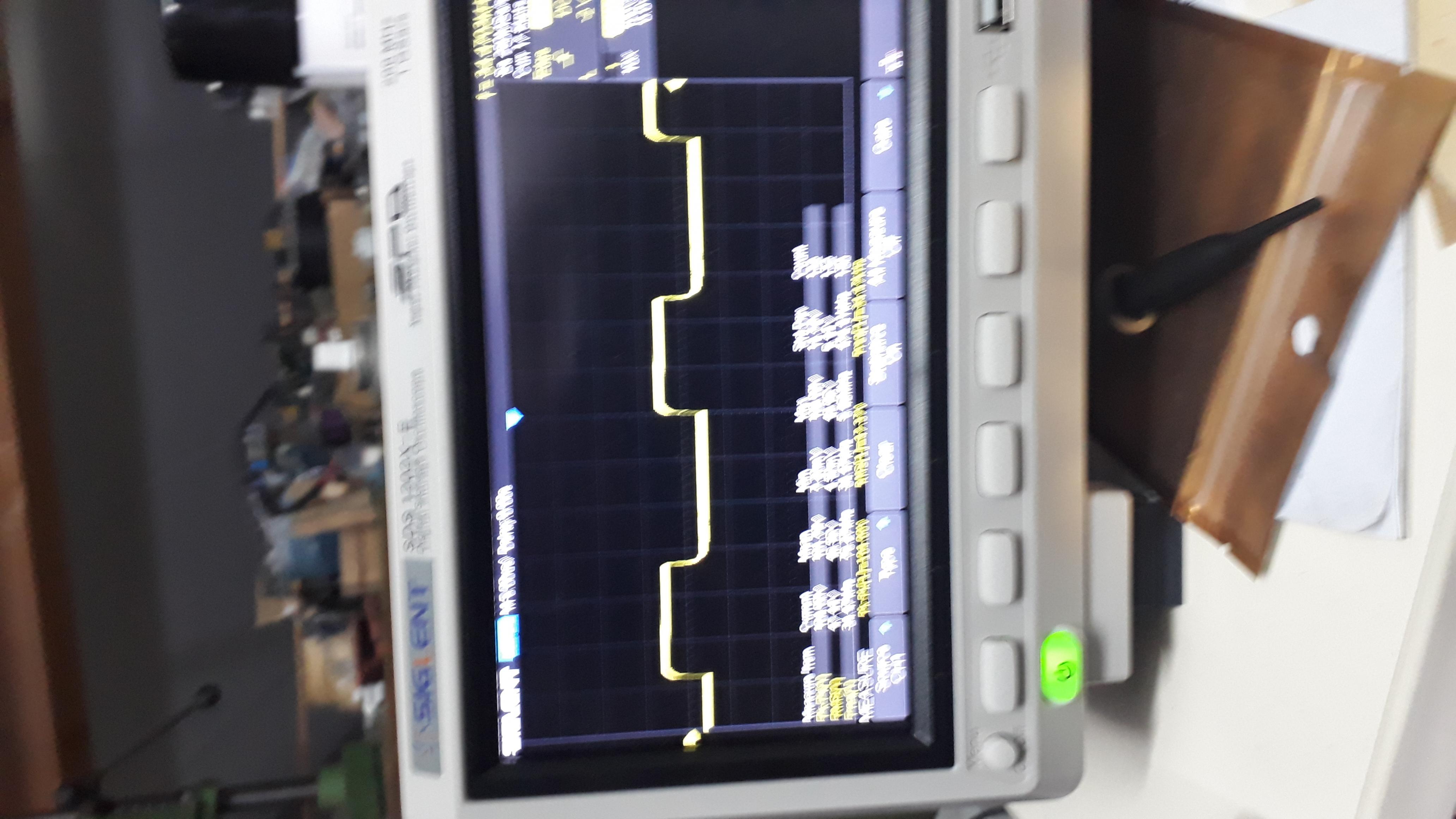

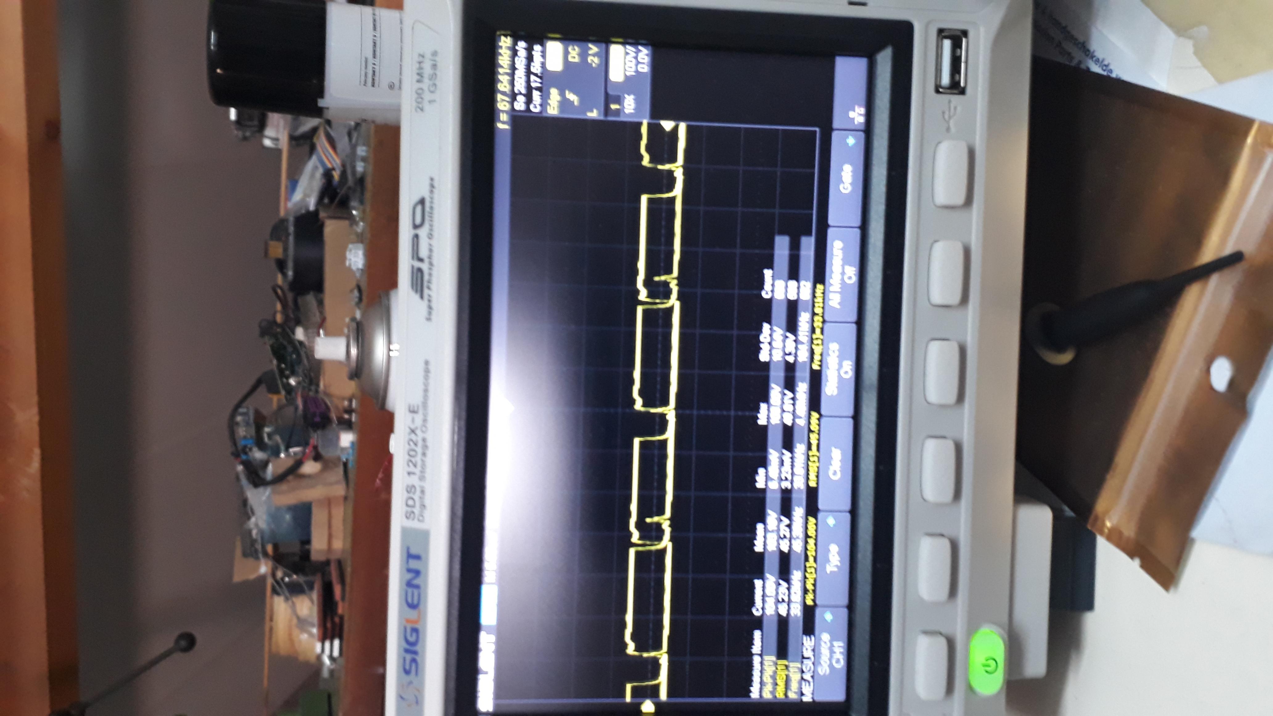

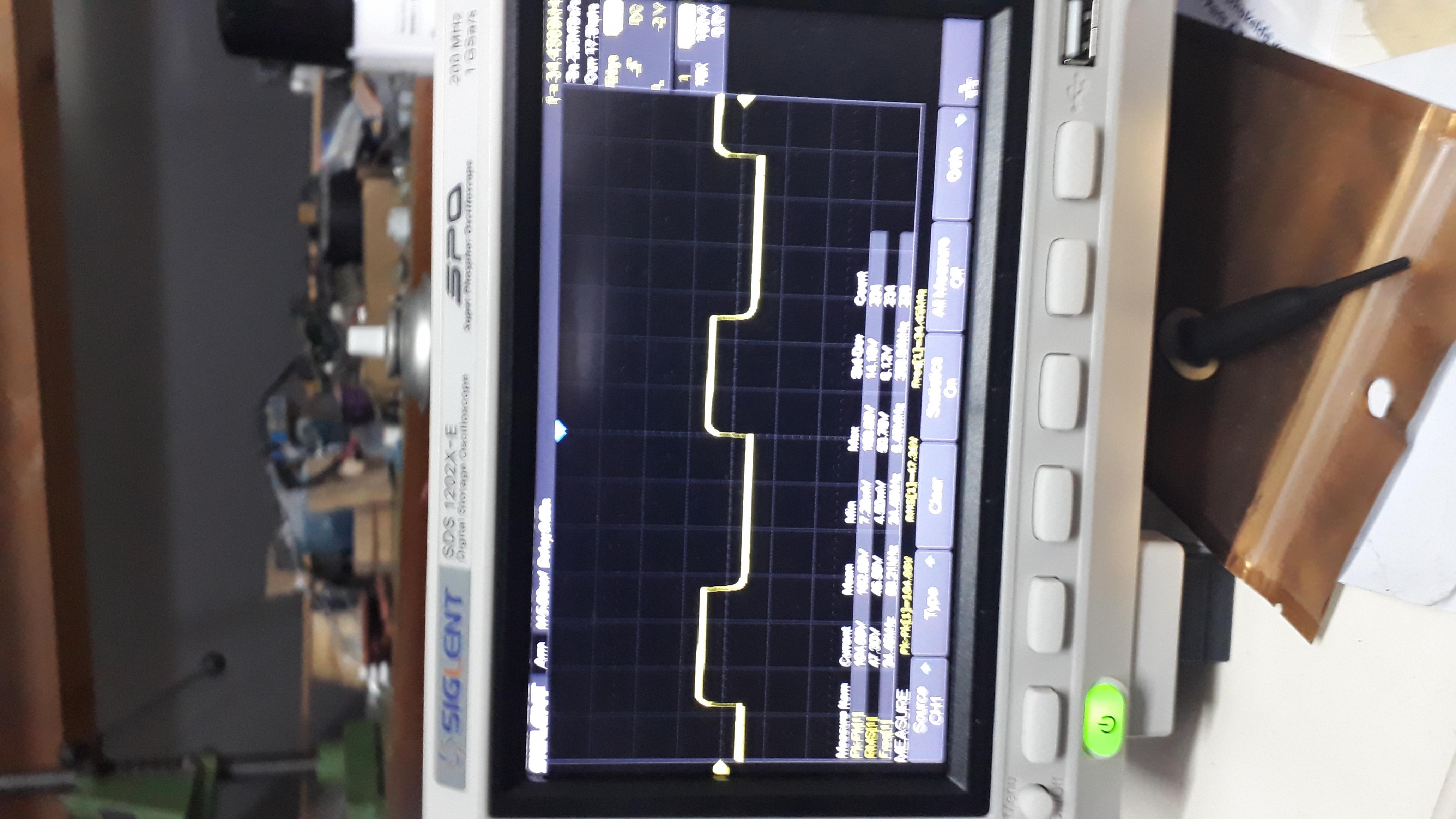

Unfortunatly Rockford could not help me with the right schematic. I replaced the powersupply fets and the drive ic tl494 and the drive transistor behind the ic and its still drawing to much current and the waveform on the output pin 16 of the tl494 is bad. Can someone help me with the direction to surge in.
File off pin 15 and 16 attached
Best regards Vosje.

Those look OK (could be clearer if you were to take the time). The problem may be further down the line. Post the gate waveforms (scope grounded to source) with no B+.
