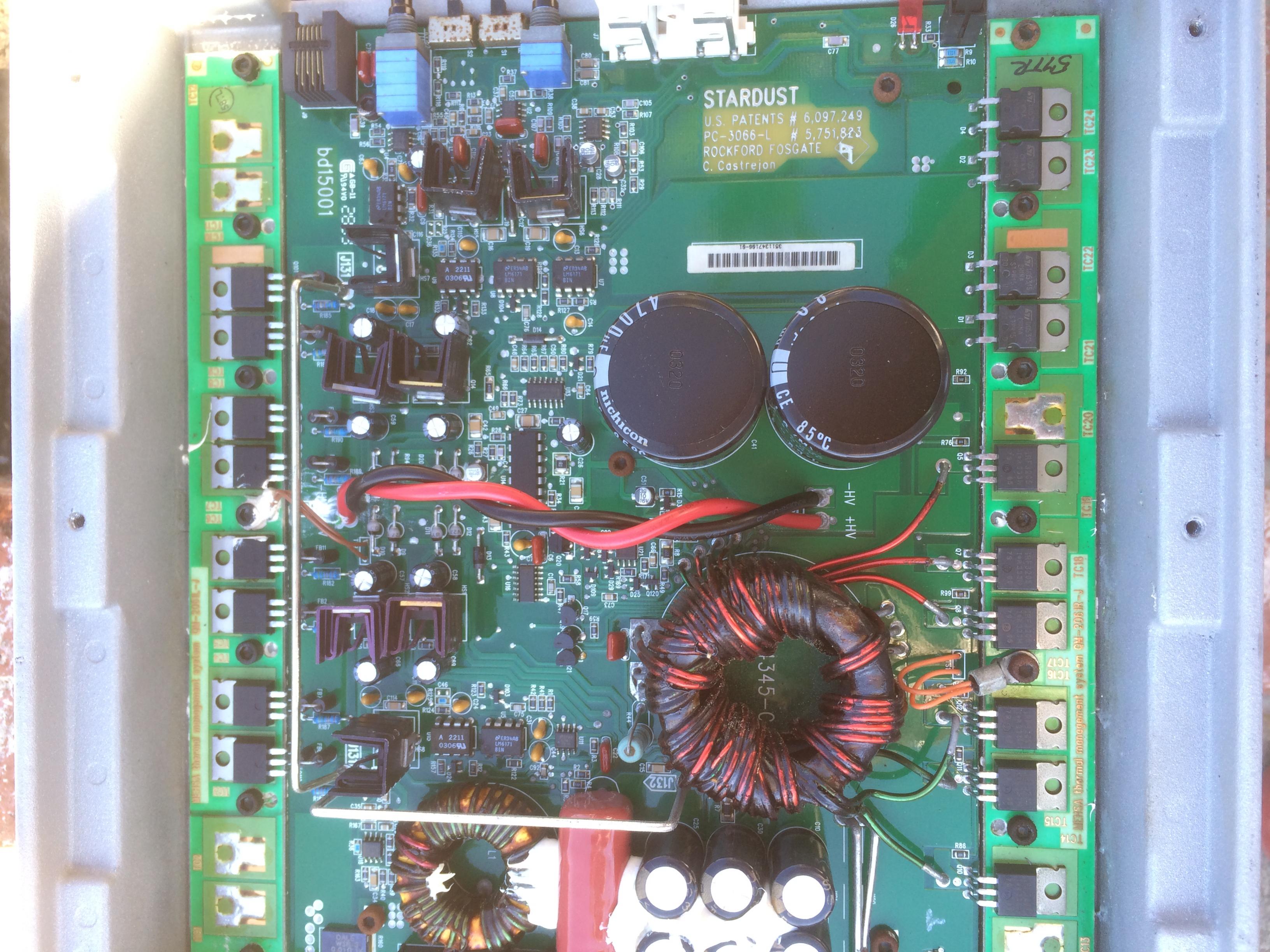

Hey guys purchased a power 501bd used from craigslist for $40 only got it because it came with the bass knob and end caps the guy said he didn't know if it worked or not I still went ahead and got it to good of a deal. Anyway on to the amp it's in protection powers on fine. No shorts in the outputs. Where do I begin my search? Thanks guys!
U21 was defective I remembered I had about 200 or so of these pieces replaced it amp is out of protect now and plays audio. So it's good now right? It idles fine had it on for an hour now nothing out of the ordinary. I'll keep testing it.
