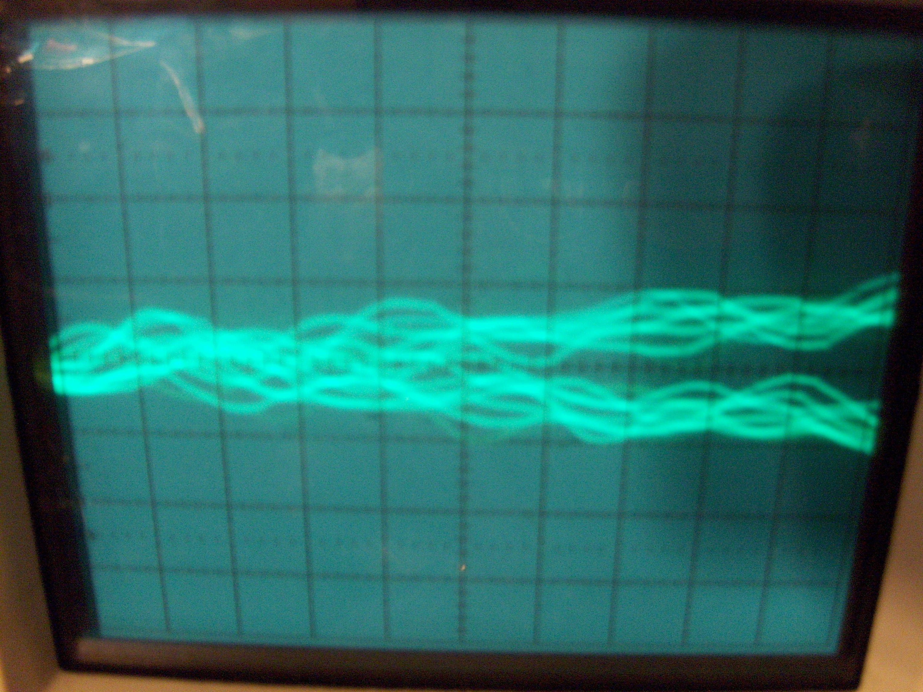

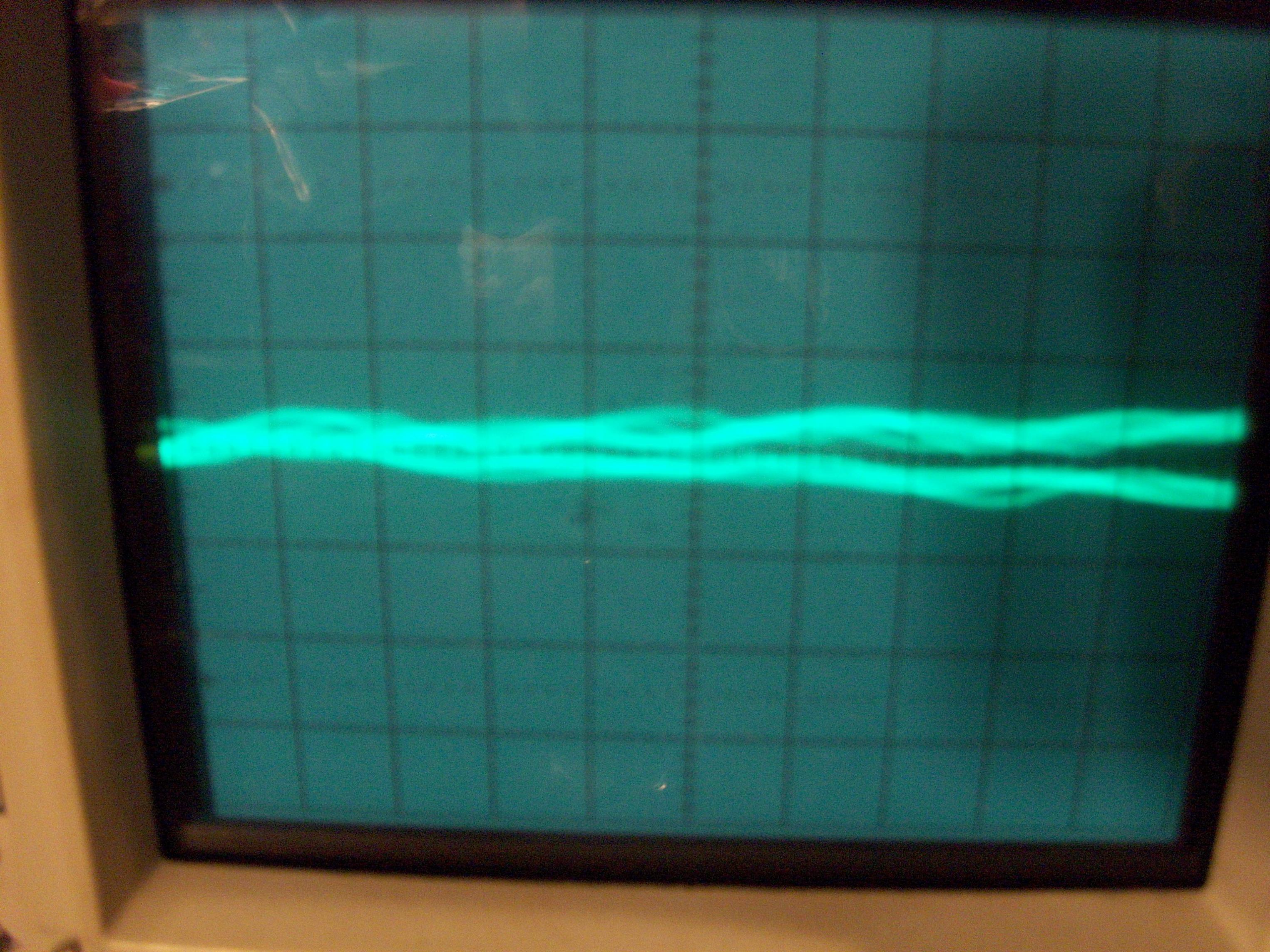

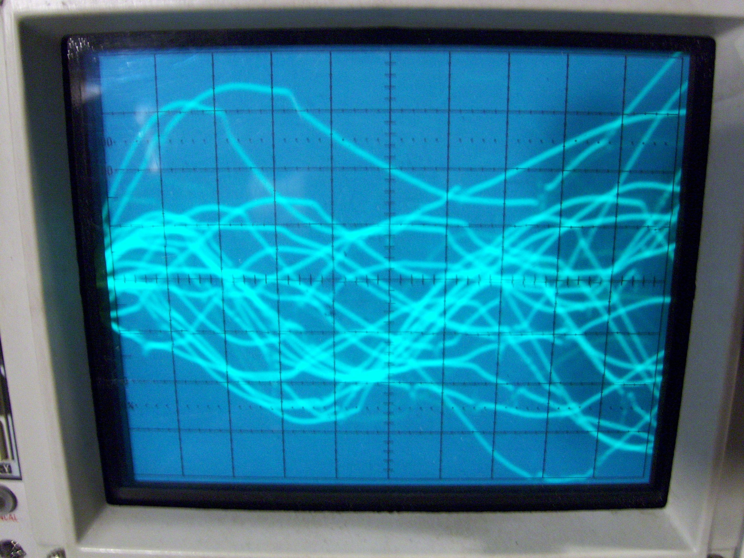

If I lower the vertical amp it gets more crazy and leaves the display. Should I try a different us setting?
If you probe isn't set to 10x, set it to 10x and try again.

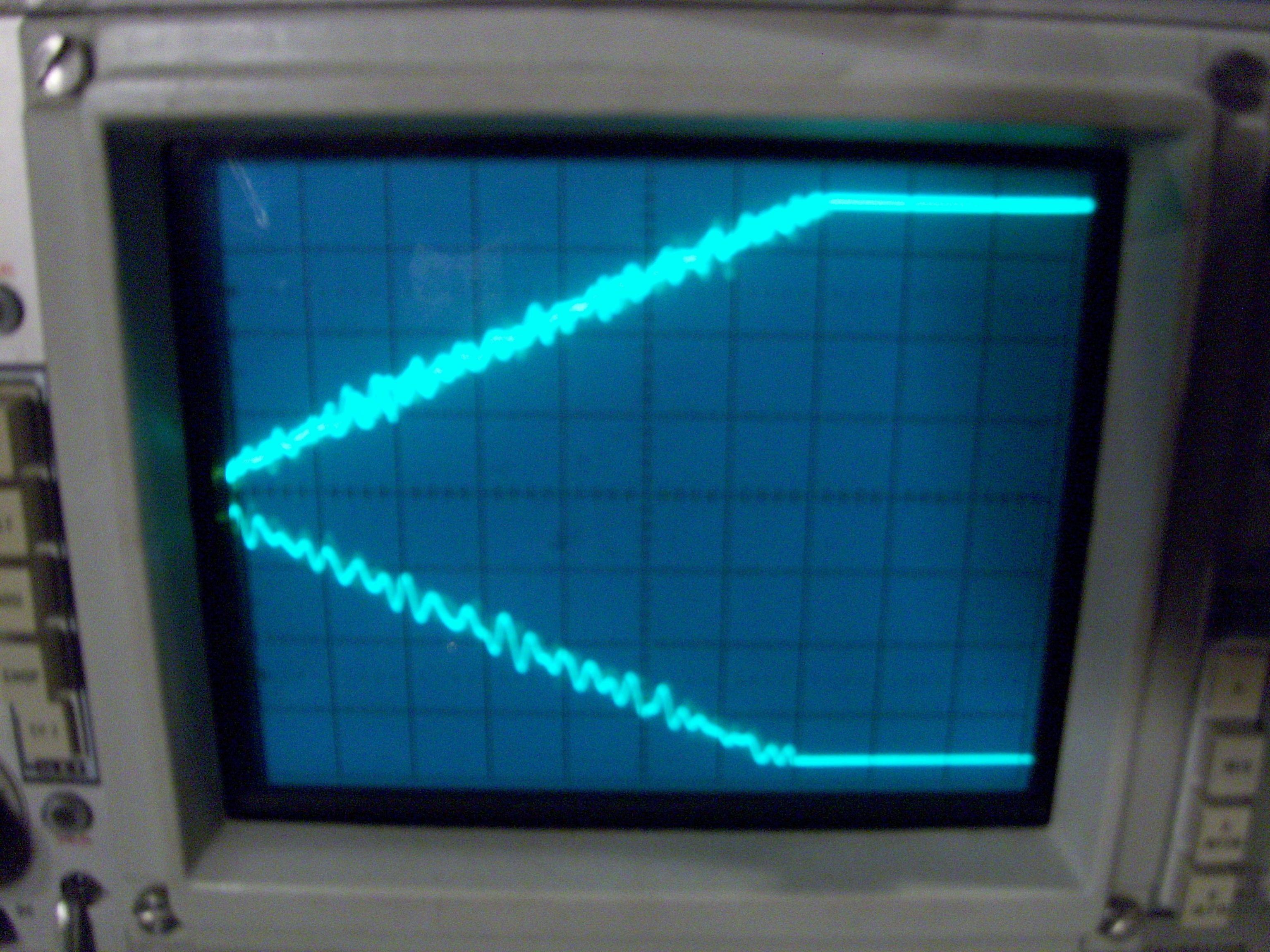

If I set the scope to 10v/d and 50us this is what I get at max volume. Is this a clipped signal? Both channels perform identical no matter the setting.........Thoughts???
Yes. Set the timebase to show 3-4 complete cycles. Try adjusting the trigger level to get it to trigger properly. Unless you're using two probes/inputs, it should only have one waveform.
Whenever using the scope, unless you have a good reason to do otherwise, adjust the timebase to display 3-4 complete cycles. Set the vertical amp so that the waveform is deflected between 2 major divisions and 4 major divisions (the top of the graticule).

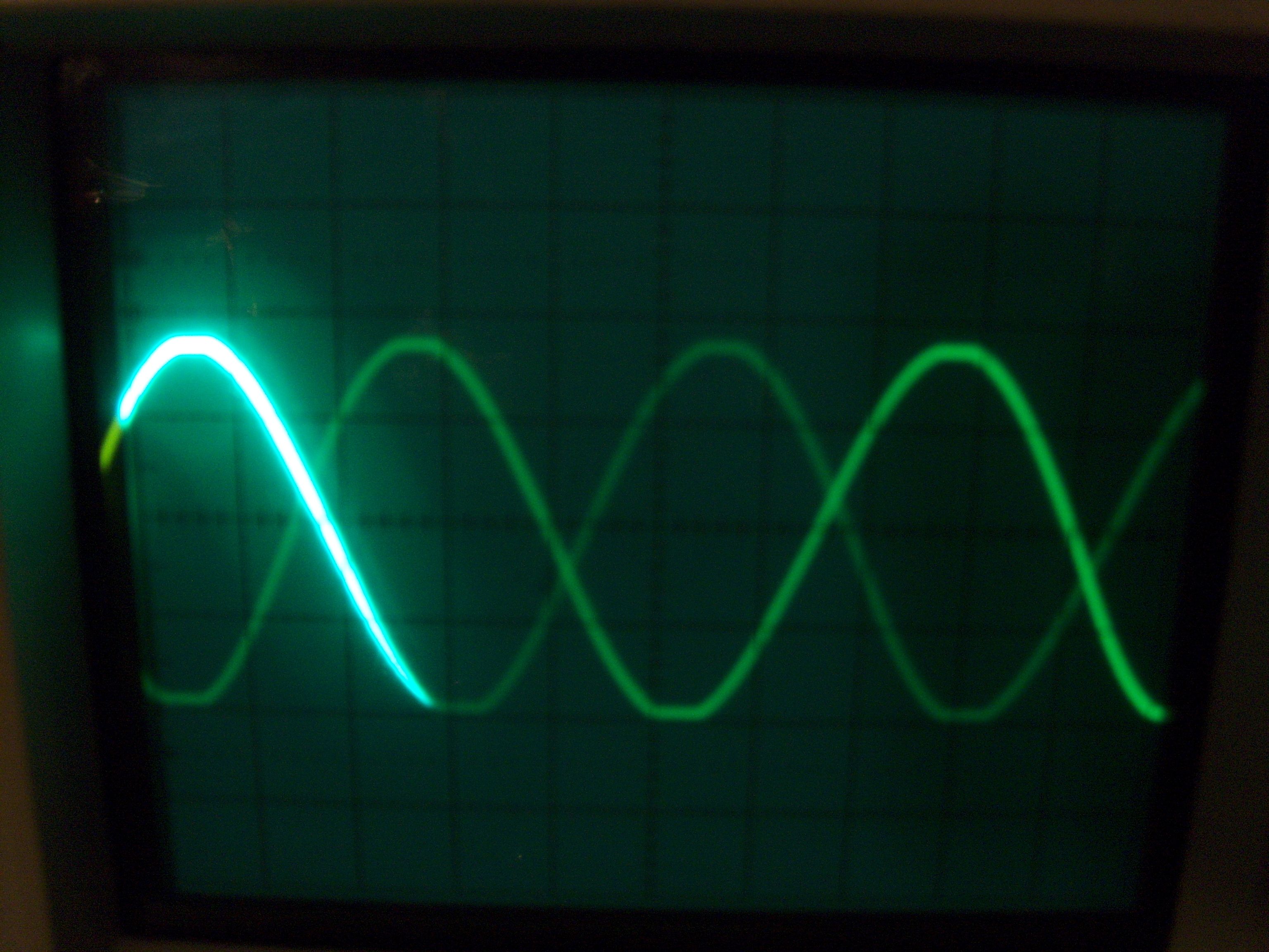

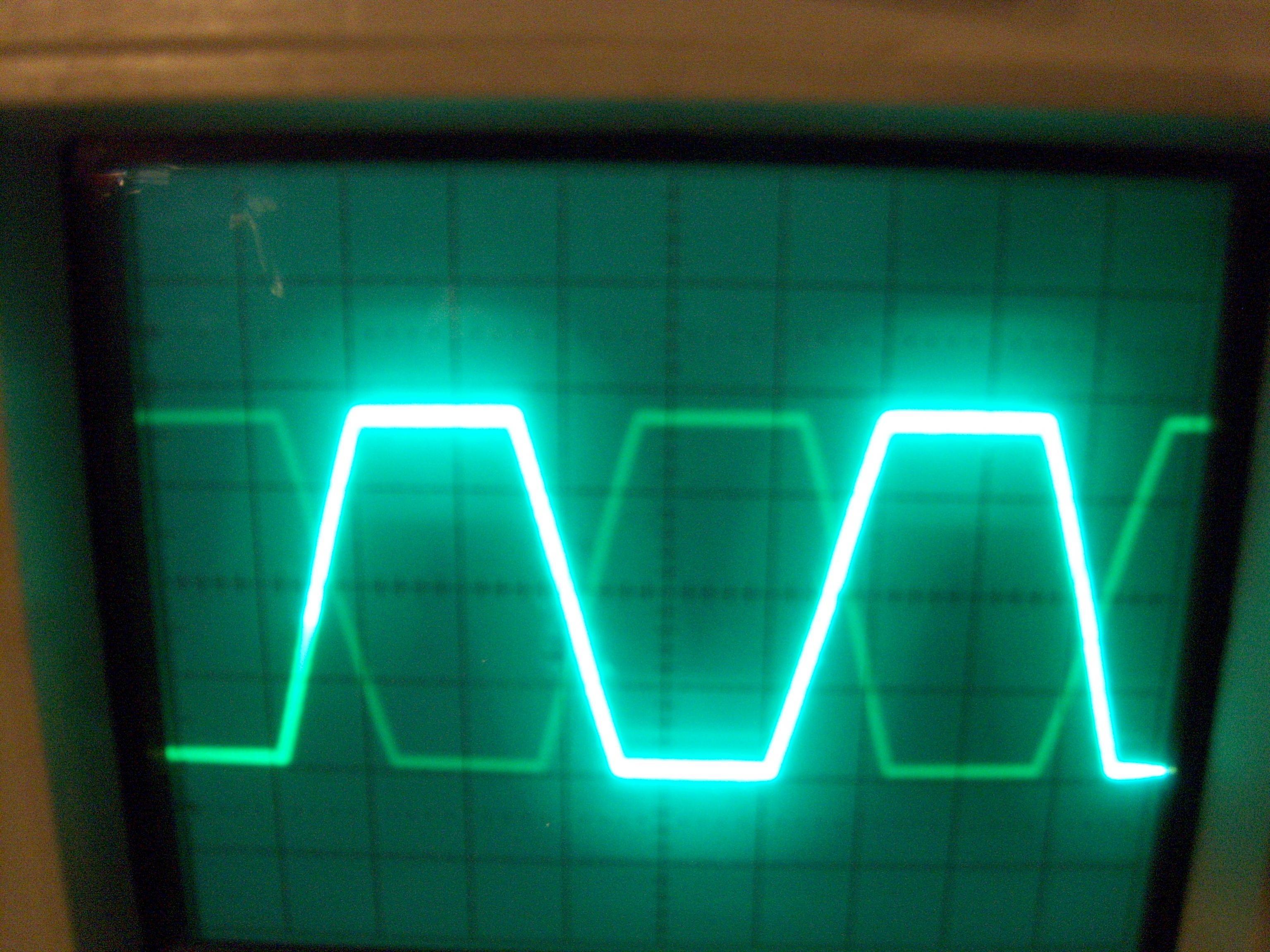

That was a 100Hz test tone. Any suggestions on what I may be doing wrong? Have not got the bananna clip yet, think my scope ground isn't connecting good?
Ok Perry think I have what you want.
Scope settings:
20 vol/div
1 ms
100hz test tone
first pic is 1/2 volume 15
second pic is 3/4 volume 25
Is this the clip signal you wanted to see?
Both channels perform identically.

That's clipping.
The drivers are all likely OK if both channels clip like that.
