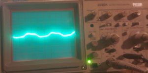

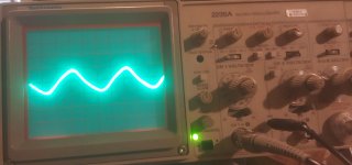

Yes. I can not get all the way to clipping just by input signal at max with gain all the way down but fairly close. The oscillation/ fuzziness was over all parts of the wave, not just the top and bottom like when the gain is increased. But also the entire wave became clear when a load was attached.

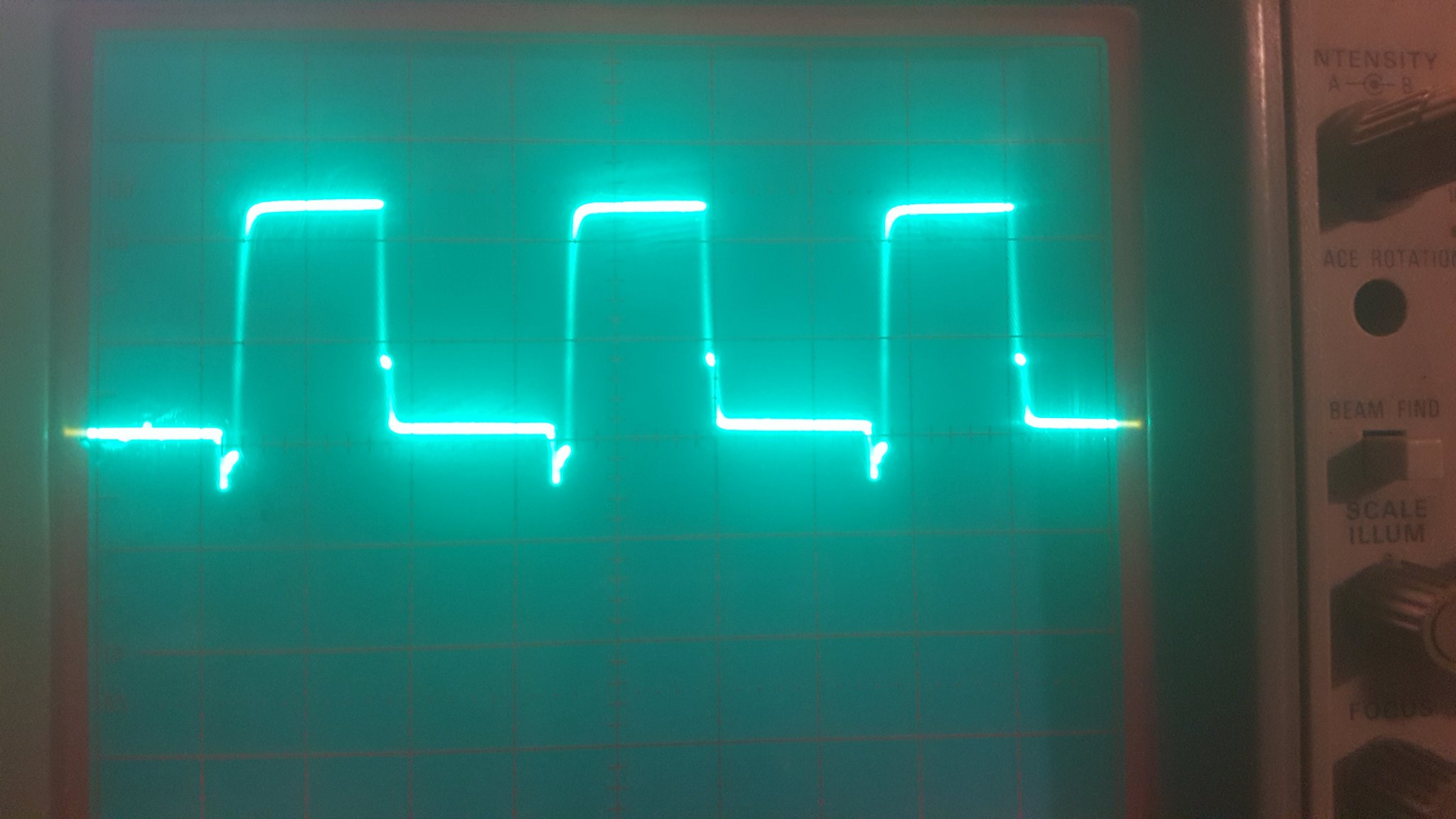

The PS gate drive is attached. I had to change the vertical scale to make it visible. Scope is set at 5 V/div and 10 us
Supply voltage is 13.54 Vdc

At what 12v supply voltage do you see essentially 0v across terminals 1 and 2 of the 494?
When it reaches 0v between them, what's the DC voltage to ground on those pins?
My supply will only go to '15' Vdc, actually 14.70 Vdc.
At 14.70 V this is closest to 0 V I can get across pins 1 and 2, which is 0.607 Vdc.

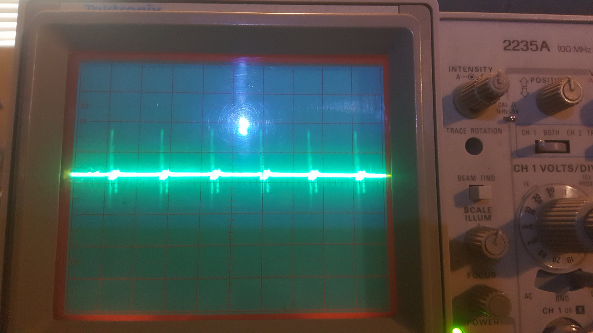

After more tinkering I did find a difference between Ch4 and the other three channels.
With no input signal, I found what I think would be oscillation at a frequency of 500 kHz. This only on Ch4. it is riding on +2, 0, -2 Vdc, depending on which side of the circuit with respect to the +/- rails the measurement was taken.
I am referencing page 6 of the diagram in post #117
Scope set at 1 V/div and 0.5 us
The first pic oscillation can be seen on:
Collector on Q405 and Q406
Base and Emitter Q408 and Q409
BCE on Q407
The image was actually taken on one terminal of the bias pot.
The second picture is, 1 V/div and 0.5 us, is taken on the drain of the out put FETs and can also be seen on the LR+ speaker terminal.
All the other channels show ~0 Vdc on the drains and the speaker terminals.

Are you saying that 3 channels are absolutely perfect and that ch4 is the only channel with oscillation?
Does it go away with a load?
Do you see this on the capacitor C412?
