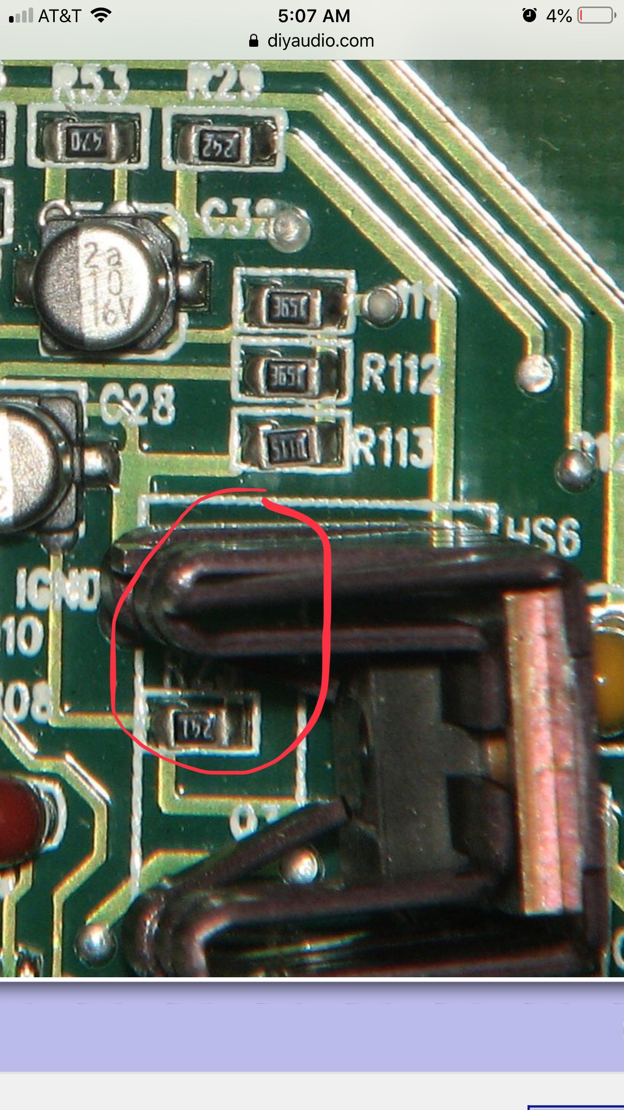

Do I go by the schematic or what since the pics you have don’t match the schematic ?
And also do you know the value of this resistor ? It looks like
A 240 ohm just wanna confirm

C45 will change the bass boost slightly. C26 will probably not make a difference.
What are the problems with the amp right now that are making it unusable?
The problem is likely after the preamp section since you had more preamp output than I did.
