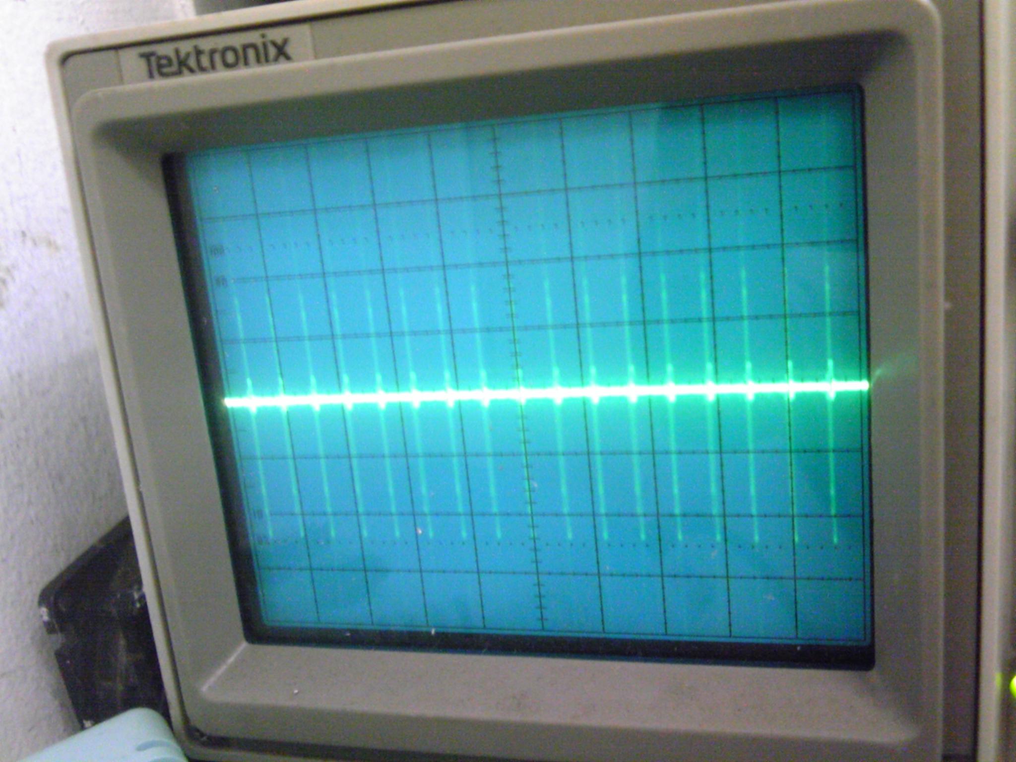

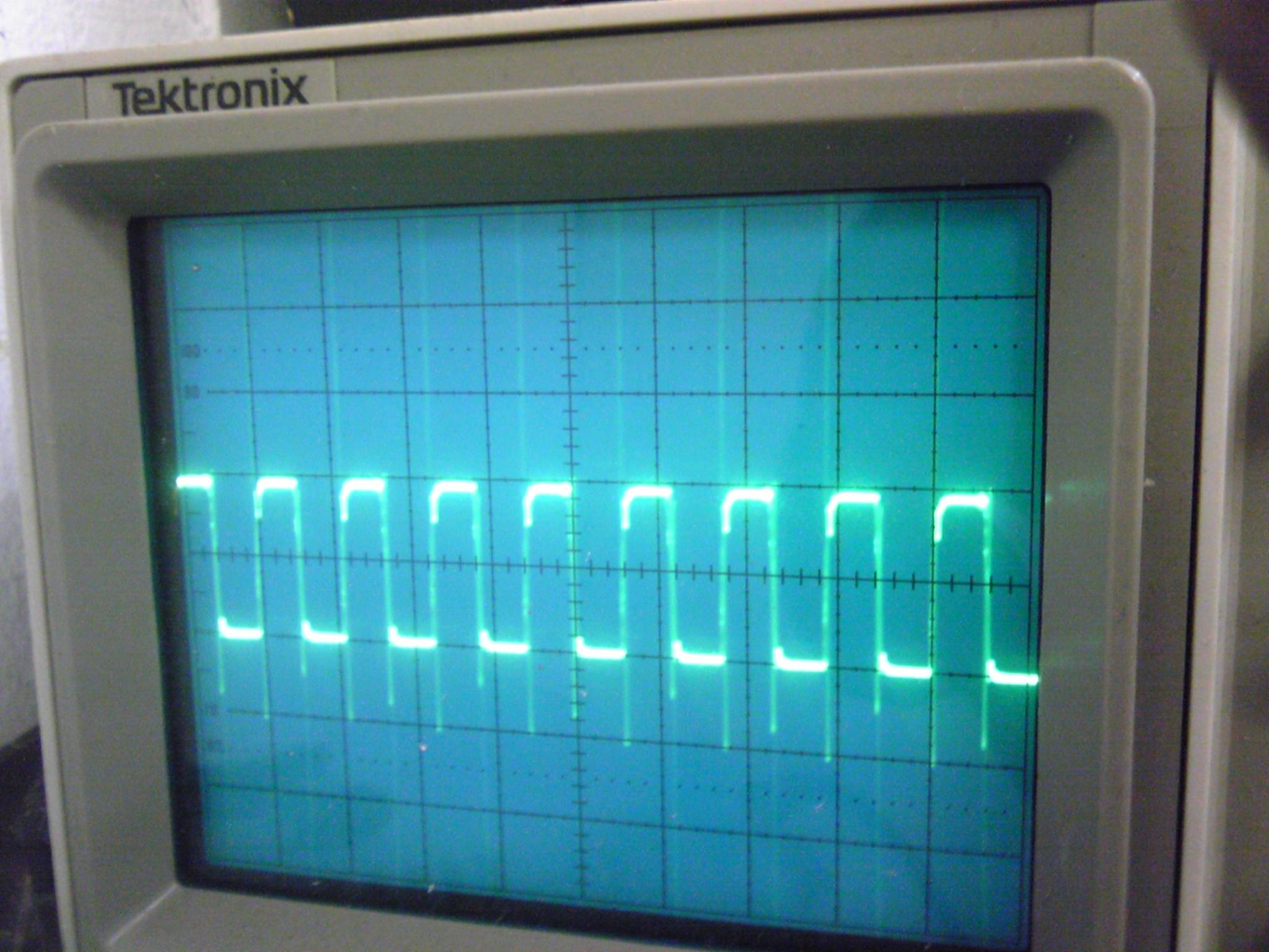

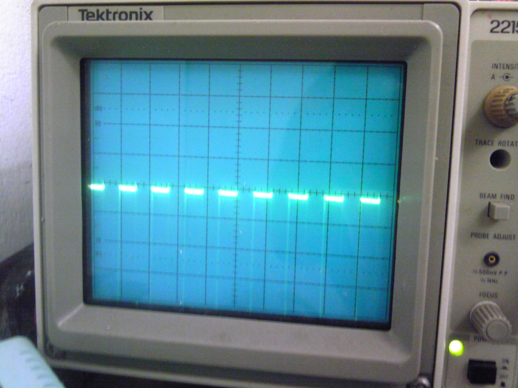

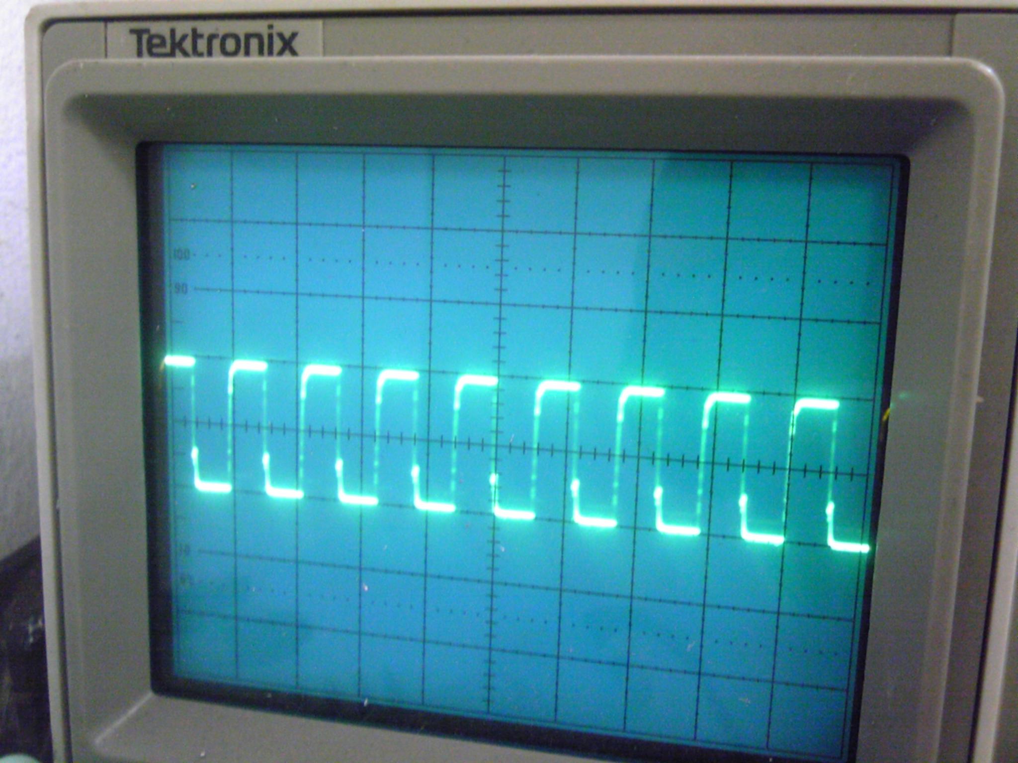

This amp does not power on.I think it powers up and then go to protect.
Rail caps have massive charge.
pwm IC
1:4.97
2:3.689
3:4.22
4:4.70
5:4.79
6:0.001
7:0.001
8:4.28
9:3.724
10:2.016
11:0.003
12:4.63
13:6.50
14:15.34
15:0.001
16:6.25
17:15.37
18:4.97
All PS FETs have same wave form on center leg.
Outputs group one (in a pic here i see they mark as switchers ) 3415/6215 10v/dv 10/us
