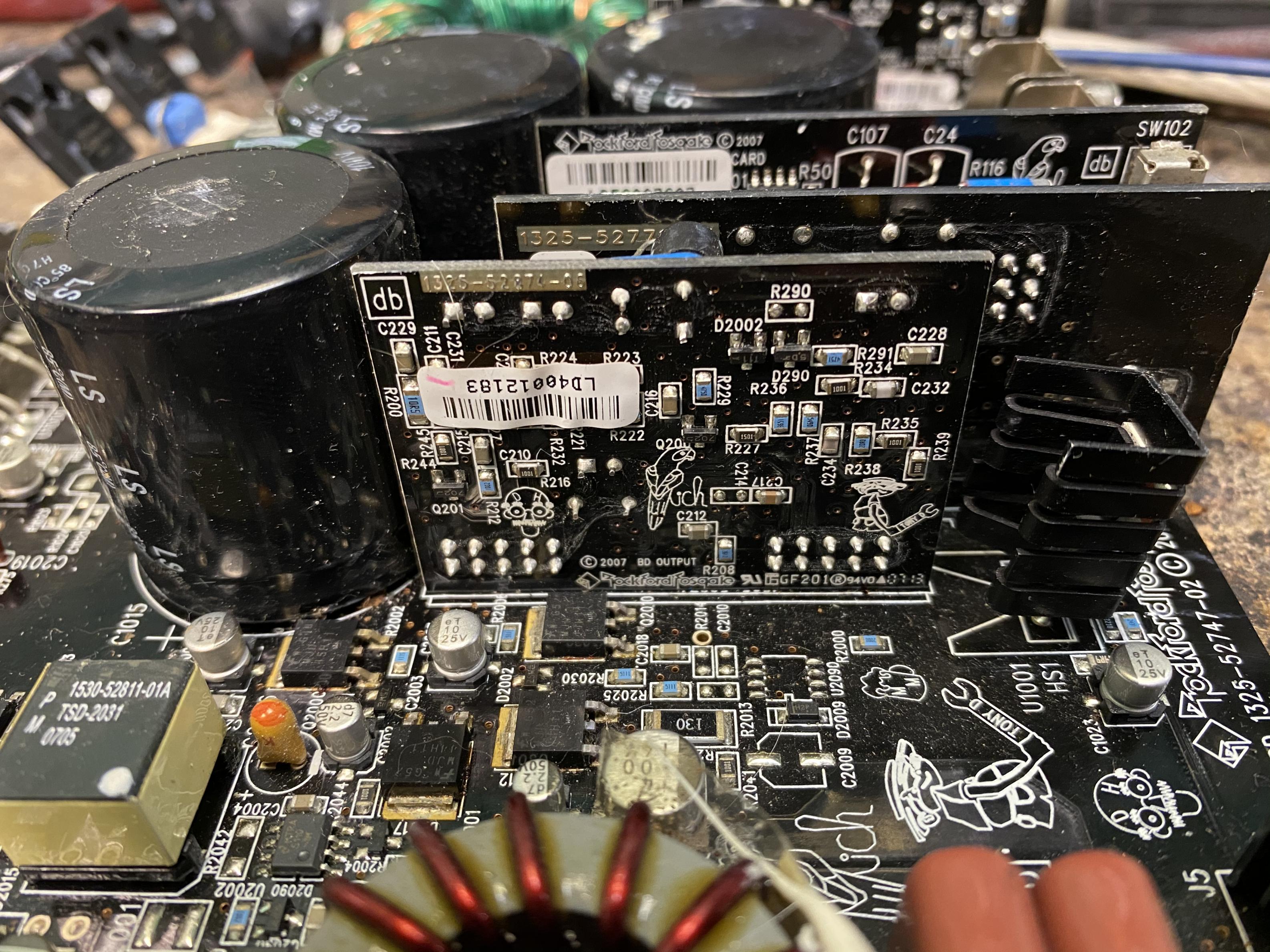

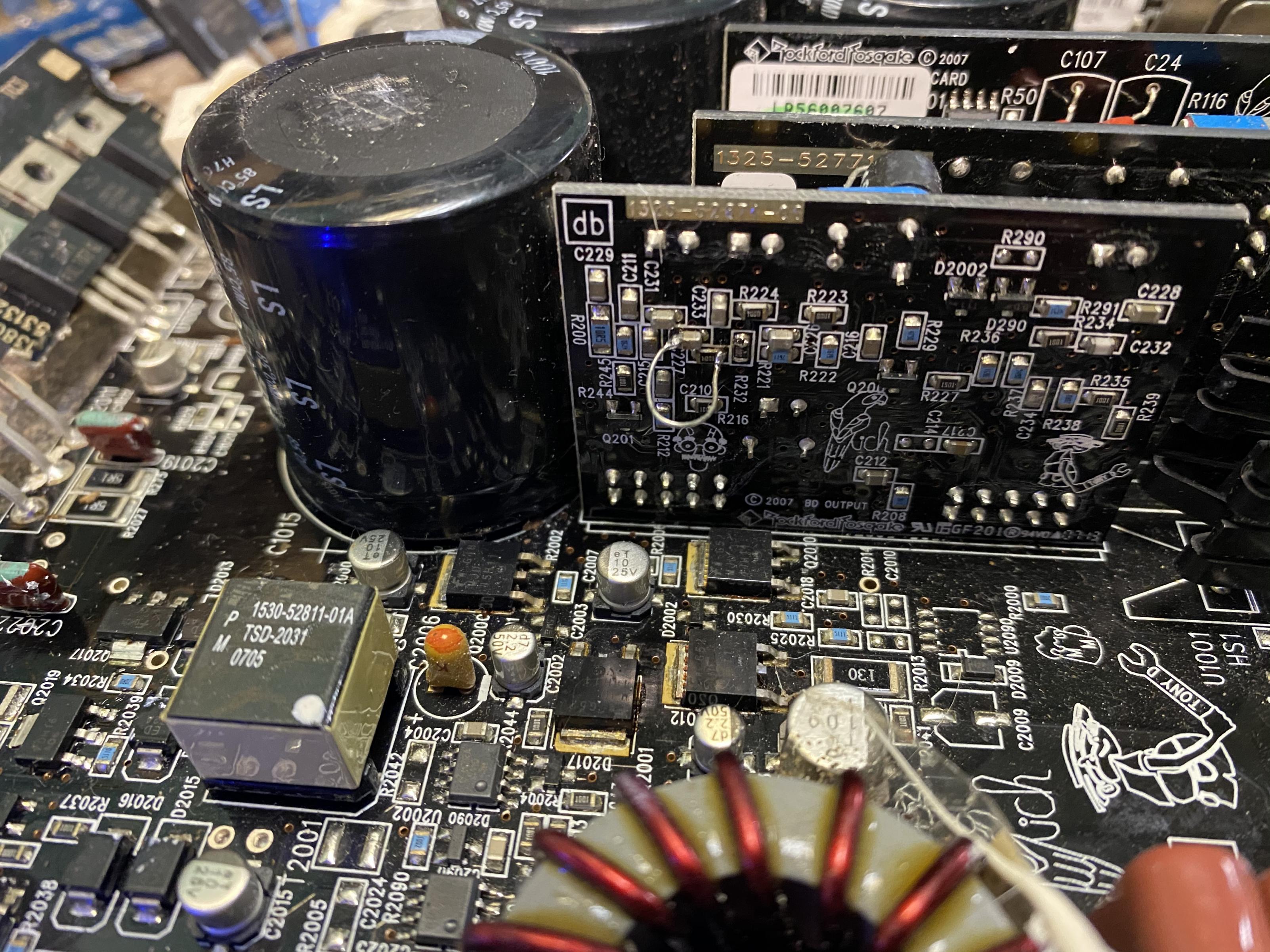

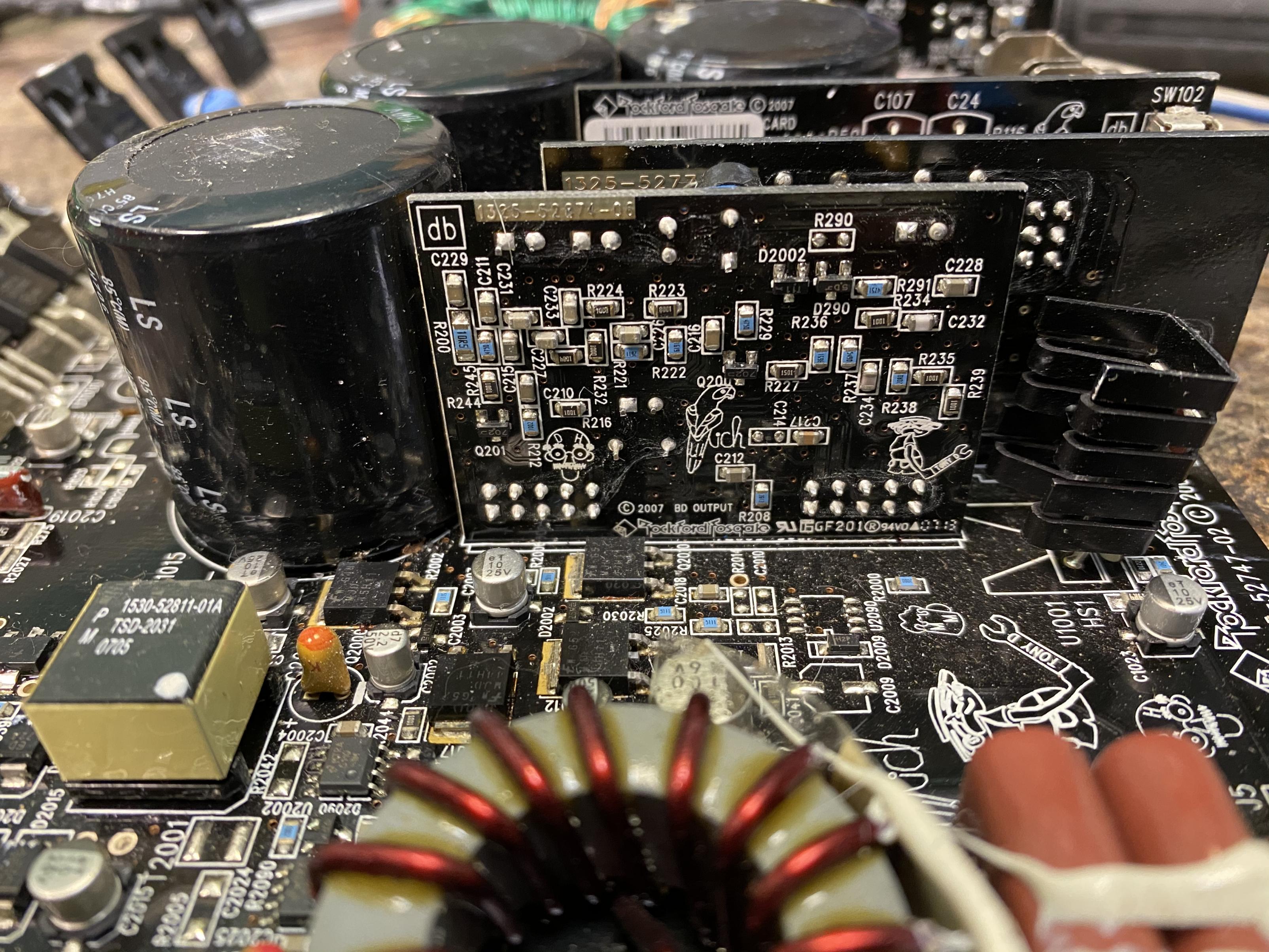

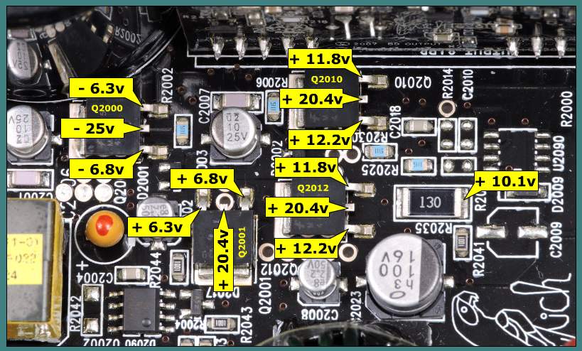

D2017 only has 0.71 volts on the output leg .
All other regulators have the correct voltages .
I’m getting supply volt use on the op amps
