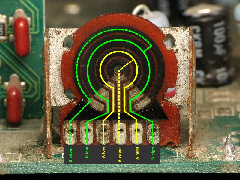

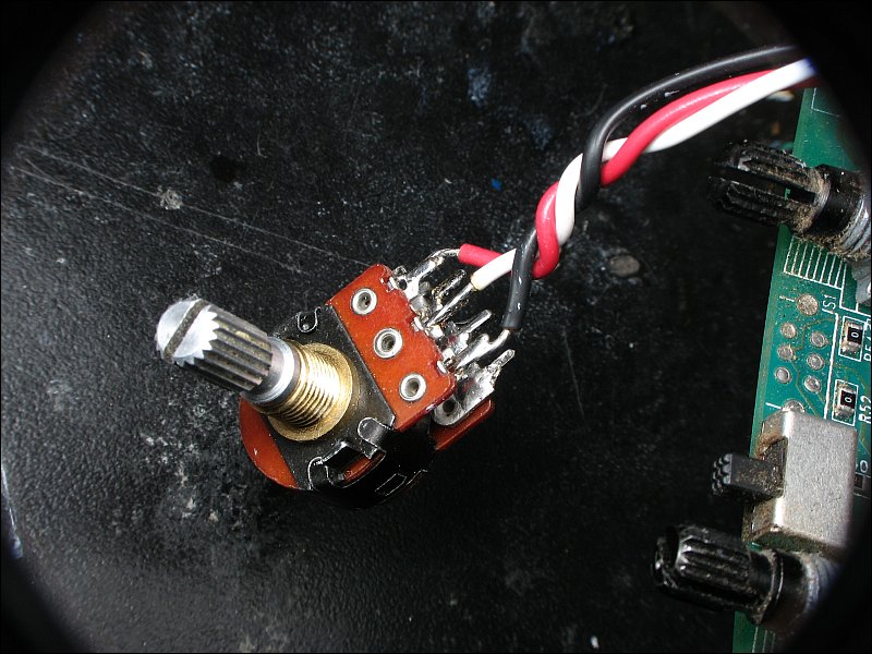

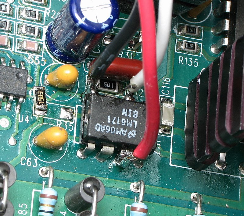

The amp does produce audio but I cant crank it until I grease it and clamp it. The audio sounds clean and sounds like it has good power but I am not gonna crank it without clamping it first.
I really dont understand what I fixed here? I originally replaced all the output fets. After removing R35 and R31, I blew the good side when the pot malfunctioned. Then I replaced the ones I blew and a few emitters re-installed R35 and R31 and now it works?
I dont understand it one bit?????
I greased it up and clamped it in the sink and played it at a low volume (baby sleeping) for about 15 min with no issues. I will run it hard tomorrow and let you know how everything goes. So far so good.
Thanks again for all your help Perry.
