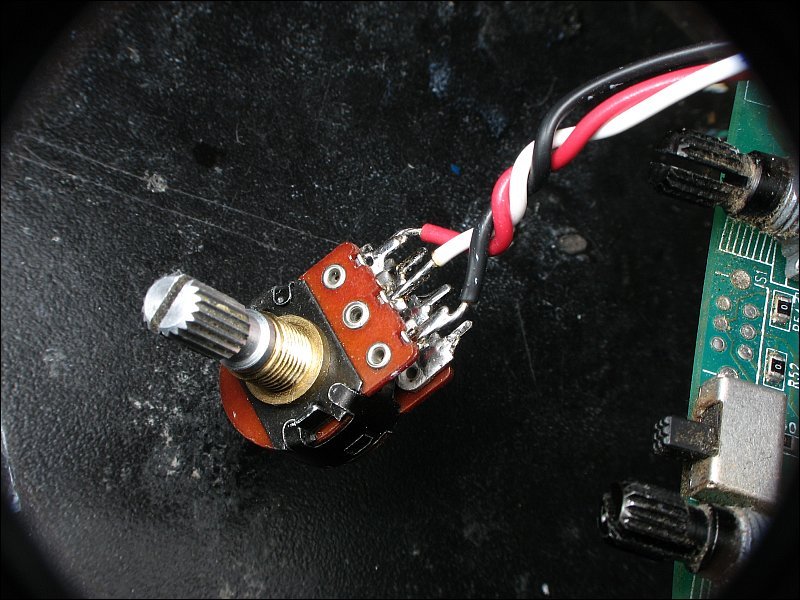

Do you have a pot (10k ohms or greater) that you can wire as shown in the following images?

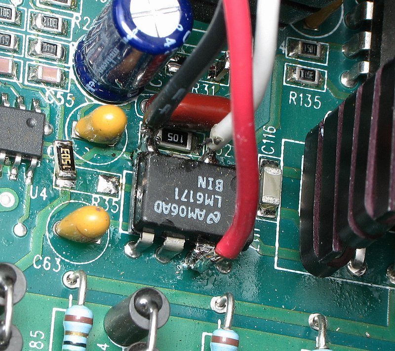

This chip monitors the output and drives the outputs (or actually the drive circuit which in-turn drives the outputs) so that there is no (or very little) distortion in the output signal.
In the photo, you can see that R35 and R31 have been disconnected. You can leave R35 but you need to slide R31 from its pads.
What you will need to do is rotate the pot from about the 10 o'clock position to the 2 o'clock position to make the output of the output of U17 toggle from 9v to -9v. Go through the 12 o'clock position quickly. Sometimes, if you go through it slowly, it can damage the outputs. Try not to go below the 9 o'clock or above the 3 o'clock positions.
First, confirm that pin 6 is toggling as it should when you go from 10 to 2.
The pot needs to be at least 4.7k ohms. A 10k is better. Anything up to 100k should work.
Perry,
all i had was a 20k pot like the ones used for the crossover. I wired it like the picture and powered the unit up. i checked the output on pin 6 and it was reading 8.68v with 123v on the speaker terminal. When i turned the pot from 10 o'clock to 2 o'clock the reading changed to a -8.08v.
