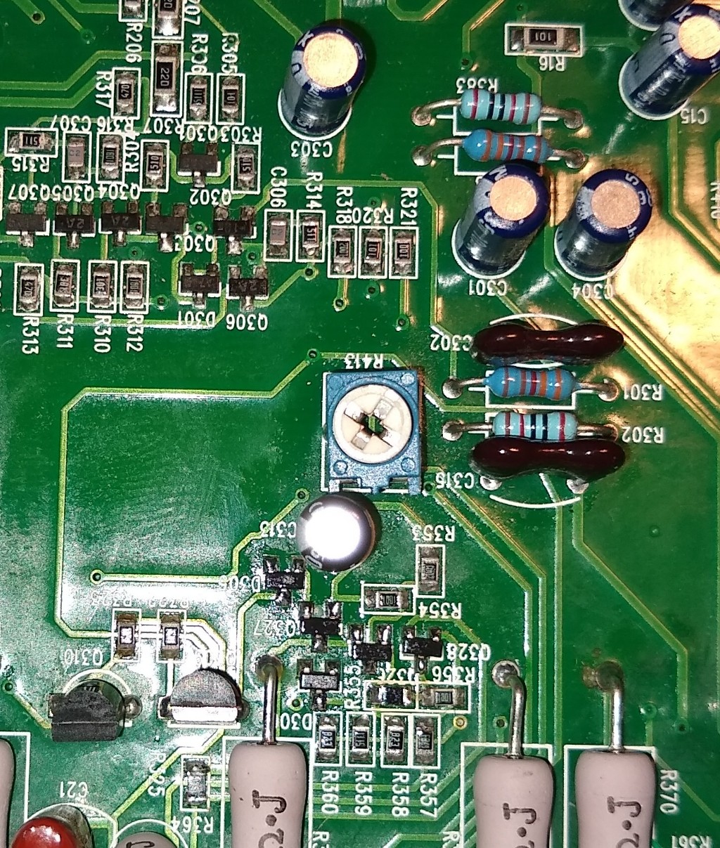

Hi Perry,
Sorry for taking so long to get back to this. I pulled this board back out tonight and initially had distorted/crackling output on the same channel that was giving me bias trouble. Attempting to adjust the bias gave no change in current draw or cleaner output. I sprayed the bias pot with some Deoxit Fader F5, and that seemed to help as I now get positive adjustment.
I was still getting small changes in the current draw and some popping & crackling output when pressing on the board. I flipped it over and found some residual cotton swab fibers leftover from cleaning flux after replacing fets/etc. I cleaned that all off and now it seems to be working and maintaining the bias even when pressing/flexing the board. Seems like some flux soaked fibers were causing some conductive bridges between some components - do you think it could be that simple?
R5 & R6, along with the TL494 still getting warm/hot. I'm just judging this by touch - R5 & R6 getting hotter than the TL494. I can hold my finger to them continuously, but I would say they are getting close to uncomfortable. Do you think this is normal? Anything else I can/should check? I can probably compare to another 800a2 board if that's my best option.
This is the bias pot - is this a Piher? I know some of the others have Pihers similar looking to the gain pots, but I can't find these. The only markings are a subscript N, 202, subscript X.
The resistors are likely contributing to the heating of the 494.
I can't remember ever having to replace one of those bias pots. This is the number from a Rockford parts list.
(PIHER # N6L30T3N-202)
If you can't find it, try contacting the forum member seankane.
