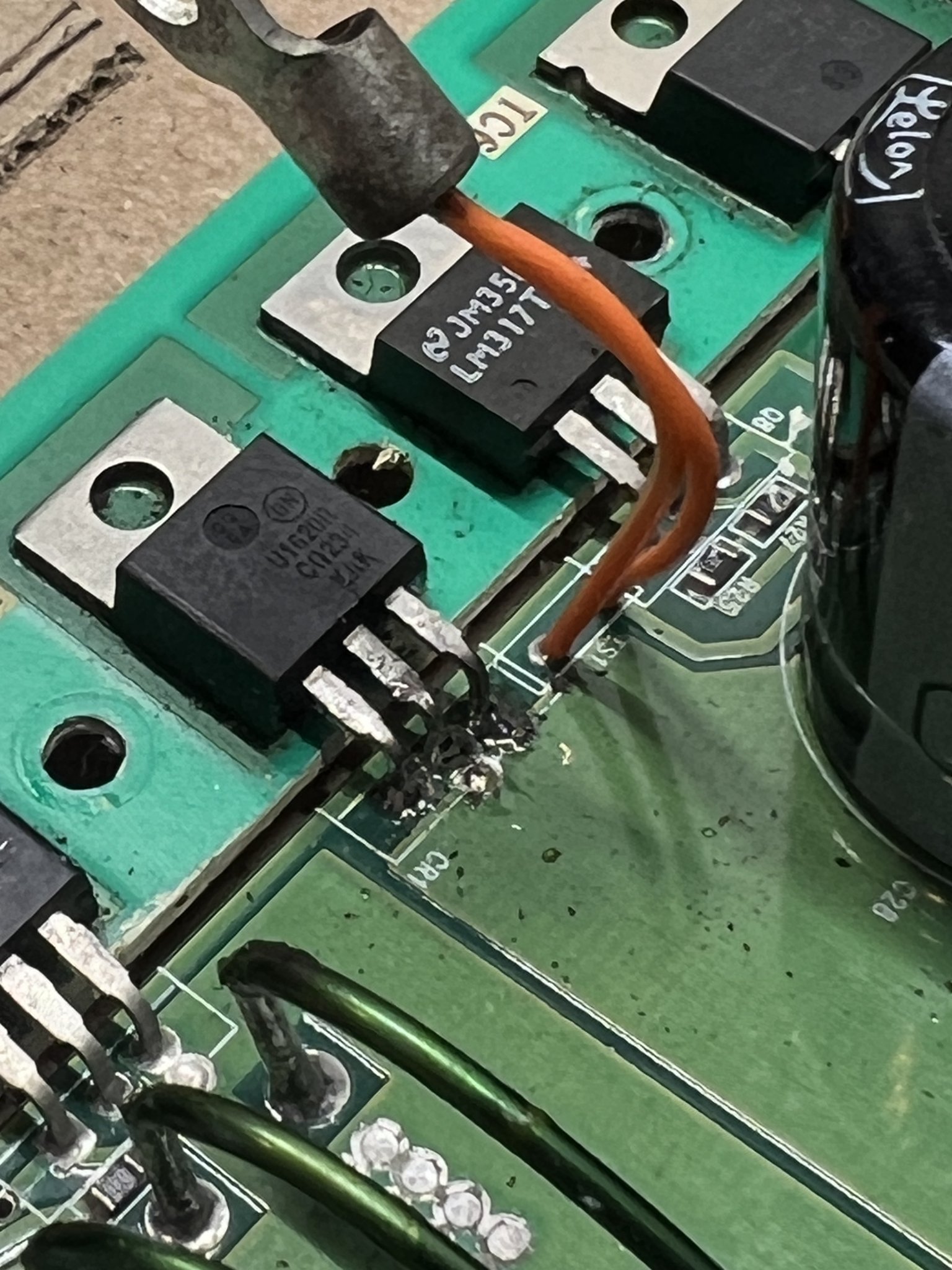

I have interesting one today, got a basic Rockford fosgate with 45vdc on the speaker terminals. All the power supply FETs and audio FETs check out good. What I have found so far is there is little to no voltage on the P channel fets. Lm337 has little to no voltage.
I replaced the lm336 voltage regulator. I found no issues the in the driver circuits, could this be a drive signal issue? I know modulation is the tl494 for powersupply but does it modular for the audio too
Sorry for the delay Perry had to walk away after the element burned out of my hot air solder gun.
So it was the negative rectifier. I not sure why I was thinking the negative rectifier was beside the positive voltage regulator. Anyway I pulled the legs on it and it tested fine but when deadened it from the back I could see through the pin holes and thought that was odd. Turns out the center leg either broken off at top of the eyelet and solder joint broke. Once pressed the leg further down in the eyelet and resoldered it all voltages were back.
