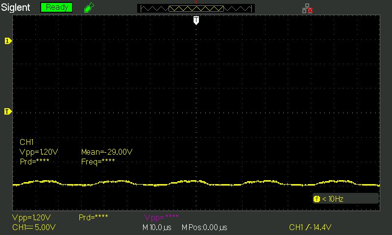

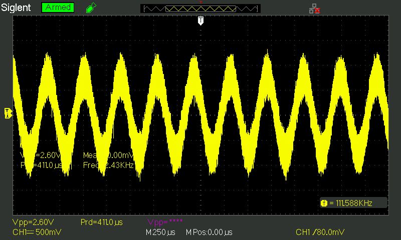

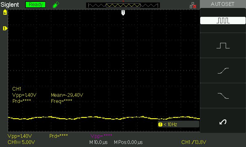

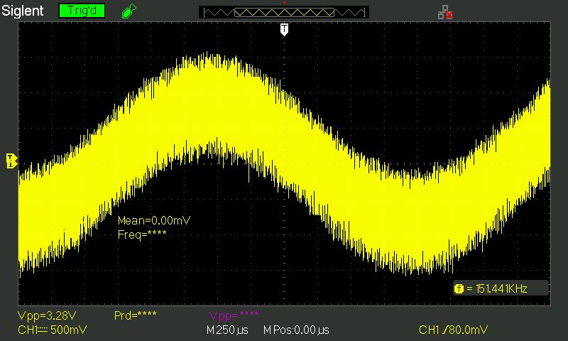

There is, here are the IRF540 gates with bias CCW.
Ch1
Ch2
Ch3
Ch4

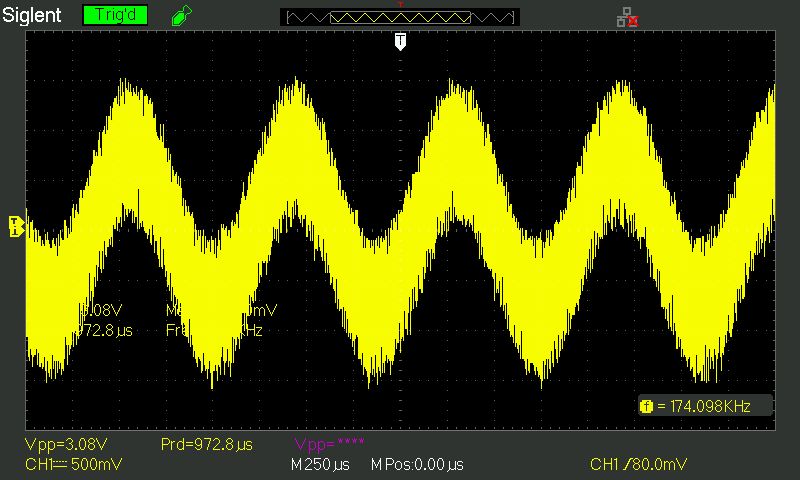

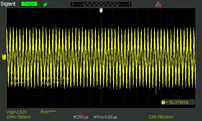

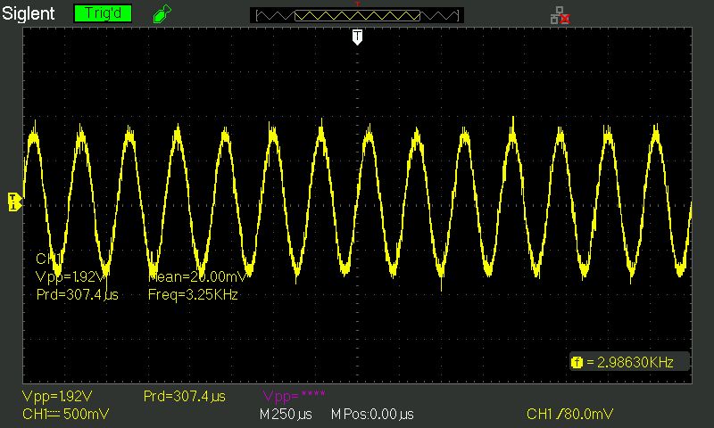

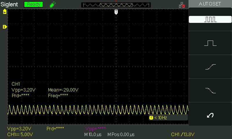

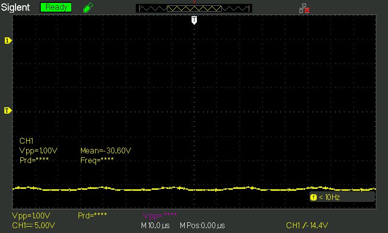

When I turn up the bias it causes a higher frequency oscillation. If I turn it slightly higher it smooths out, and if I turn it CCW it oscillates at a higher amplitude as I approach fully CCW. This is Ch 3 for instance:
Bias fully CCW:
Bias turned up about "normal"
Bias turned back fully CCW
It seems to do this on all channels, with some of them returning to their idle state at fully CCW

I looked at the diagram again. Why Rx39?
Until you resolve the problem of the oscillation, you're going to continue having this problem.
How distorted is the output signal with the bias fully CCW?

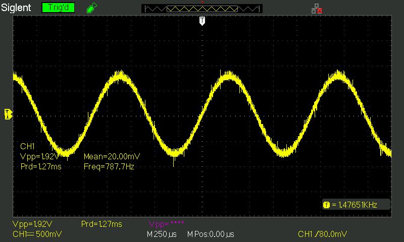

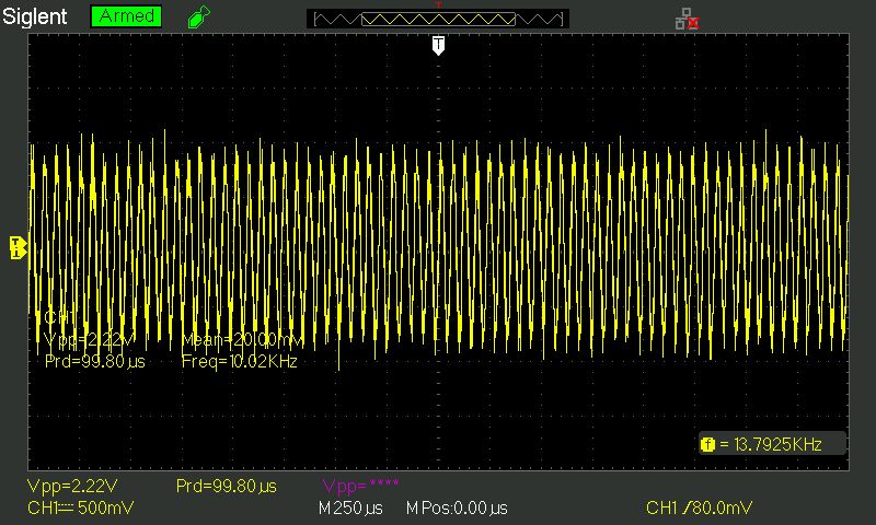

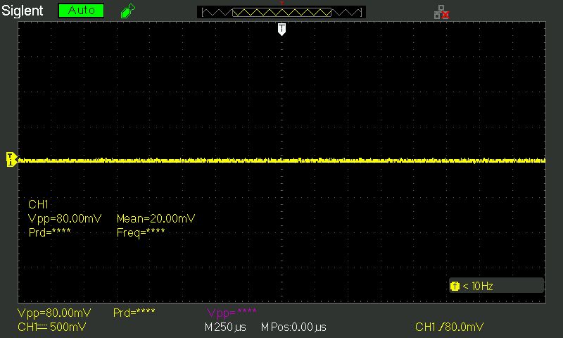

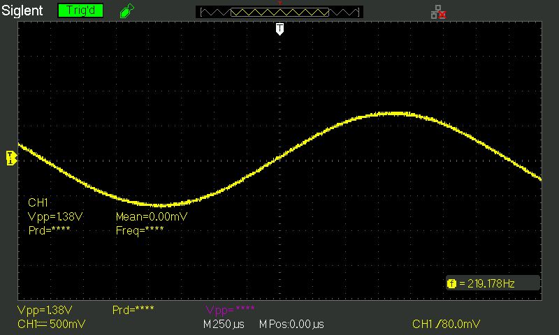

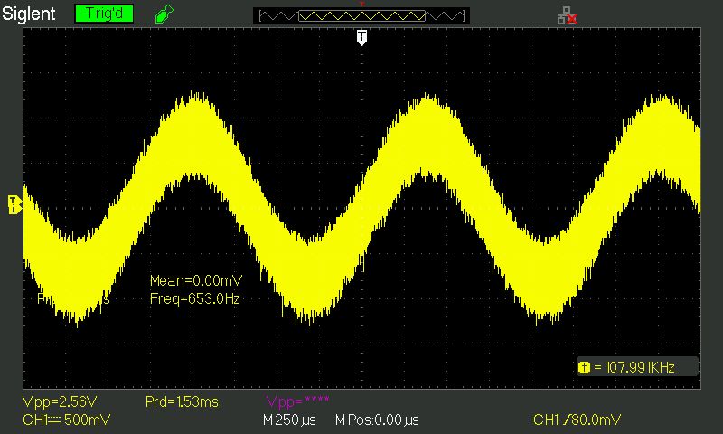

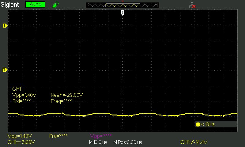

What should I drive into it to look at the output? It plays audio without noticable distortion.

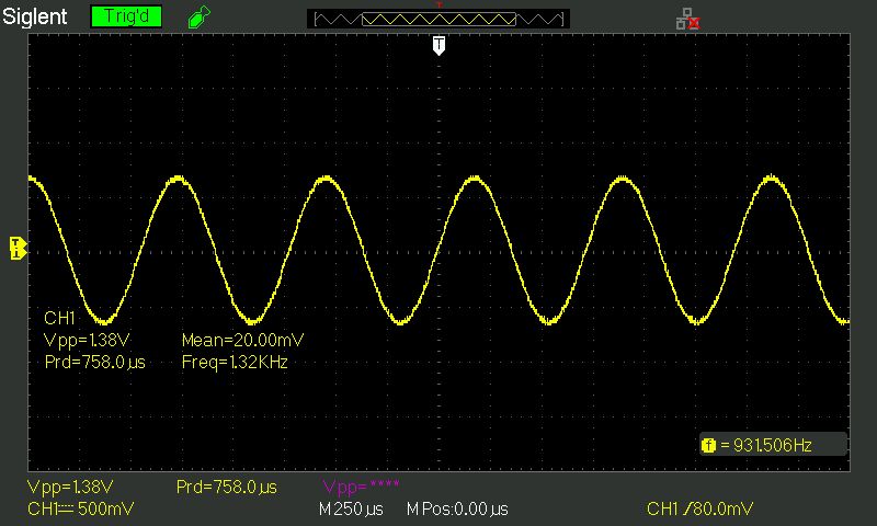

Input source:

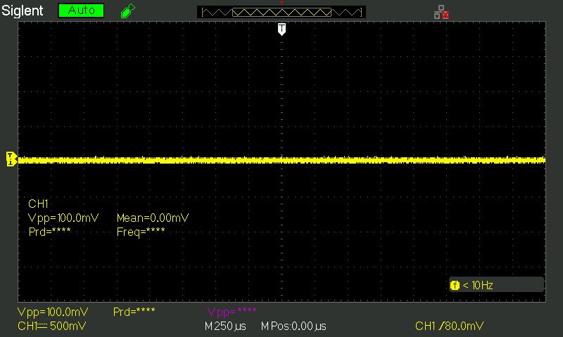

Output with bias fully CCW:
Output with bias around normal position:
Output with bias turned back fully CCW:

The best I could find on hand were 270pf smd caps. I switched out C113 & C115 with those. I am able to bias the channel more normally now, and output on the scope seems to be comparable to the other 400a4 I have.
With that much of a change, it may have limited the frequency response of the amp. You need to run a 20Hz-20kHz sweep to confirm that the frequency response is still OK. It doesn't need to be more than enough signal than it takes to get a volt of output.
Clamp the FETs down before doing this.
Seems to be okay through the sweep. I can order some other lower values to try - what would you recommend?
