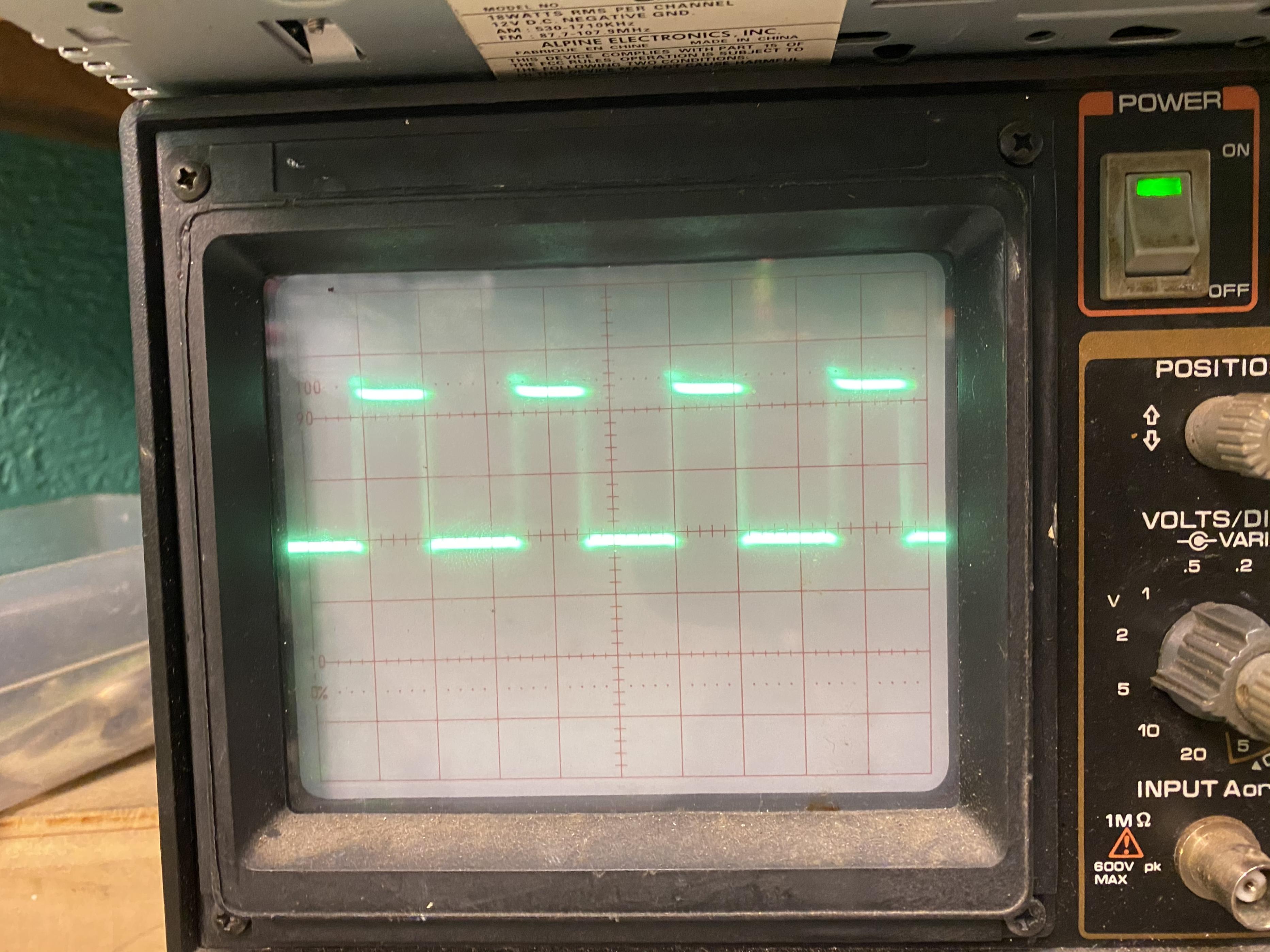

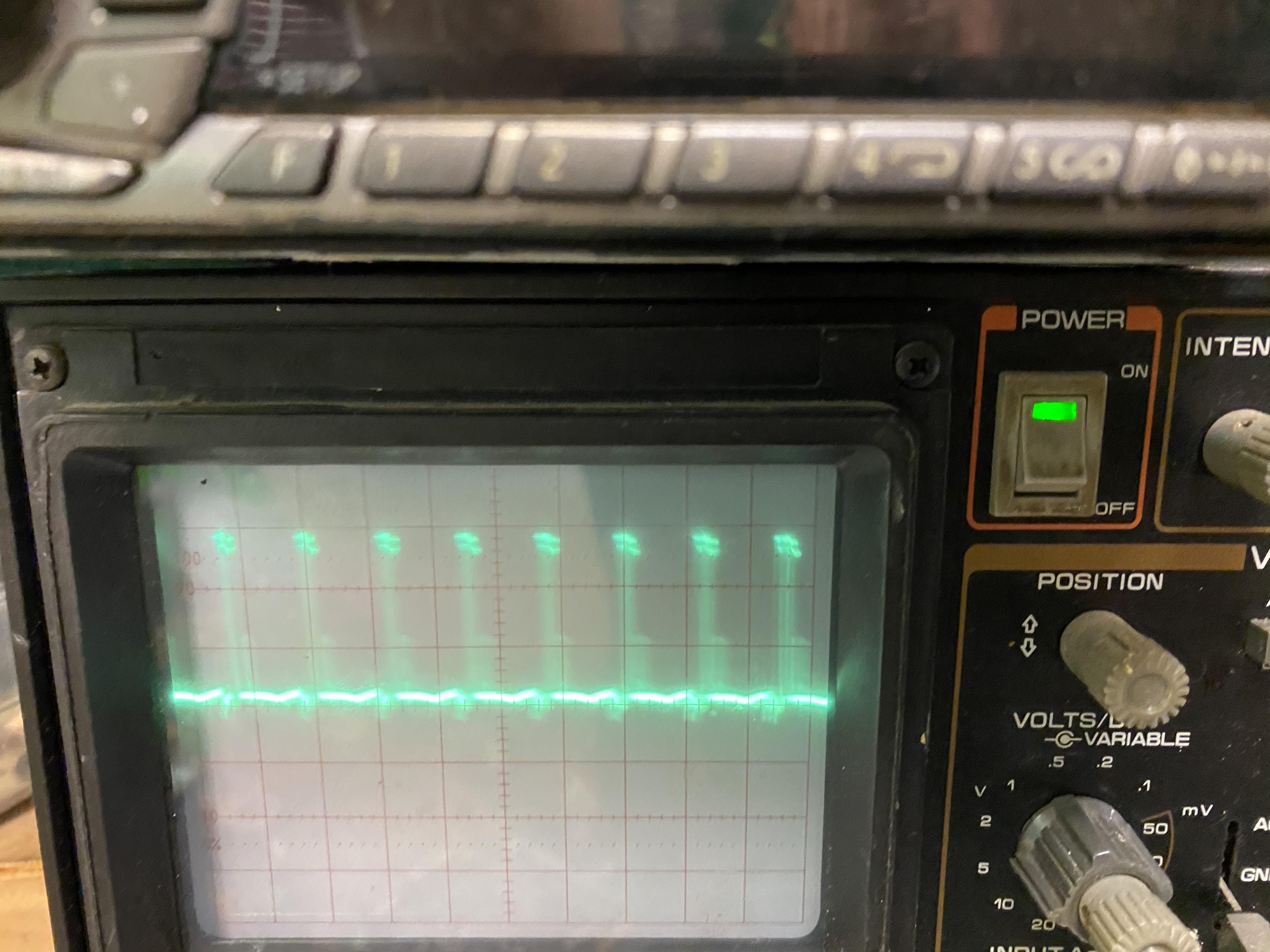

When it draws excessive current the top of the waveform disappears and it looks like a lot of vertical lines on the scope .

The first pic is when the amp powers up normally
The 2nd pic is when the amp draws excessive current.
Scope set to 10us 5volts/div
Both banks of fets heat equally
