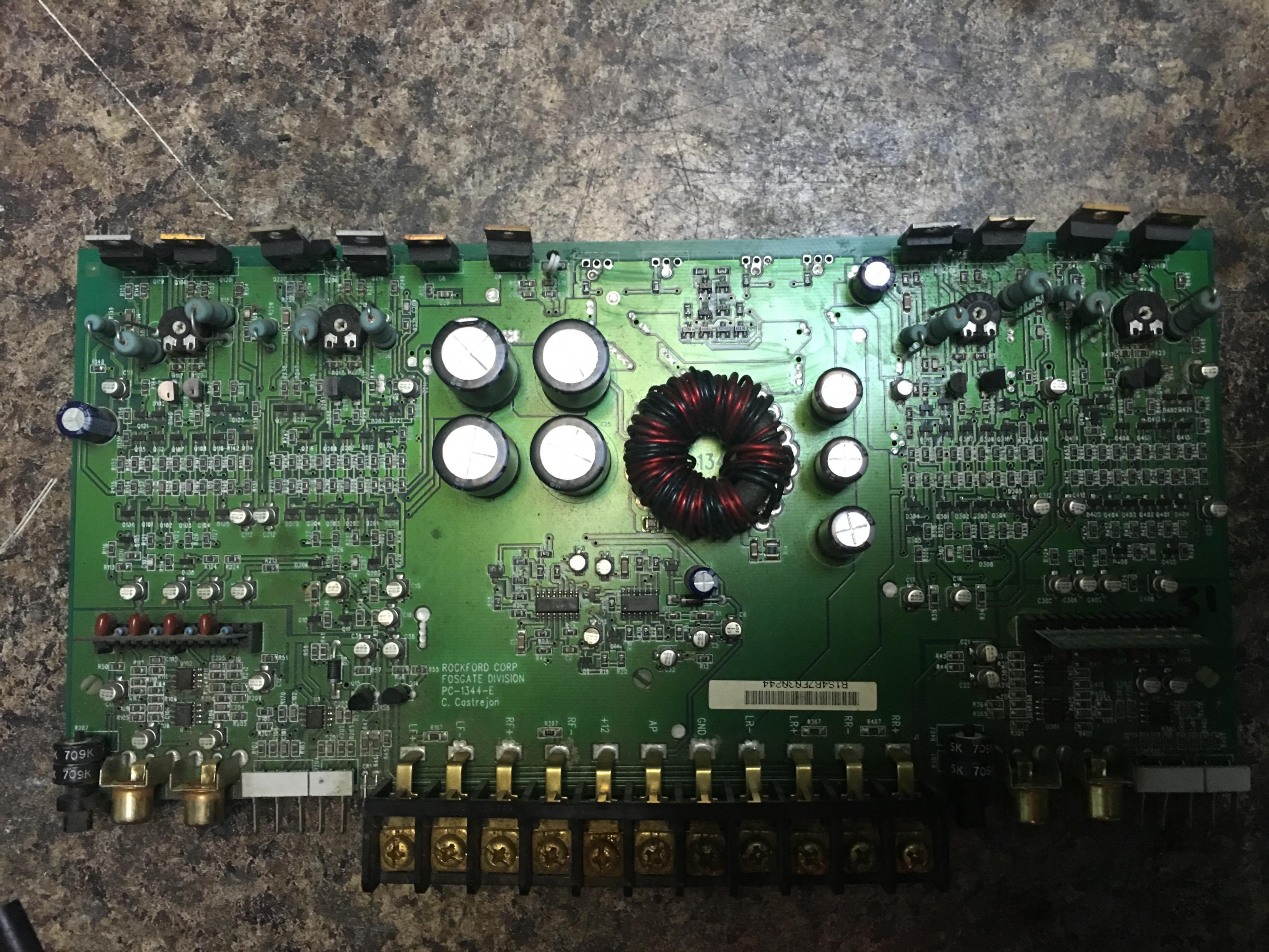

Rockford Fosgate 4.6X
Someone has been inside this amp at some point ..
The power supply fets that I found in it were IRFZ44N
Gate resistors are 10 ohm
Power supply drivers are mixed I have 1A'S/2A'S and 1G/2G
The problem I'm having is the power supply fets keep blowing ..
Will the IRFZ44'S work in this amp and if so are the 10 ohm gate resistors fine or do I need to switch the value of them and if so to what ?
Also will the 1A/2A'S work in this amp for the power supply drivers?
