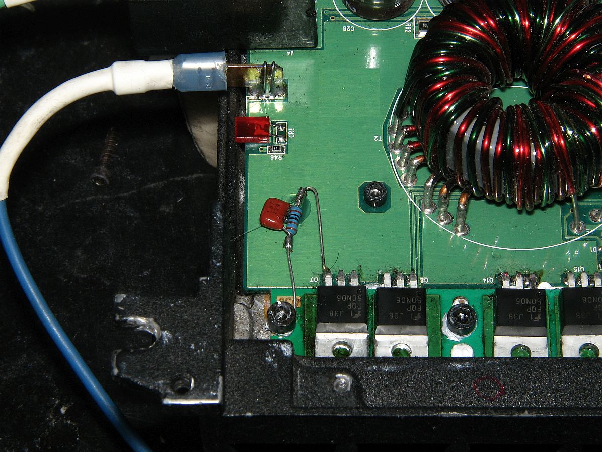

Have the scope ground on the ground for the 12v power supply. Touch the probe to a bare spot on the heatsink. If you see a lot of noise, connect a 0.1uf cap from a heatsink screw to a good ground. Below is one example.
