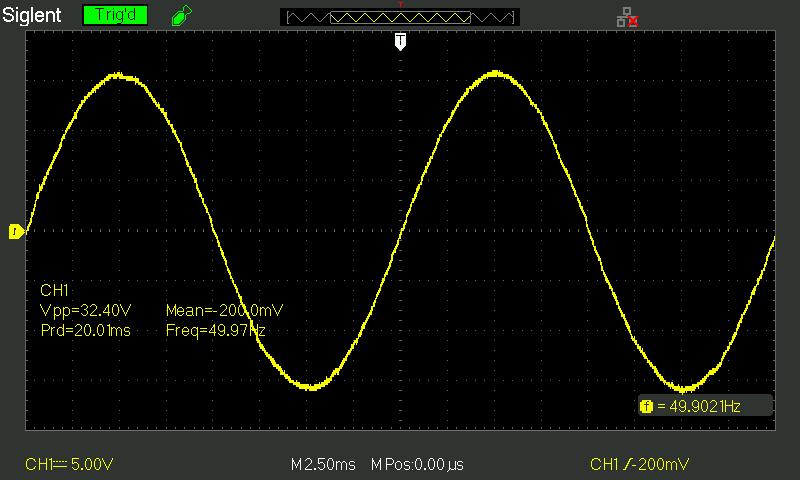

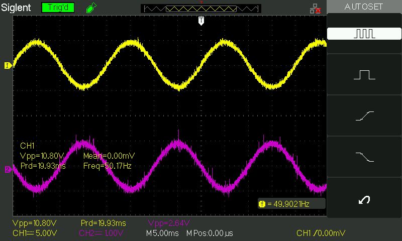

Post images (rch, at least) with the timebase set to 2ms, the vertical amplifier set to 5v/div and driving a 50-100Hz signal into the amp. Drive enough signal to fill about 3/4 of the display.
Hopefully this is correct. This scope seems to skip from 1.00ms to 2.50ms, no 2ms option. Pictures are right & left channels
There seems to be distortion in both channels on the lower half of the signal.
The 2ms is simply a standard setting. What's generally important is to have about 3 complete cycles on the display. It's OK at 2.5ms. If you wanted to get 3 cycles, you could alter the frequency. No need to do that here.
Do this again at .5v/div. Does the noise become visible there?

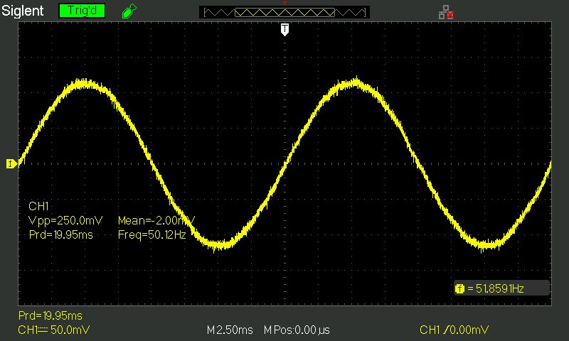

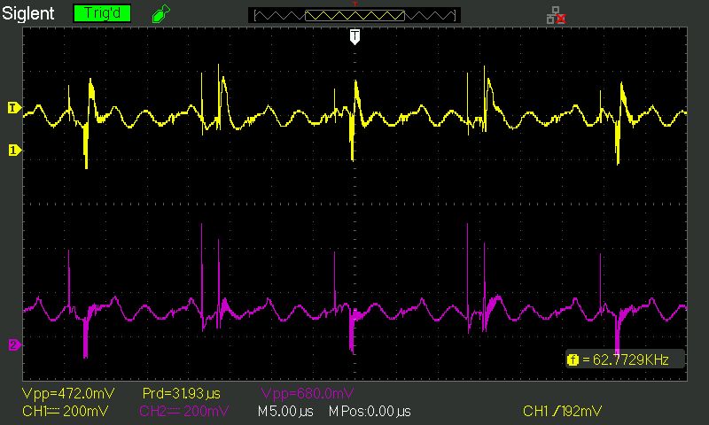

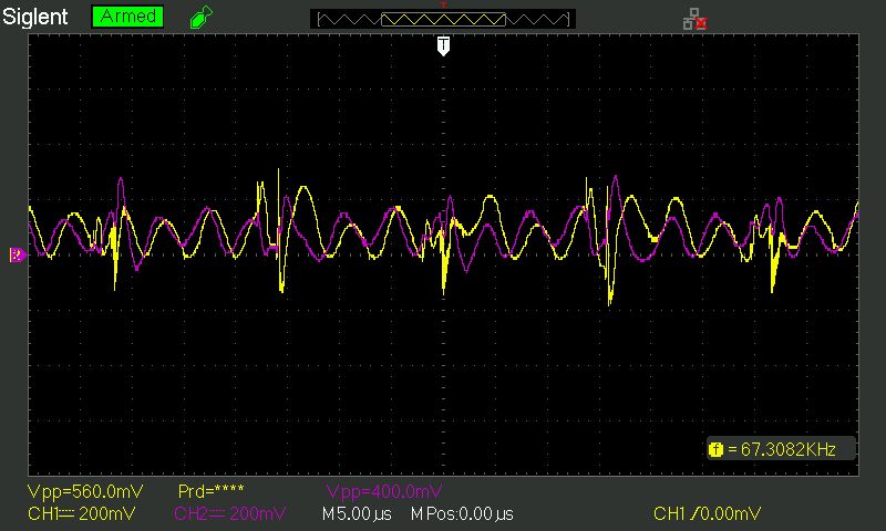

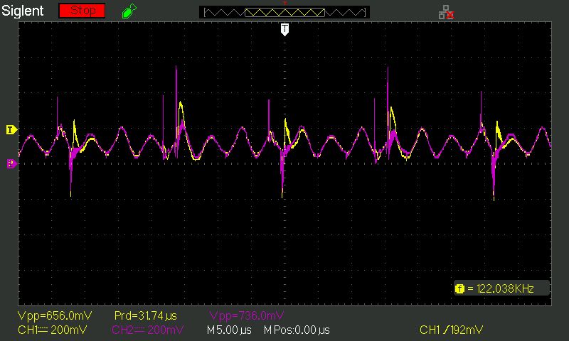

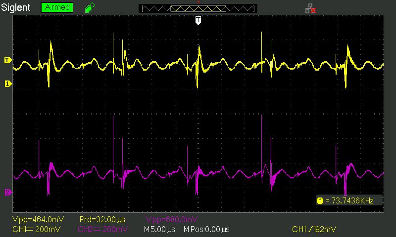

I feel like I have distortion with nothing hooked up to the scope. I don't know what's normal, yet. Should I be grounding the probe to speaker (-) or elsewhere? Here are right, left, and then the scope's own ground & 1khz point. The scope wouldn't lock on at 50hz at exactly .5v/div
You can't use the negative speaker terminals on both channels because one channel negative (right channel) has signal. You can use the grounded speaker terminals for critical measurements but having the scope ground connected to the 12v power supply ground is generally all you need.
I don't understand what image 3 is showing.
For reference, post the waveform coming directly from your signal source.
What noise are you referring to? The dithering on the top and bottom of the square wave?

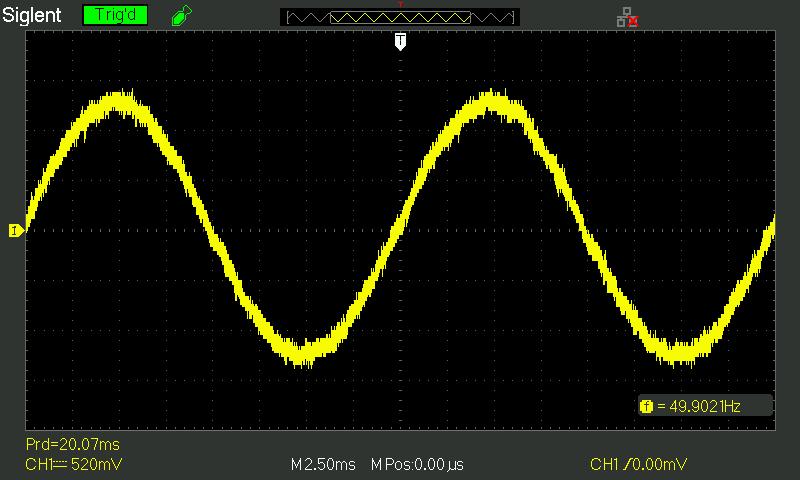

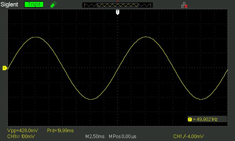

The voltage of the source seems adequate but it appears that it may have some distortion. It's hard to tell on this scope. Is there a way to filter the scope (with settings) to get a cleaner signal?
Yes, that's what I was referring to.

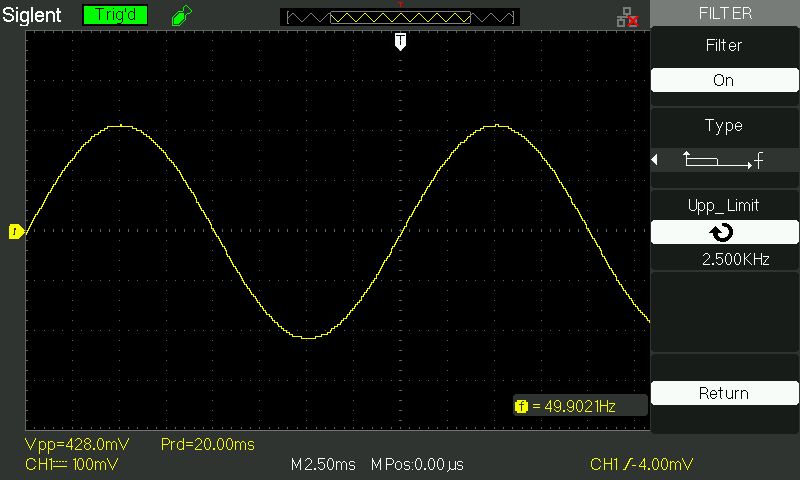

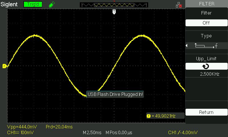

These pictures show the filter option I've found so far. Seems like I need a crash course in oscilloscope usage with amp repair. For this amp I was hoping to diagnose the elevated noise through the right channel with no RCA connection, and ultimately a clean output signal.
I don't see any noise. Was the noise present while you were monitoring/probing the right channel?
What sort of filter are you using?
Does the noise that you can hear change if you adjust the bias slightly?

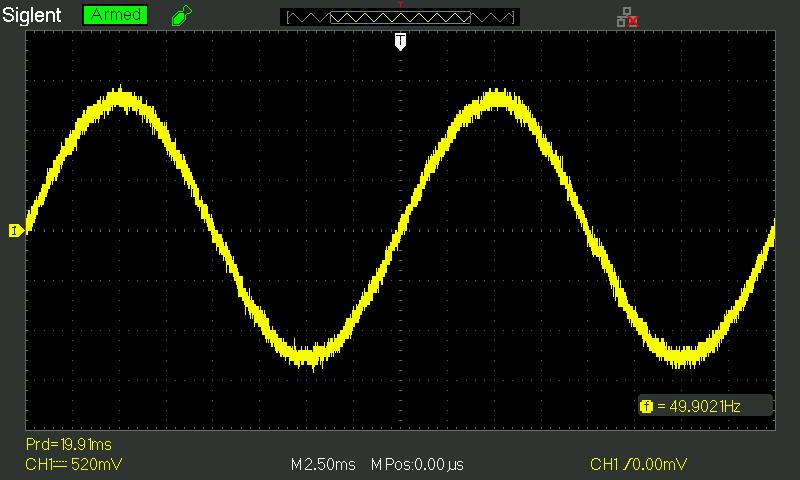

The first two pictures are the source signal with the filter on, third picture is with filter off. It was set to 2.5khz low pass. I'll check the gain adjustment tomorrow.

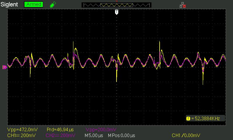

No change with bias adjustment, except that now I don't seem to have any more noise out of the right channel vs the left. Not sure if that happened before or after playing with the bias, but also there doesn't seem to be any significant change between RCA plugged in or not. At this point it's barely audible with my ear right up to the speaker.
This is what right & left channels look like with and without RCAs hooked up for the first two pictures, third picture is centered without RCA.
