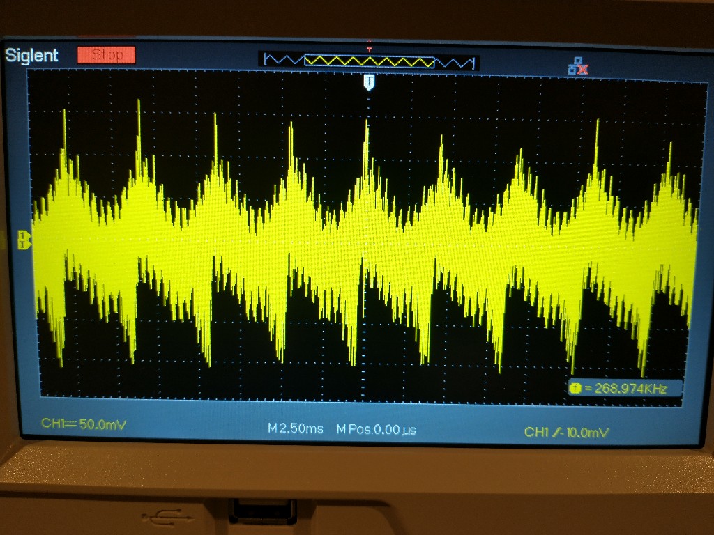

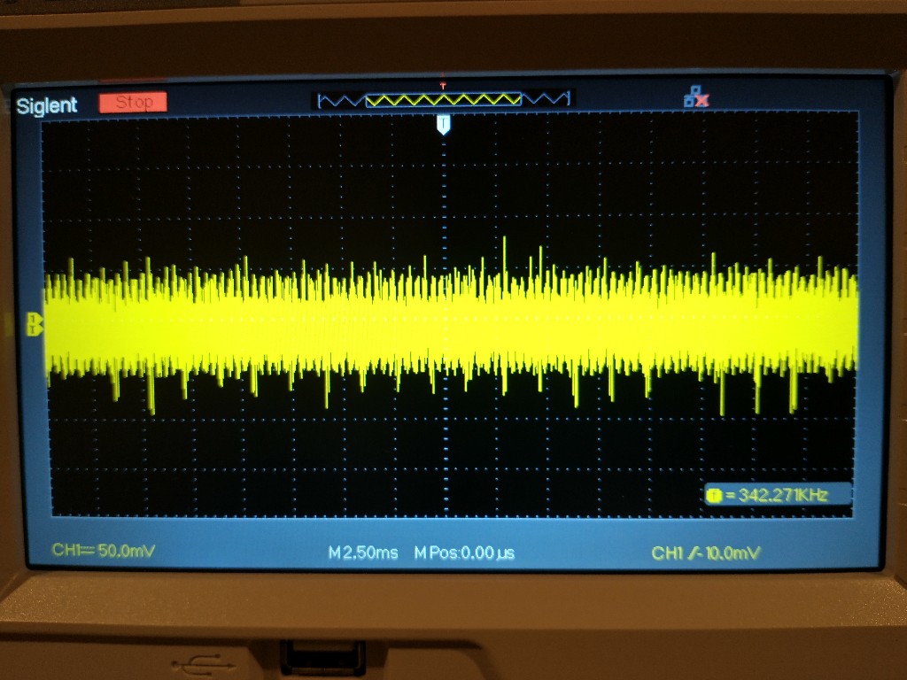

Do you see any oscillation on the bridging terminals of either channel?

I still don't have a scope. I've been looking. Got any rec's for one that isn't 30 years old?

Went ahead and picked up a Siglent SDS1052DL+ scope. I haven't used a scope in about 15 or so years 🙂
