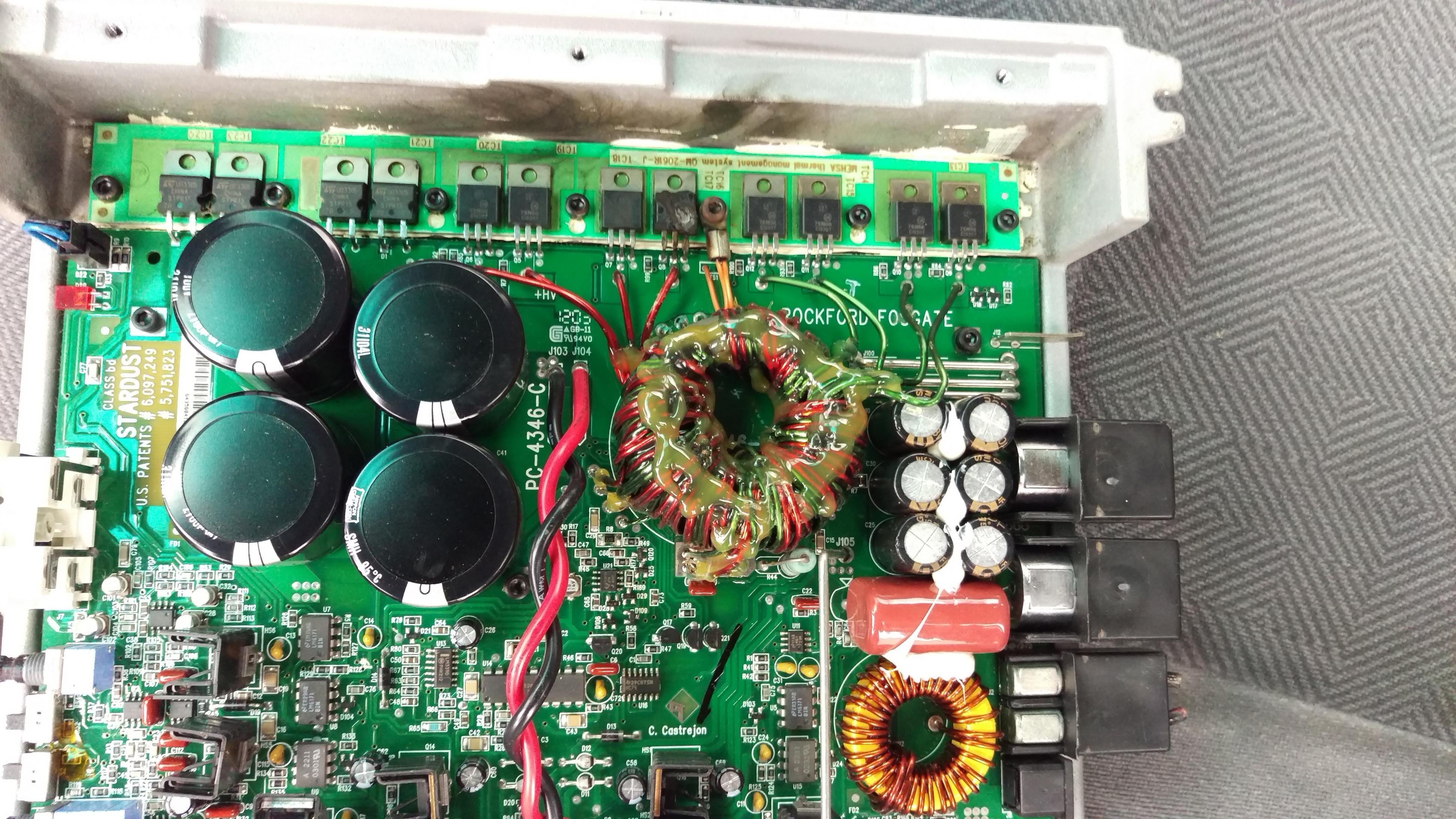

Ok So i fiqured out how to make my own thread (thanks Perry) Years of computer knowledge and i couldnt find it.?? Anyway i have two rockford amplifiers which had blown out tc18 on both amp same fet? Same person owned both amps, no other eye level noticable damage to the boards, i just want to replace every mosfet on both rails and start fresh on both amps, but i want to make sure that there isnt further damage. So i used what i beleived to be good diodes from both amps to soder on to one board, still no power except on the fets is 10v. when i tested the twisted pair of wires nothing.

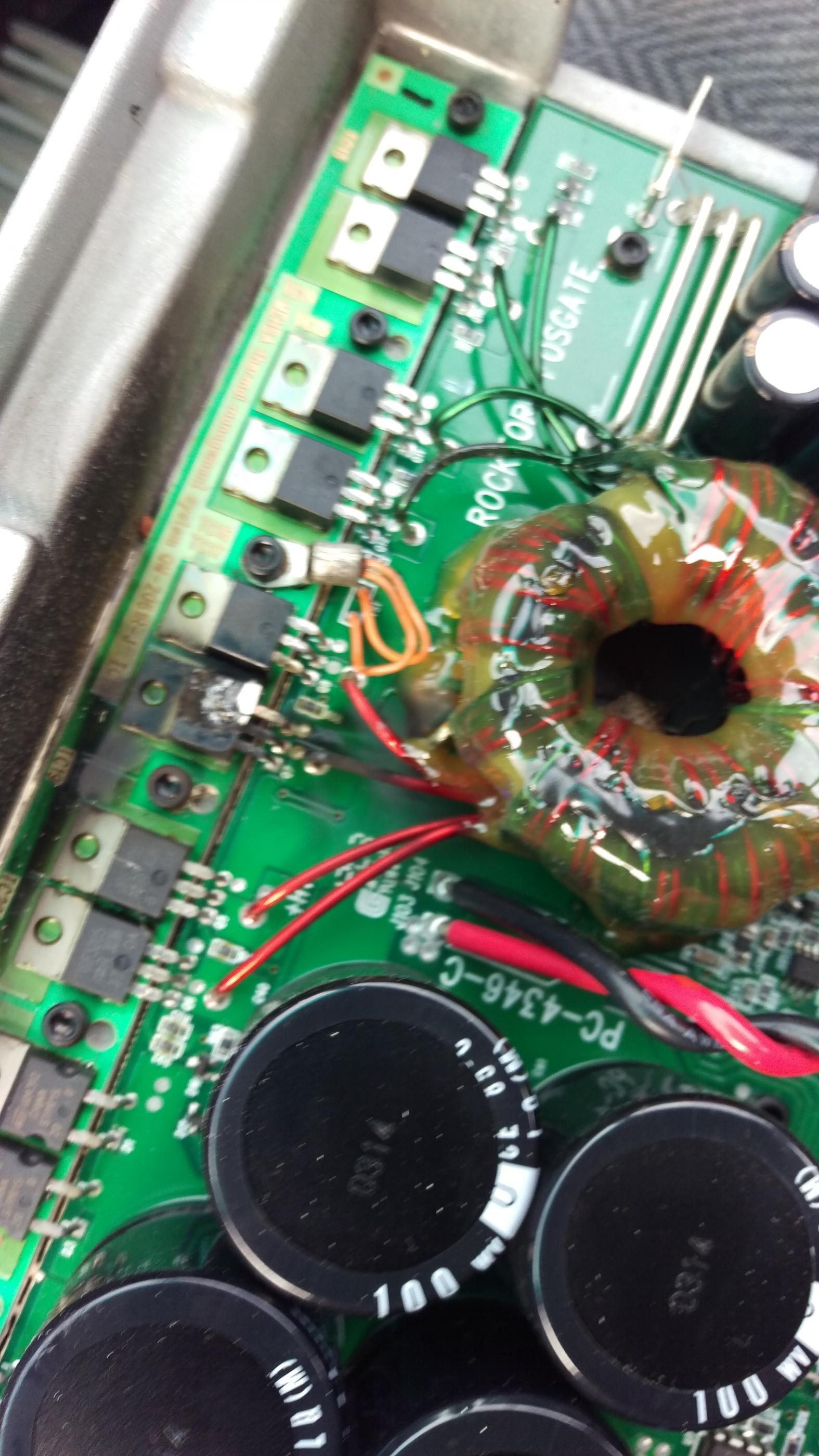

So I replaced just the blown fet and still nothing when I added power, no smoke, just no lights or power on the board. Should I test them for voltage while power is connected, or just the twisted pair of wires,? I didn't get any voltage on the wires
So when i put all the new fets on the power side and plug it up it make a crackle and damaged the battery.?
and i think it damaged the same fet. and yes they were bad i think. I couldnt really tell. so i just changed them all to be safe.

Connect only remote and ground and measure the DC voltage on all 8 FETs. Post the voltages along with the circuit board designations (not the TC #s) for the individual FETs.
If the drive circuit was not intact, changing all of the FETs could result in all being blown.

Ok So i did what you said and got these volts:
Q6 8.64
Q5 8.63
Q7 8.64
Q8 0.86
Q12 ZERO
Q11 ZERO
Q10 ZERO
Q9 ZERO

Q6-8 likely have a blown PNP driver transistor.
Q8 appears to have an open gate resistor.
Q9-12 appear to have two blown driver transistors.
You will need to replace all 4 driver transistors and all open or out of tolerance gate resistors.
Pull the 4 driver transistors and check the resistance between the gate leg and the other two legs. They should read infinite resistance with the drivers out of the circuit. If they do not, post the resistance read across the FET along with its circuit board designation.
Do NOT connect B+ again until told to do so.
