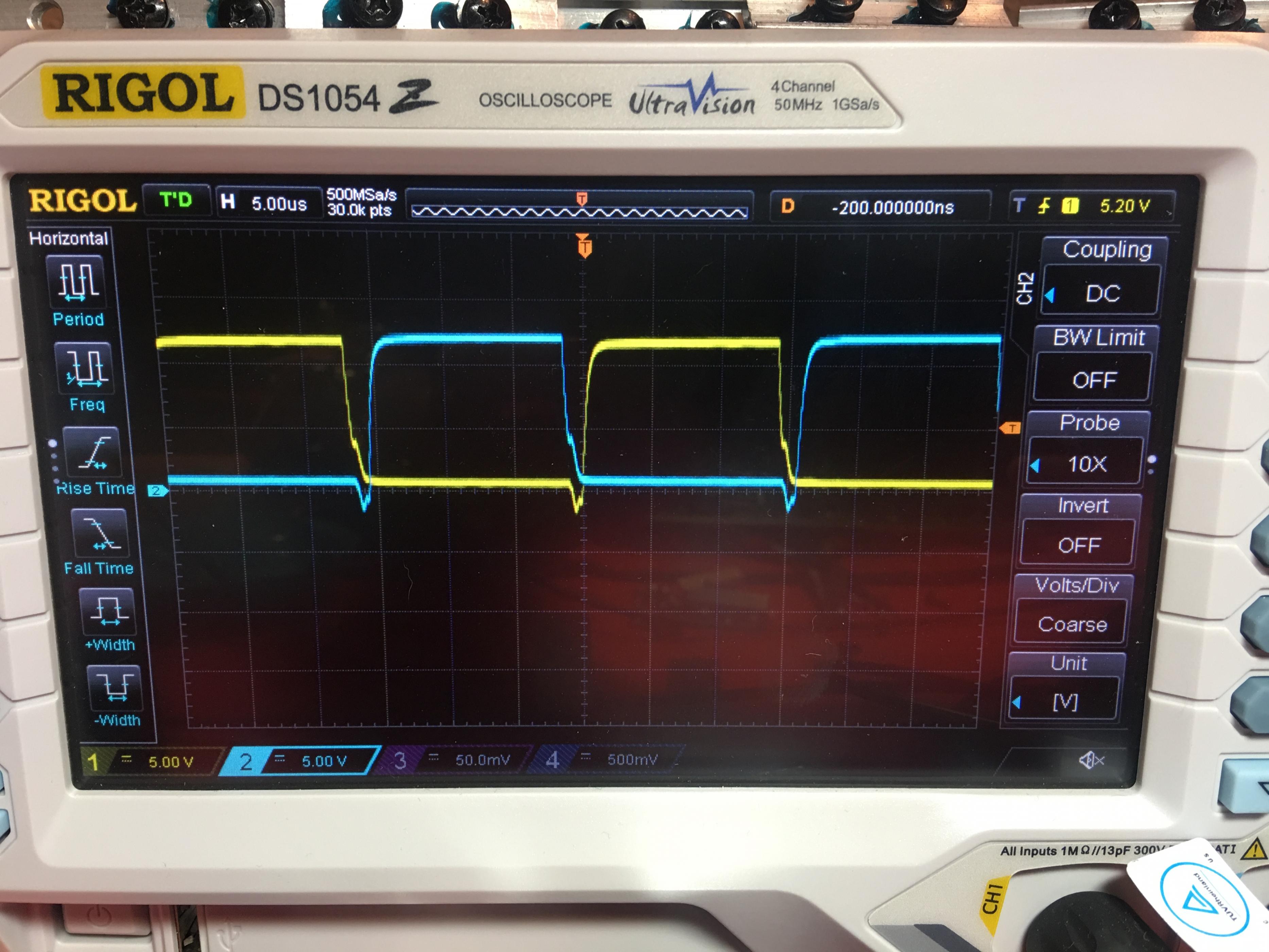

If you reduce the 12v supply voltage so that the amp supply remains at full duty cycle, does that make a difference?
How is the drive voltage changing when there is no change there?
Does the amp draw more/less current as the drive voltage changes?
Go higher than 14v to see if the duty cycle drops. I think it should happen at about ±33v.
