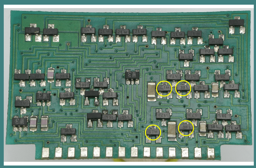

Check the 33 ohm resistors on the driver board.
Which driver boards do you have (all resistors on one side or mixed)?
I don't have the tutorial. The boards have all the resistors on one side.
Two 33ohm resistors per board all test okay.

The forum member seankane had some replacement driver boards at one time. You might want to message him to see if he still has the replacements.
Since the problem could be elsewhere, you could swap the boards (left/right) to see if the problem follows the board.

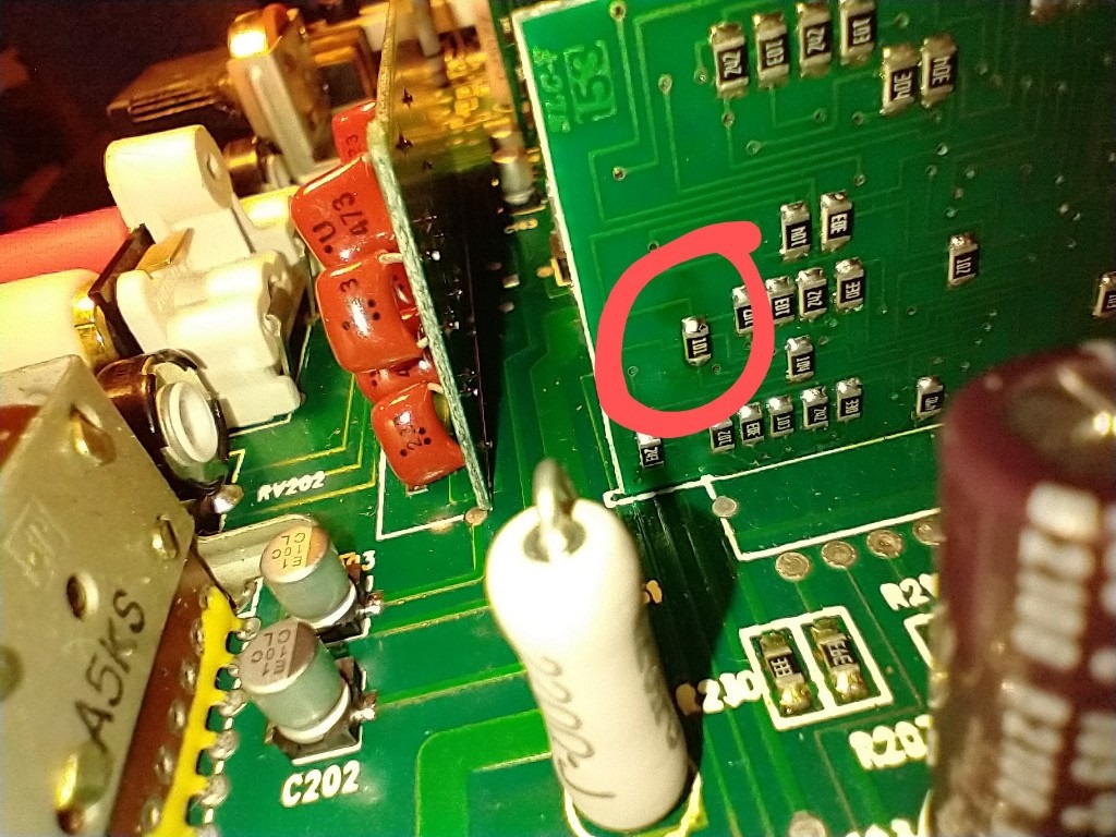

I did talk to Sean, and he has the boards still. I was able to find the problem on both boards. There was a 100ohm resistor with a failing solder joint on the left channel causing the breakup, and a 3320ohm resistor with a failing solder joint causing the change in amplitude on the right channel. Interestingly those two resistors are basically in the same mirrored position on the amp, at the bottom of the boards closest to the output side of the amp. After reflowing the solder on those I can aggressively flex the boards without any change on the scope

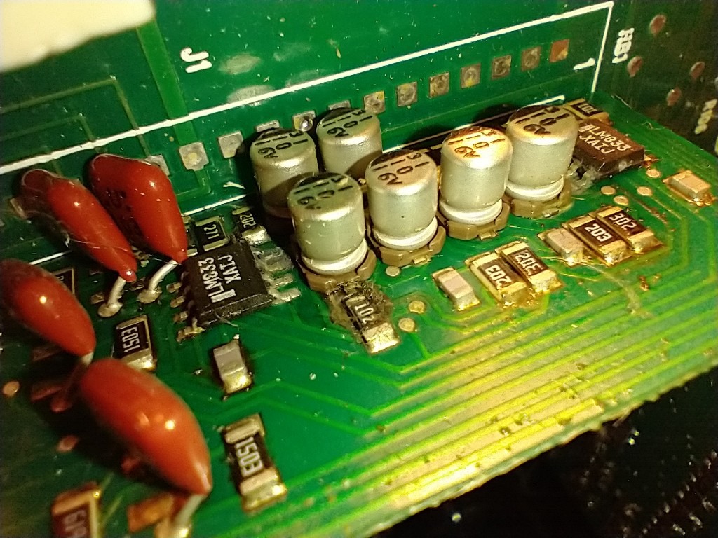

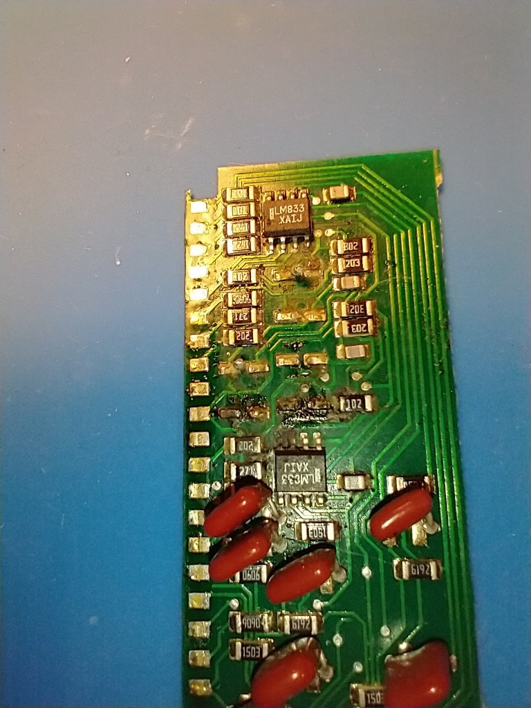

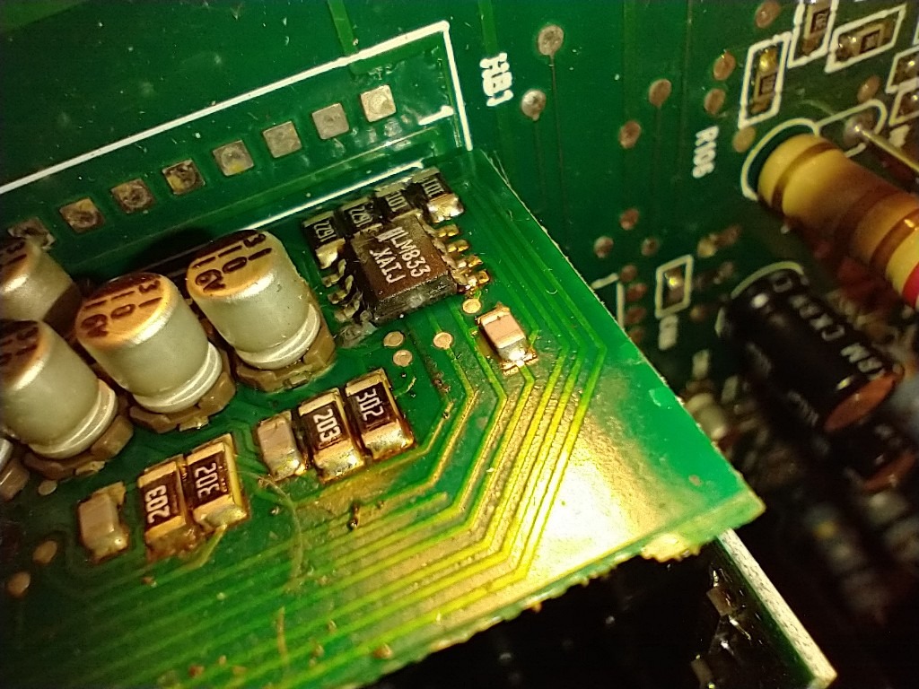

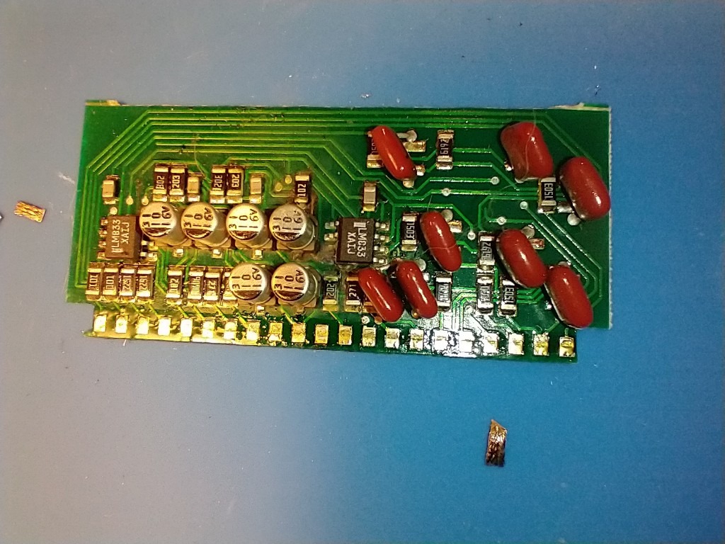

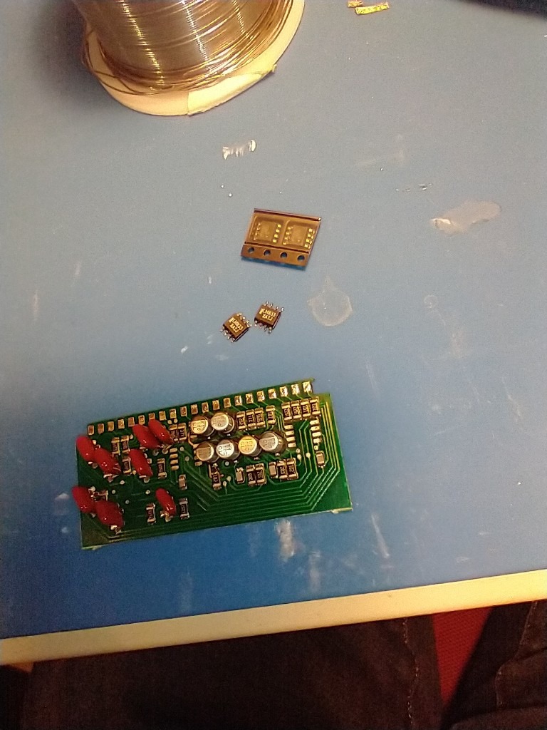

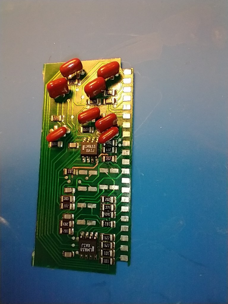

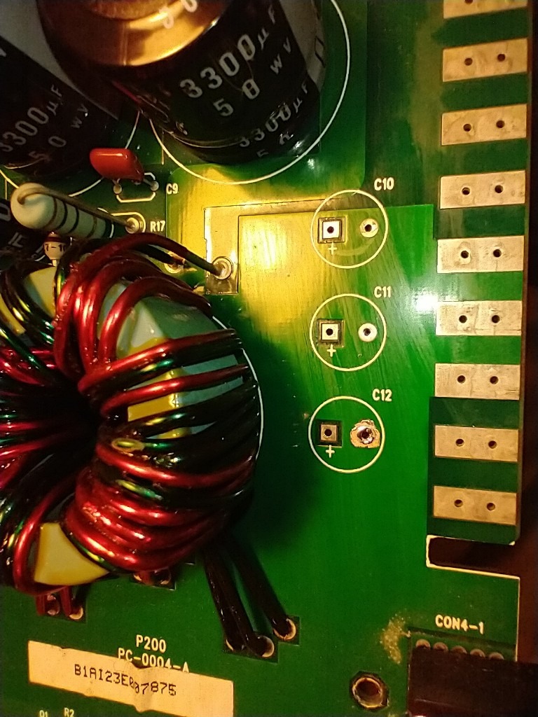

For anyone who might end up looking for answers, here are some pictures of part of what this amp needed for repair.
Replace leaky caps & clean, new gain pots, replace broken RCA block, reflow remote tab & various other spots, replace LM833 op amps...

For those repairing these, ALL of the 10uF@16v SMD electrolytic caps in the amp must be replaced and the board must thoroughly be cleaned around them with acetone or a similar solvent. Any trace of electrolyte will be corrosive and conductive and could cause strange problems.
