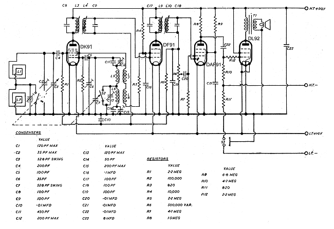

Hello all.
Has anyone know of a schematic that uses DAF 91,DL94,DK92,Df91 or some of them for a guitar amp.

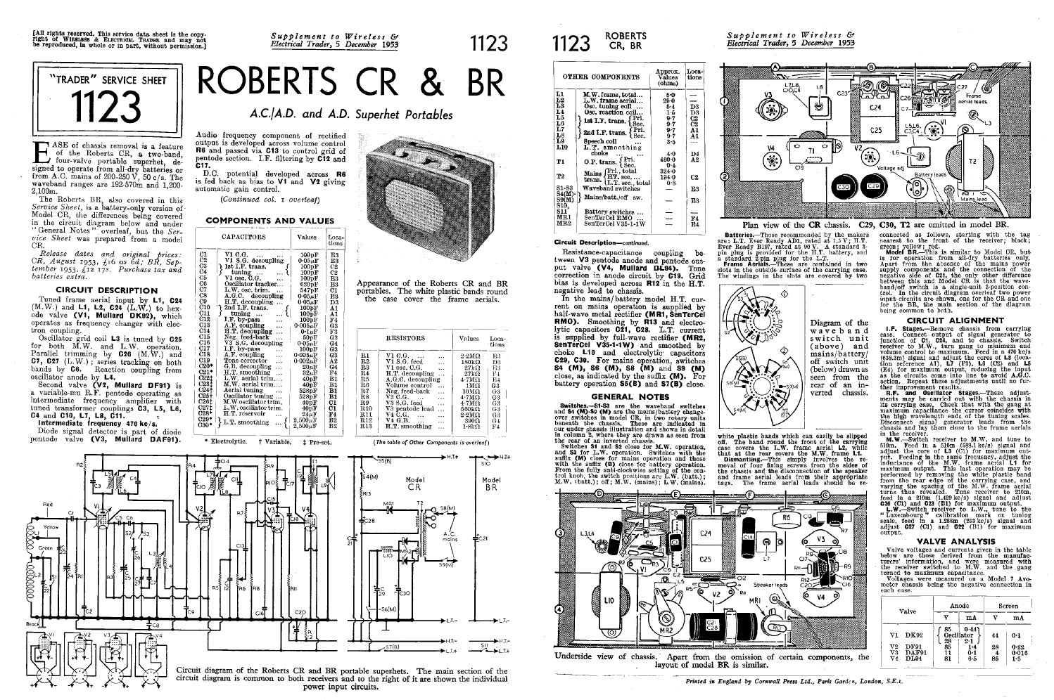

I have a Roberts CR portable mains powered radio that I would like to convert
Thamks
Pretty simple, just go in on the top of the volume control - and see how much gain you get. I don't recall there ever been Roberts valve portables (or Roberts valve radios at all?), perhaps they were pretty rare beasts?. I repaired lot's of Roberts radios 'back in the day', but they were always the poor mans Hacker 😀
However, I wouldn't expect much power out of such a tiny amplifier.
> guitar amp. ..... Roberts CR portable mains powered radio that I would like to convert
1) Is it safe?? Most post-WWII domestic mains tube radios were HOT CHASSIS. This is safe as long as you can not touch the circuits (all wood/plastic case, radio waves in, sound waves out). A guitarist holds a wire to the circuit all the time s/he plays. DANGEROUS.
In this case, the Roberts BR *does* have full transformer isolation, as you already stated. But you always want a second pair of eyes just to be sure.
2) are your expectations realistic? Home radios are moderately loud in a home. Battery radios are less-loud to get useful battery life. The DL94 makes less than 1/3rd Watt semi-clean audio output. It won't fill Wembley Stadium or out-shout a drummer. But it is frequently reported here that a 1/4W guitar rig is VERY LOUD in an average home.
Any radio is a radio tuner and an audio amplifier. There is NO reason to tear it apart! Replace the tuner feed with a guitar jack. As said, go in the top of the Volume pot.
Sensitivity at radio volume pot is usually 50mV-100mV. A classic guitar amp is around 20mV. Modern guitars can easily deliver >100mV, so you get the whole part-Watt you bought. If it seems like hard work to slam the poor DL94, add some kind of booster-pedal in front. You could alternatively re-wire the IF tube as a preamp stage, but it is a lot of work for the small benefit.
Thanks all. The tuner section only just picks up 2 stations and i like a low power amp, It uses a selenium rectifier and I would like to change diodes and I know I would need to add a resistor to keep the ht below 90v,anyone an idea of value ,thanks
