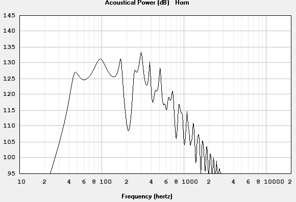

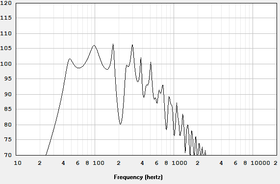

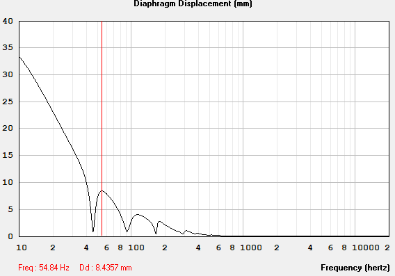

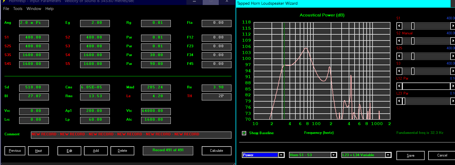

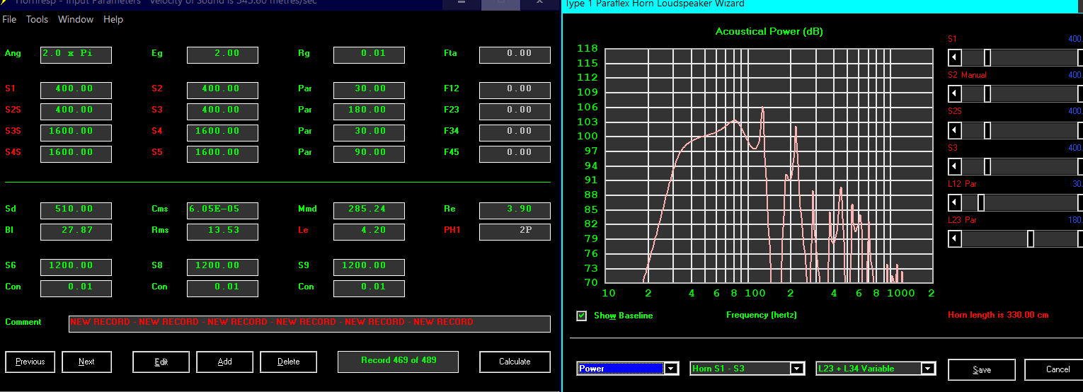

quite sure theyre loud AF at 100 hz but the underdamped peak at Fb in the lossless simulation is likely lackluster in reality?
i dunno? Hoqw stuff doesn’t seem to make very potent SUB woofers, instead makes a bunch of mid bass noise?

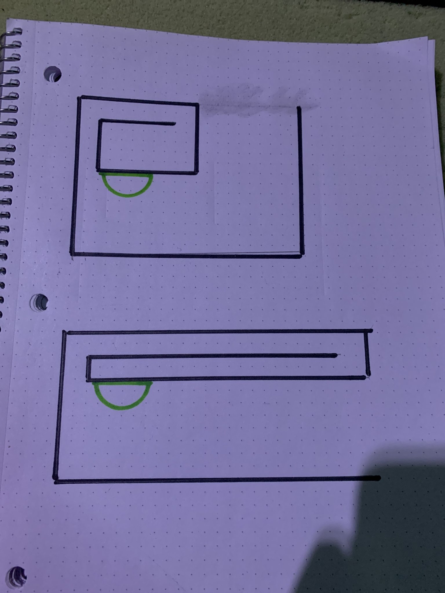

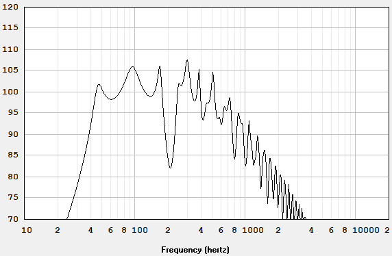

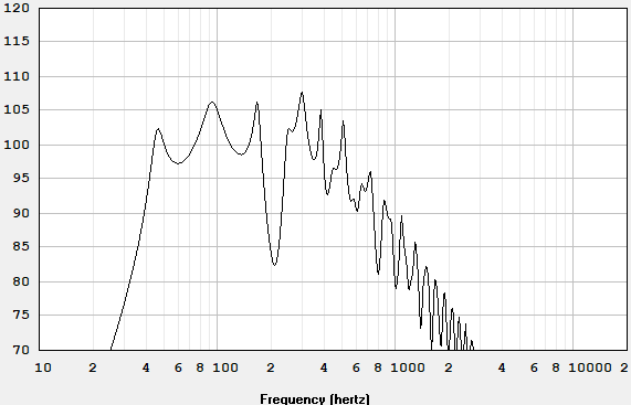

ill stick with my big long 4:1 tapered taped pipes (fancy bass reflex) junk that gets super low and with authority ??🤷♂️
