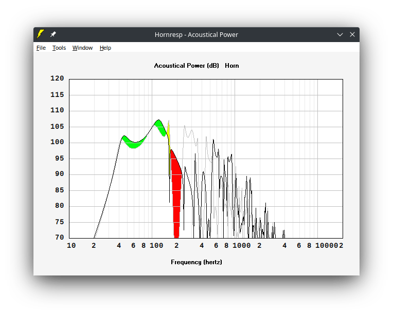

Hello laxandredeyed,
To support your decision to build or not more ROAR box, find attached an Acoustical Power chart comparing the Roar design vs Paraflex C design considering the same total box volume and also the same driver.
Green = Paraflex give you better output
Yellow = Roar give you better output
Red = big dip in the upper bandwidth related to ROAR design and you saw it in your measurement.
In addition, ROAR has total of 13 panels vs 10 from Paraflex C vs 8 from Manifold, witch gives better response compared to both ROAR adn Paraflex C. Looks like Band Pass 6th Order Parallel is the way to go if you want more SPL, otherwise TL/MLTL variants gives you wider bandwidth compared to a conventional vented box for the same box size.
Find attached the 3D and also hornresp input data.
ROAR total volume = 320L
Paraflex C total volume = 319L
Driver = Snake HPX2150
Consider that each single cabinet delivered good response on the time it was designed, think about SuperScooter for instance, but hornresp has been improved and new designs has been explored, so, today you have better options. But personal tastes needs to be considered and we can't see that from charts but ROAR and SuperScooter suffer from the same issue related to the DIP.

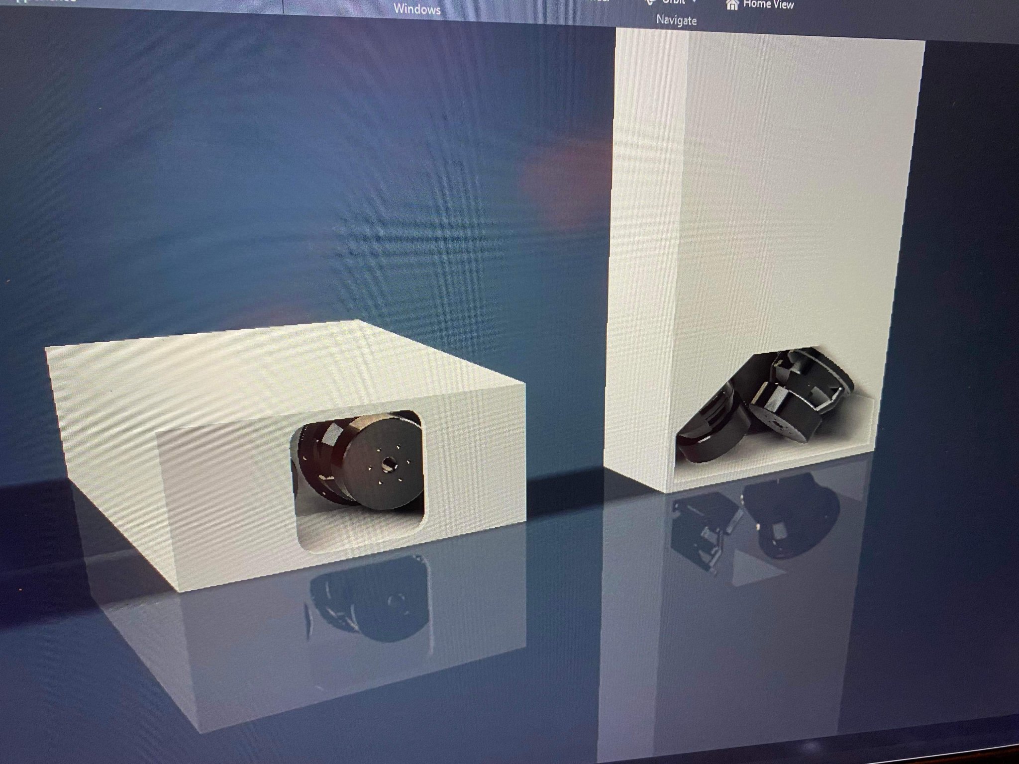

find the ‘perfect’ but very tight /damped TL for the driver and fold it in half then take the cross-sectional area.( Multiply times four ) and use half that same length , as your waveguide.
Offset your driver from the closed end do not just fire these as a single from a dead end every time to see better results
same approach to paraflex, but split that big resonators crossectional area between the other side s output and the last of 3 parts which make the longer path.
this never fails … (length first), then volumetric ratios(csa 2:1 in csa split in paraflex and 4:1 in roar. But at 3:1 (paraflex) and 3 total in that folded qw resonators Top veiw
I couldn’t keep up with demand if I was to ‘sell’ these…. It’s rediculously ‘loud’ and deep ….(these hold a record currently in a 20 hz morph in car audio from father/son (phatboys) from Oakland, california) Try a real driver with some respectable and potent TS parameters instead. It’s like you want you cake and eat it to.. but with whipped cream, cherry and your favorite ice cream 😆. …. Well, then put in the right ingredients? And keep it Simple!!

maybe shrink these resonators down to 4x the TL section csa instead of these obnoxiously overwelming spl grabs(paraflex is awkwardly huge too often it seems and it’s not even half as big when they ran into ratio issues ) that bias the top or dilute the akready underdamped? It’s too hard to tell with these weird driver choices or lack of consistent info from people who dont share in diy anymore (thsnkfully you’re willing!)

Using these poor examples is misleading . Model them yourself and not such a wild undamped appearance by comparison which is like one note blunders… every time
It's OK to disagree, different people have different experience and they see things from different point of view, this is the nature of diversity. But looks like you post too many words and numbers but no real data, witch is not wise from your side nether respectful, what data supports your criticism?
Let's assume I made it the wrong way and you can do it in the right way, let us see your comparison, chose your box volume and driver, post your Acoustical Power chart comparing ROAR and PARAFLEX C, attach your Hornresp inputdata as txt for both of them, and also post your CAD files for both, because we need to certify that your simulation numbers correlates with real box. Let's us see if your data leads to a different conclusion.
Let's assume I made it the wrong way and you can do it in the right way, let us see your comparison, chose your box volume and driver, post your Acoustical Power chart comparing ROAR and PARAFLEX C, attach your Hornresp inputdata as txt for both of them, and also post your CAD files for both, because we need to certify that your simulation numbers correlates with real box. Lets us see if your data leads to a different conclusion.
