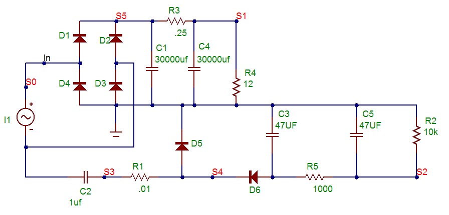

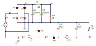

If you have a small low current negative bias voltage available, you can use
it to bias the Fet through the feedback loop and this way you can run the
Fet without degeneration.

Without dual rails, that is going to require a second trafo and PSU, correct. How much is enough and how do i come to that figure? Would a bootstrap cs perform better than DeLite setup? How would it compare to version in previous question, which i believe would be the illegitimate cousin of the F2. Sorry about all the questions
