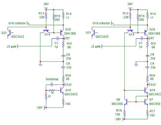

OK, tried to rush the first attempt, and forgot to add the bias circuit, and put the bootstrap cap in the wrong place. As soon as I posted, I realized it was nonsensical, but my doodled model had mistakes too. Finally got back to it. So, is this what Mihai was talking about? If it's not at least kinda sorta close, I'm officially in over my head.
I'm really going to build the SE VAS version. Don't know about the bootstrap, as it really doesn't save component count, though it does eliminate a couple of transistors. I at least wanted to understand it, though.

I make big efforts to decrease components count but without loose sonic quality.
I will compare two version of this type of VAS. The one as in posted schematics and the other without mirror and with a simple bootstrapped 3ma CCS form the (-) rail to folded cascode transistor.
Interesting to know what is the result of comparison of VAS without current mirror?

Would you be so kind to allow to ask you to publish a schematic without current mirror?

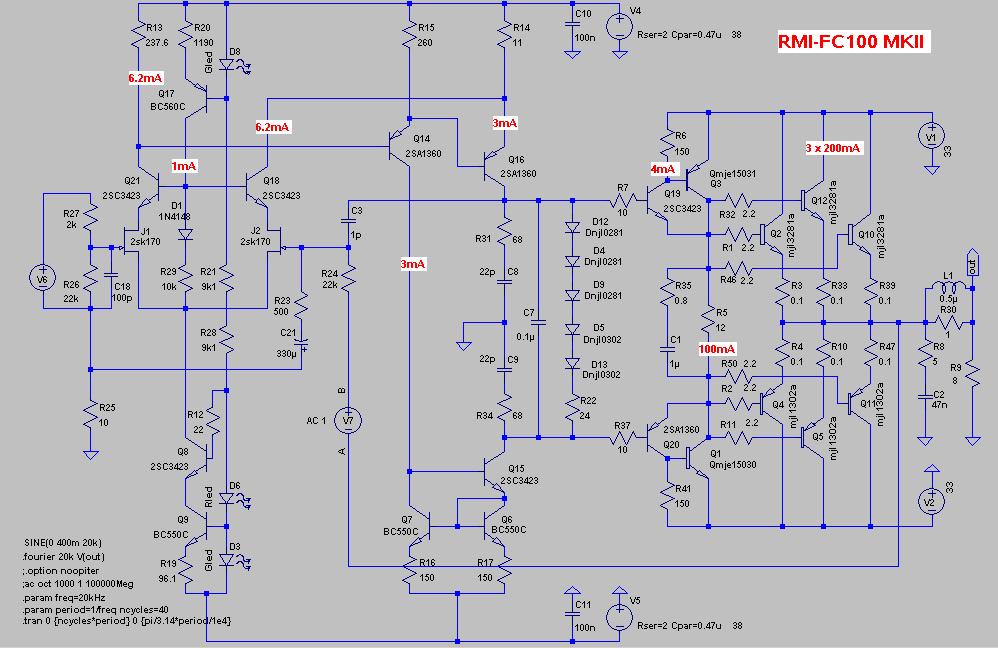

- RMI-FC100 MKII, single ended folded cascode VAS
