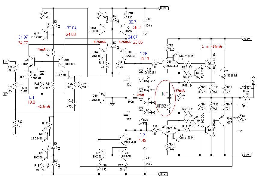

Did you try with 170mA bias like original design?
I think, Mihai post somewhere in theme, respectful explanation for this...
I'm glad that you finish amplifier! Good choice you make!
I am running 200 mA bias per output transistor.

I have chosen 200 mA which is on the high side of the range, I will go back and have a look at Mihai's post again.
I do have a little extra room in the case (on purpose)
There should be no problems there. Those sinks are good for at least 150W a side I would guess.
Myself, I can't really tell when I'm in and out of the class A, so I am thinking of using the biggest Re recommended and turn down the heat as much as possible. Nobody mentioned anything above Re=0.22, but I am guessing you can go even a bit higher without affecting the sound.

I blew a channel. It looks like one of the outputs wasn't screwed down tight enough and over heated and blew, it's clearly blown. It's an NJL0281 and I will probably have to check the drivers Q19 (2sc3423) and Q3 (mje15035) as well as the other outputs. Does anyone have a matched set of NJL0281 transistors to sell? Would it be a problem if I just dropped one in or should I buy a few and match them?

I have two NJL0281's left over from my RMI-FC100 project. Don't know if you are aware of it, but there was a problem with the thermal sensing diodes in the early production of these devices. In production, wrong diodes were installed in the devices making it difficult to set the bias. The irritating part is that these devices were not withdrawn from sale and were being delivered many months after the defect was discovered. I suspect the devices I have are in this category.

I have 3 x NJL0281DG @ hfe of 147 (all 3) with internal diode Vf @ 530 mV, 530 mV, 529 mV

I have built two channels of the FC100 amp using ZDR's PCB's. When I powerup the front-end PS, all Leds are on but the voltage over de Diode string is not highe than -1.40 VDC. This is not enough to set the bias current.
I have double checked everything but found no errors. Both cahnnels act in exactly the same way. I have also checked voltages and currents according schematic on page 136 of this thread, measured values are all very close to what is stated here.
Enybody any ideas or advice on what else to try to get voltage over de diode string on target (1,5 VDC)
