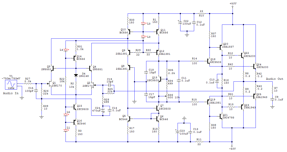

RMI-FC100, a single stage audio power amplifier
Look up the symasym schematic. Replace the FC-100 diode string and pot with the symasym's BD135 (or similar) and the resistive divider to its base.

Isn't it possible just to replace the diode string with NPN only base to emitter junctions and make it like this: http://www.diyaudio.com/forums/soli...gle-ended-folded-cascode-vas.html#post1621315 regarding pot?
Alas BD135, BD139 have TO225 Style1 package (emitter-collector-base). I think better will fit TO225 Style3 (base-collector-emitter), but I only found MJE13003. Do they need to be thermally matched?
Thanks for reply.
You could use most any diode, if you want to do it that way. Ideally, they will match the temco of the thermaltrak diode. Perfect match is not strictly necessary, but should be reasonably close. You could use the holes in the PCB for that purpose, but I don't see how you are going to get them fastened to the heat sink. Easier to mount them on top of the output devices, and just run wires to the transistor/diode terminals, in which case it doesn't matter what the pin orientation is.
There is no pot in the link you show. But I assume that the bias was set with a pot, the value determined, and a resistor substituted for the pot. You can do that with the standard version if you like, and if you don't intend to change the bias point.

I've remade a layout to fit TO225 Style 3 on the heatsink. But if it's not necessary, can I use mur120 or any other equivalent diode is the spare holes of the PCB without fastening them? Are you refer that I can change the pin orientation by wires or it doesn't matter what the diode string orientation is in the schematic?
Regards.
Regards.
I was assuming that you are using Mihai's layout, which would make it mechanically difficult to solder transistors or diodes to the board and also attach them to the heatsink. But if you have to change the layout to account for the pinouts of the new output devices, then it should be possible to make the necessary changes to accommodate a diode.
The diode electronic orientation, of course, matters. It must be as shown on the schematic. But if you are not soldering the diode directly onto the board, and instead connect them with wires, then the mechanical orientation is flexible and you can use any suitable form of diode. If you are redoing the layout, then I would suggest that you arrange it so that the diodes sit directly on top of the output devices (except for one, as you need only 5 diodes).

There is no reason to use an external diode string for the Vbe thermal compensation. It is complicated to mount and there is no advantage from thermal tracking point of view. Instead, use a classical transistor based Vbe multiplier mounted on top of one of the power transistors, like in the AKSA design.

What is preferable, attach diodes to the heatsink or place them on top of the output devices?

No advantage even if I can attach diodes (base to emitter junctions) to the heatsink (I made it as MKII layout)?
The advantage of the Thermaltrak devices, is that the diode is on the same die as the transistor. Therefore it closely tracks the transistor temperature. The further away it is, the more it lags behind the transistor temperature. So if it can't be on the same die, then mounting it (or a Vbe multiplier) on the output transistor is next best.
Isn't that exactly what the designer just said, or is there some misunderstanding?
Vbe multiplier might work hot.
Why would it work hot? It's not dissipating any significant power. It's simply working against temperature related bias change.
