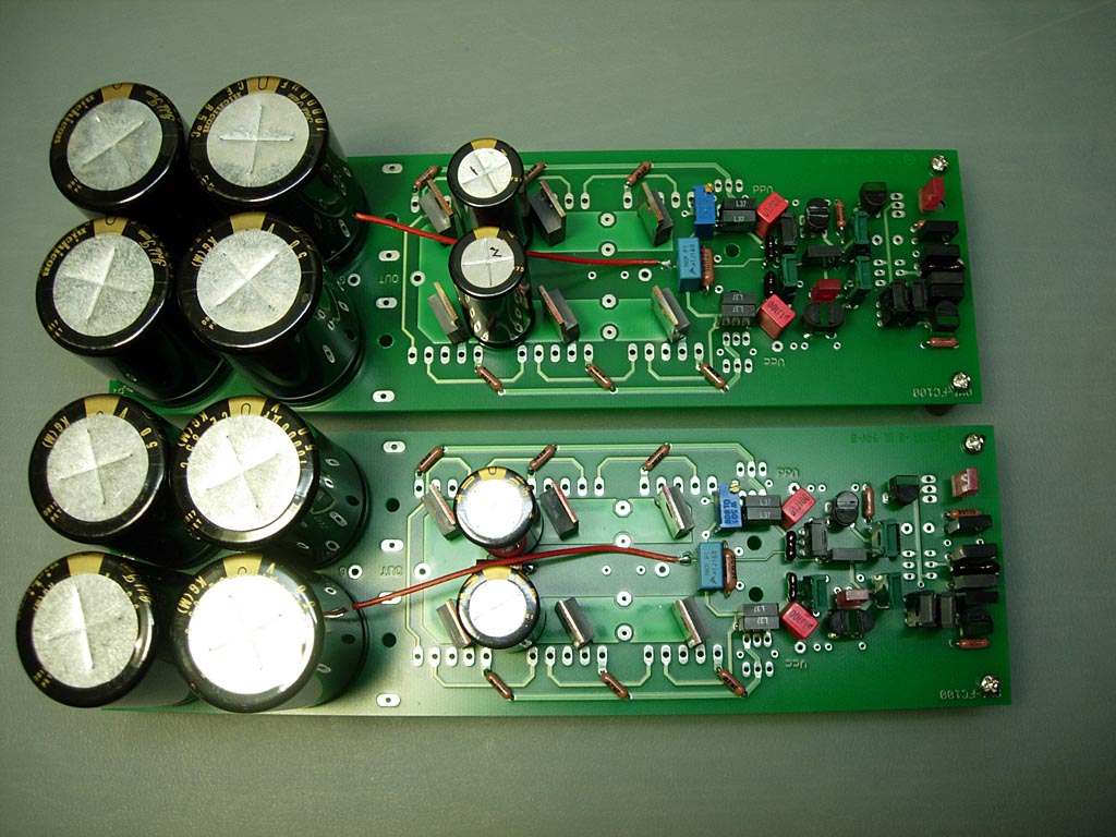

Sheldon,
Roender mentioned in his BOM:
"D2, D3, D8: Green LED type LT433B or any other rectangular LED with Vf>=1.9V at If=5mA
D7, D6: BL-R5122B.RED or any other rectangular red LED"
Could you please let us know what's your choice of red LED, at what Vf and If?
Thanks.
Been out of town for awhile. Best way to answer the question is to look at this picture:http://www.diyaudio.com/forums/atta...c100-single-stage-audio-power-amplifier-4.jpg
Sheldon

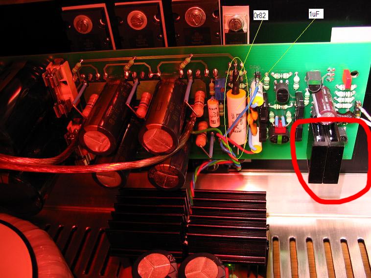

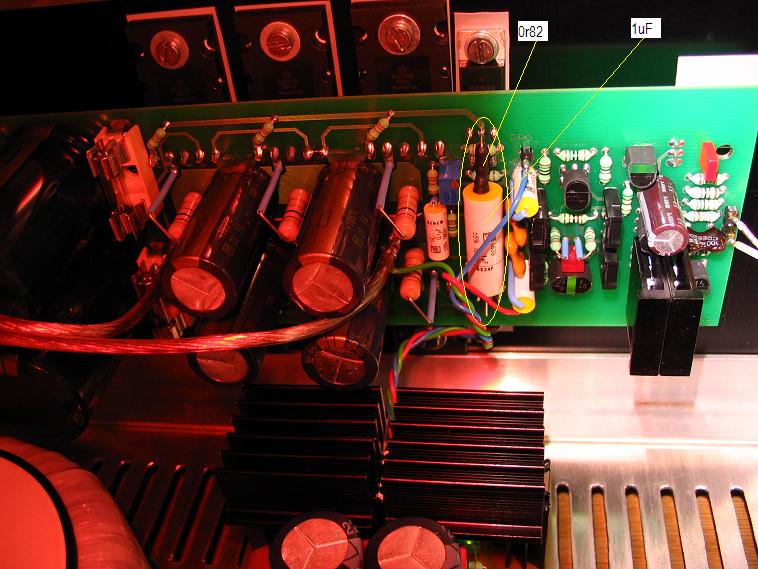

Thanks, Sheldon.
I found this picture a couple of days ago which might be a better representation of the answer to my own question.
http://www.diyaudio.com/forums/atta...stage-audio-power-amplifier-rmi-fc100v1.1.jpg
But I still can't figure out what's the black thing enclosing D1, Q18 and Q21. Is it some sort of heatsink? 😀
