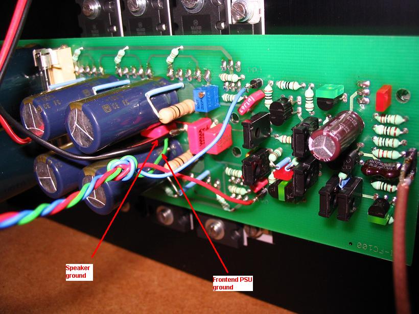

Success.
Thanks for all the suggestions.
The front end works with the Zero Volt reference from the lab PSU Zero Volts to the main PCB ground and then through that 10r to tie the jFETs Sources to near zero volts.
The question becomes: Where do we connect the Low Current regulated PSU? Which end of the 10r gets the reg return?
BTW,
I soldered the old matched pair back in.
BTW,
If the output from your regulated front end PSU is really clean, then would the reg ground be better attached to the signal ground?
The front end sends almost zero current to the front end Zero Volts connection. What influence would this have on the cleanness of the signal ground?
Missing out the Zero Volts connection shows that the front end is susceptible to noise voltage on the signal ground since the source voltage of the FETs is intimately tied to this.
Or is this back to front logic?

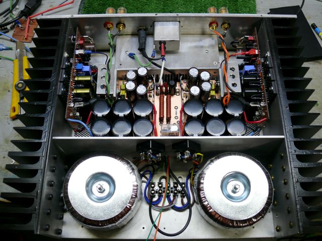

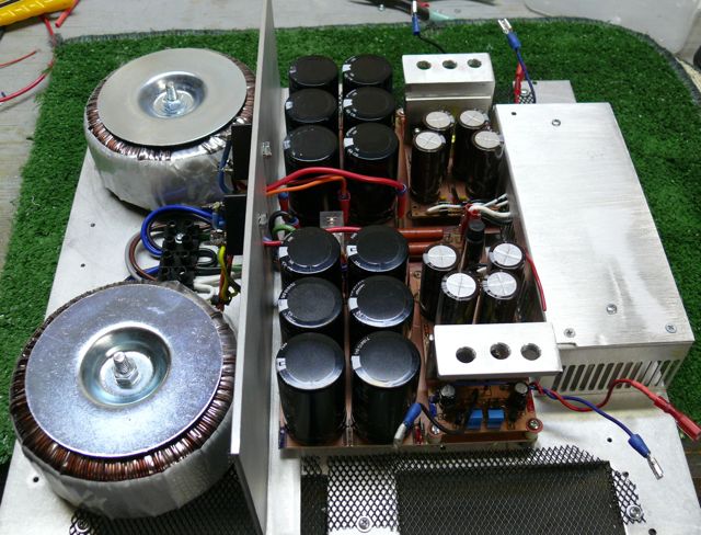

DRZ1 said:main board with the soft start
Denis,
Nice work, keep going!
How big are your transformers - more than 200VA? It is really necessary a soft start circuit?
Mihai
240 VA each.
I think it's more the filtration than the transfo capacity that determine the need for a soft start.
with 60,000uF per side i think thats better with a soft start. But mine is simplest as possible, 100 ohm in series with the two primaries (115V) and when the supply reach 70% of nominal value, the relay short the resistors.
With this set up i dont have this famous HUMMMMMmmmmm at the power on.😀
well done.DRZ1 said:With this set up I don't have this famous HUMMMMMmmmmm at the power on.😀
I suspect you also gain the advantage of using a relatively low value of mains' fuse.
Two gains from one simple add on.
I wish more would think about what they ask of mains' equipment.
