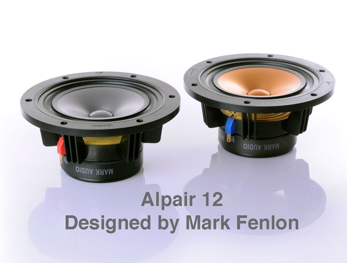

Hi Guys,
I'm glad to work with Bob Spence. The collaboration is welcome and very interesting. The Alpair 10 drivers in Bob's Elation's have a slightly different cone coating, thus changing the mass. Spider and front suspensions are have small differences compared to the standard Alpair 10.
I've just packed a pair of Alpair 12 and a pair of Alpair 7, sending to Bob Spence today. I'll be very interested to know the results once they are installed in the Affirm horns.
Mark.
Mark.
