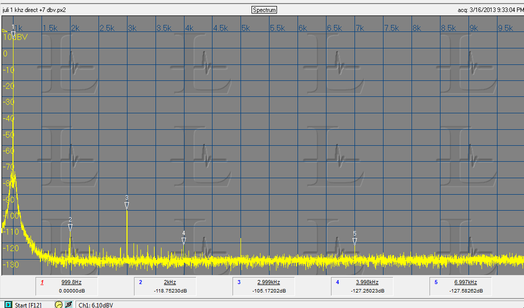

Attached is a measurement I made of a stock Juli@ card in March. While there are limitations in the card they are not significant in normal audio testing. The control panel works well and its integration in XP is great. it works fine in Win 7 but all cards in Win 7 get caught in the sample rate converter stuff. You need to manually switch the Win sample rate to match the card and the application. ASIO avoids this but still requires manual intervention.

The card the user recommended is pretty poor in comparison for performance. I think that user is naive. In pro applications you want a few controls as possible (eliminates mistakes as well as potential gain structure problems). As said earlier using a digital post ADC volume control is a poor idea and analog controls when the card is inaccessible makes little sense. Also the inputs are not mike level so you would need a mixer anyway.
