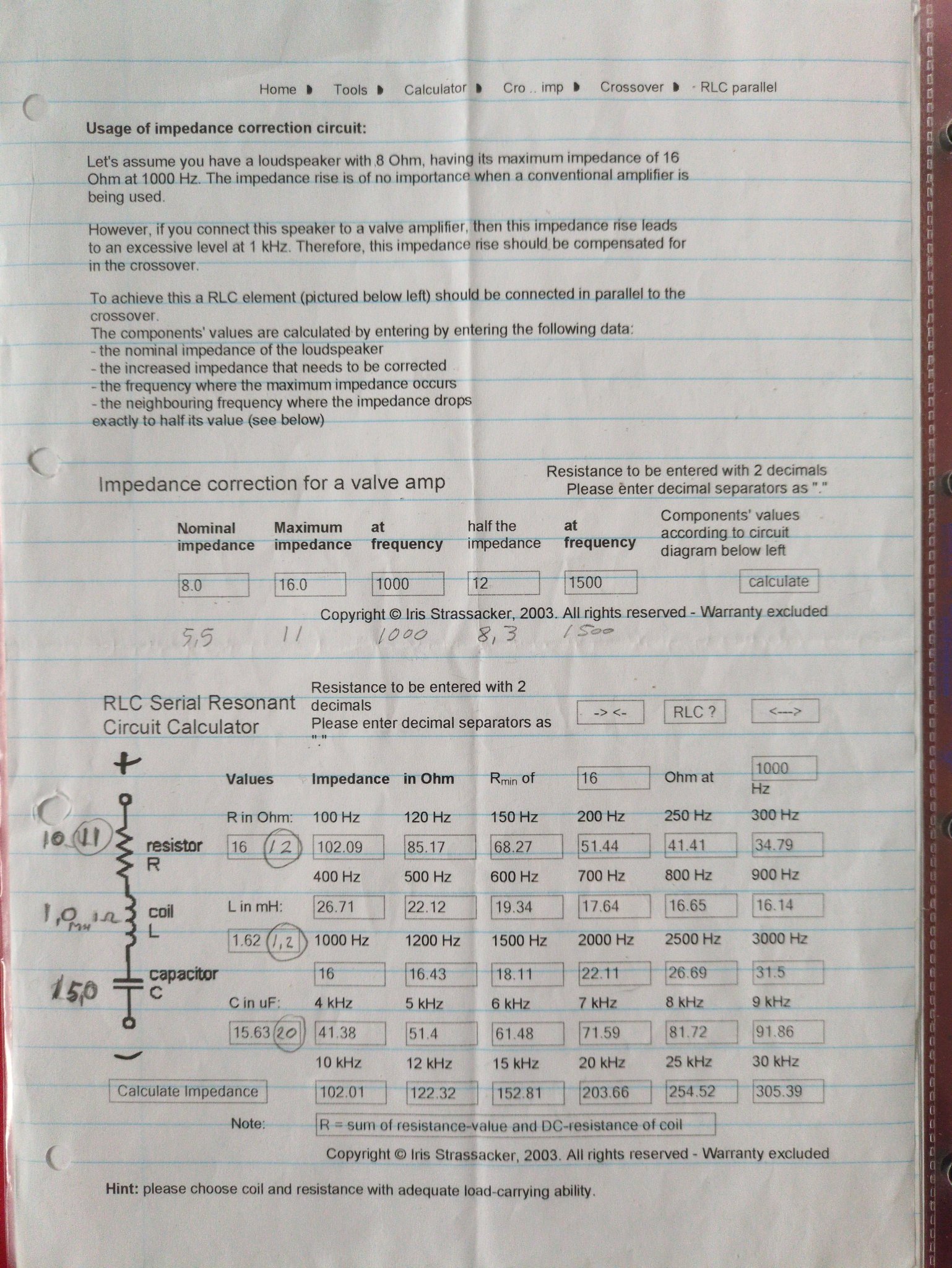

I sow it on this homepage from Strassacker hifi shop. They recommend this RLC and have a calculator to download on there homepage.

My thought was unsophisticated about this attachment i send. Is it profitable with a RCL in the crossover to compensate possible problems with the match to a valve amplifier. Do it give sense. I suppose its a question that's not easy to answer.

I have build the TSE ll from the George's tubelab website with application for the type 45 tube and 6K ohm 60ma output transformer. (No catode feedback)
I want to match them with (crossover upgraded) Klipsch RP600M
Then I sow this attachment with the RCL calculator and was wondering...
I think i do not know enough about this issue.
RLC = Resonance

Thanks for the input. It looks like that it is a good pointe to keep it simple, as possible... What about the quality of the components in the RCL ? I have tried to smooth a objectionable peek with a paralel RCL in serial with + on the Fostex103 EN (do it yourself kit from 2003)
The success was ok and "good", but there difference between Por or good components was Audible.
My eksperience was, that A peek especially at 4000 Hz can be very nasty for the human ear.
Conclusion for me may be to experiment and use my ears.

No I have not listened to this match yet. I am still in progress with the upgrade of the crossover to better component quality. I want to create the best possible condition for the match (Klipch RP 600M) to the amplifier. Then i sow this attachment with the RCA calculator and the recommendation to use a RCL in the crossover when the speaker is to connect to a valve amplifier. I was wondering about this and realize that i not have the knowledge to take a decision about it... I ask myself will it give sense to install it.
Then I think i have to ask a question about this issue here on the diy audio forum. I am happy i have done it.
Now I Know better than before... Thanks a lot.
