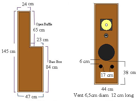

Hello,
I use a 25W tube amp with a diy loudspeaker. This loudspeaker is made with a Fostex FE206E + FT17H on open baffle upon a bass enclosure with an Eminence Delta 12 LF. The problem is that the damping factor of this amplifier is not friendly with Delta 12LF and I have not enough dynamic and efficiency on basses. I need a RLC series notch filter before using bi amplification but I'm not sure how to calculate it. Does somebody could help me ? 🙁

thank you for a so quick response. It's free air, Eminence specifications. I have mounted the driver in a approx. 100 Litres box with 2 vents 7cm x 12cm. The crossover is approx 380Hz. The sound is good, but not good efficiency. I have tried with a 70W solid state and it's better, so I realy think it's a problem of RLC. I don't have time to build an active crossover and money 🙂 for a bi amp at this time, only in the future. For the moment I want try passive. The sound of FE206E+FT17H is fabulous on open baffle. The cross between FE and FT is just made by a 1,8µF cap. I have tried an Eminence Delta 12 LF because if I can make a real good loudspeaker with it, it will be a real good DIY project for all the people who want a great loudspeaker with not spend all their money.

Box: internal dimensions are w 39 cm x deep 42 cm x high 79 cm. The internal faces are coating ("enduit" in french) with tar. In the box they are 3 renforceiment rectangulars bars (2cmx2cm) and one behind the driver (just under magnet between sides right and left).
Vents: 2 vents 6,5cm diameter 12cm long (positionned 7cm under the driver and at 7cm each of each side, 17 cm between the 2 vents)
On front side,the bottom of Delta 12 is approx at 38/40cm of the bottom of the box.
All external angles of loudspeaker are made with 1/4 of round

Hello boys,
after I have adding a LPad on Fostex drivers (more than 100db) the result is better. And I have added a little bit of "gaze" (in french) in vents. Basses are more present and good. I think it will be better with LRC parallel filter, so if someone have an idea.
