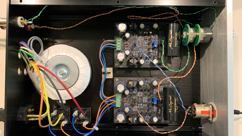

@mksung yours is a beautiful build !!
(If you feel the wiring is messy please do not ever look at mine 🙂 )
Share the picture installed in the box, the wiring is not very good and a bit messy.
The wires to the RCA jacks could be shortened, it's true, but overall that's a near textbook build. Congratulations!

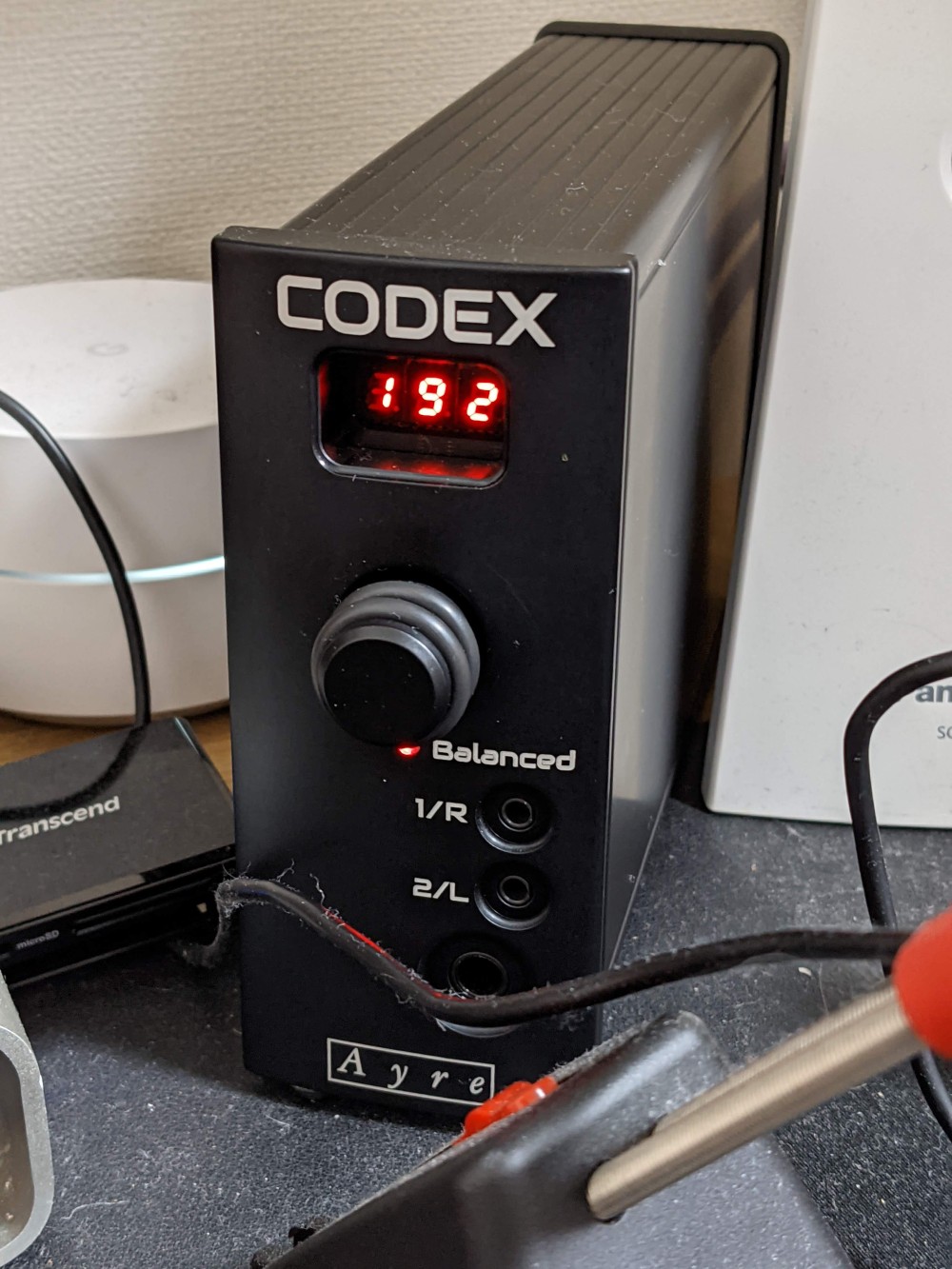

I new bit of gear joins my Sapphire 4 at the home PC.
The Ayre Codex is a USB DAC . preamp . headphone amp with balanced, discrete analog circuitry and a "lossless" digital volume control.
It replaces an Asus Xonar Essence STX as my digital front end. I use it in DAC mode (line out, no attenuation), optioned as a backup headphone amp.
As headphone amp, with my Sennheiser HD600s in single ended connection, the sound is too plump for my taste. As a DAC though, the warm, analog sound of the Codex output is highly synergistic with the Sapphire's overall authority.
In all honestly the Codex could benefit from a lower noise floor, but for the complete absence of any digital "grit", immediacy, and warm ambience, it's well worth the money.
