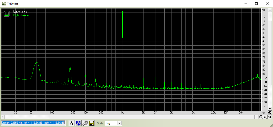

Anyway, mounted. And the sound is good!
But ... strange peaks. (60hz, 180hz, 300hz ...)? 😕
Will it come from the power supply?
Disregard, my fault.😛
A ground connection has been forgotten before closing the chassis.
Nice! Thanks! 😀
Nice! Thanks! 😀
Yes, the circuit must connected to the chassis or there will be hum (your peaks at 60, 120, 300 Hz). Your RIAA analyzer data also shows a noise baseline of about -118 dB, and some small peaks at 2, 3 kHz and higher. Probably those are all just the limits of the soundcard, not the Sapphire. Your audio measurement system appears to be running in 16 bit mode. It's a good idea to measure the loopback condition (soundcard output -> soundscard input) as a baseline to compare against.

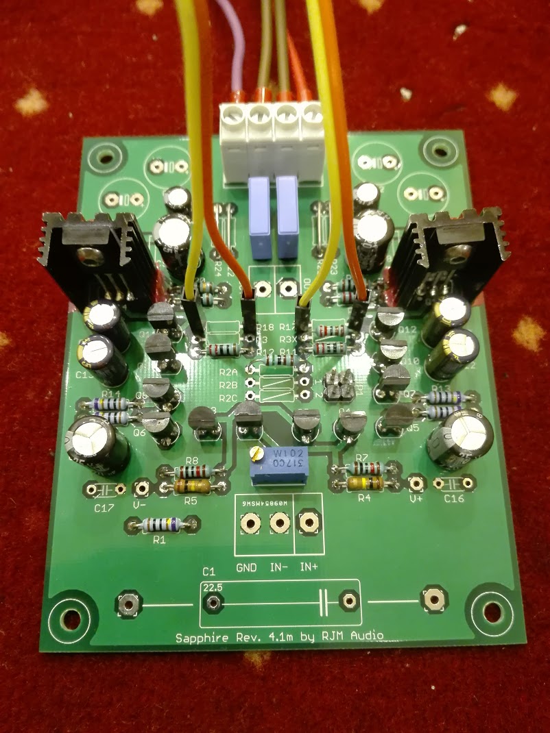

Hello, gratings from Poland!
I have just build my Sapphire 41m and it is working quite well.
I have used BC550C and BC560C from Fairchild , (all from group C, matched Q1, Q2 with gain 650 and all the rest with gain 560) and for Q13, Q14 2SA1220A and 2SC2690A. (just what I had in my drawer from previous builds)
I haven’t install Q15,Q16 and zeners, as I used stabilised power supply based on two LT317 – the design described is on this page: Using 3-pin regulators off-piste: part 4
I even didn’t try to use build-in stabilizer based on Zener output – for my experience the quality of power supply is always impacting the final build and the stabiliser build on two cascaded LT317 is performed outstandingly as headphone power supply. The rectifiers are fast diodes BYV27 and filtration is 3x2200uF for each rail . I can set input voltage up to 18V, but decided to use +/- 12V. I used 4 small transformers 6VA with one secondary 18V AC each. (so the total used are 4 mini transformers, 8xLT317 and 12x2200uF)- power supply section takes more space as the amplifier itself.
For R6 I used 1k potentiometer and it is more than enough.
With default BOM parts for all the resistors I had bias of about 40mA, changing R17, R18 to 3R3 the bias went up to 65mA and finally with 2R2 settled on 98mA.
The heatsink temperature is about 50 C degrees and I thing I will keep it this way. The power supply works better if the output current is at least 100mA
One channel is open loop the other is closed , both are stable.
I didn’t listen the amp much, just did all the measurements. It is burning–in and in a few days will do the leastning tests. The main headphone I intend to use are Senheisers HD600 , but will also test it with Grado SR325.

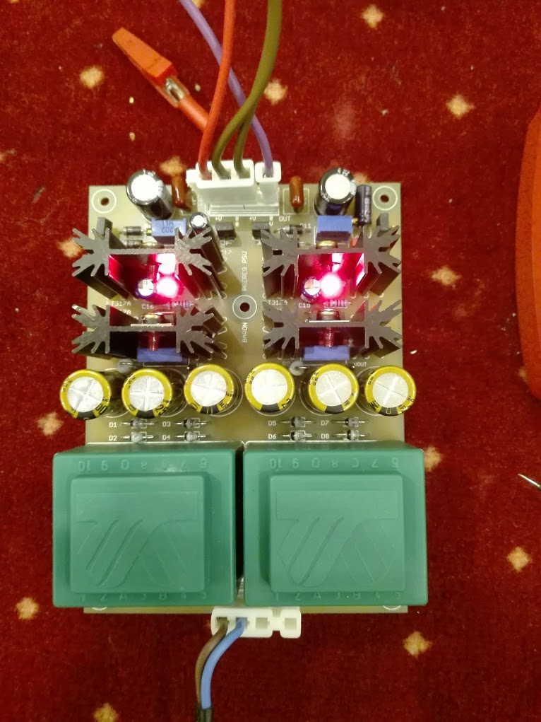

This is by no means the final build. I wanted to quickly start it up to measure it and discover the potential of the design, hence the use of regulated power supply that I already had available and the quick hack of replacing R17, R18 did the trick. I was able to test all the parts I used and evaluate the amp.
In the final assembly I will mount them under PCB and use the case as heatsink.
I ordered "1907A Full Aluminum Headphone Amplifier Chassis" from alliexpress but it will take some time till I get it from China.
I already like the amp and I'm quite happy that I build it. It is very simple, with all parts easy to source, yet effective and pleasant to listen to.
I will post a photo of a finished amp when ready.
