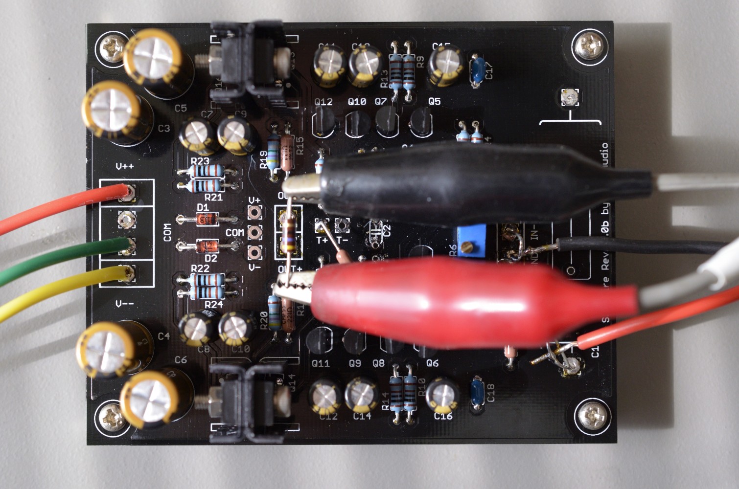

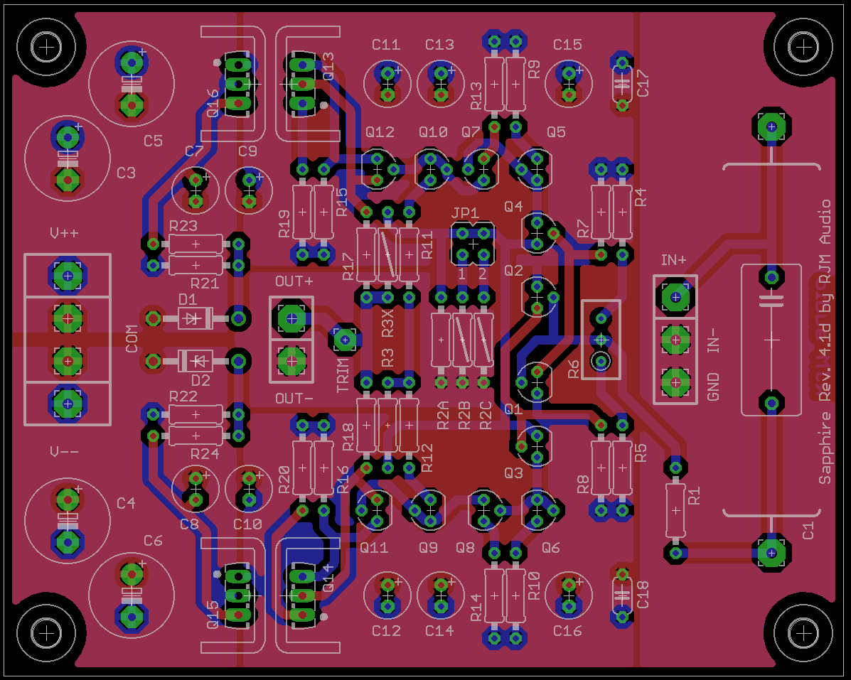

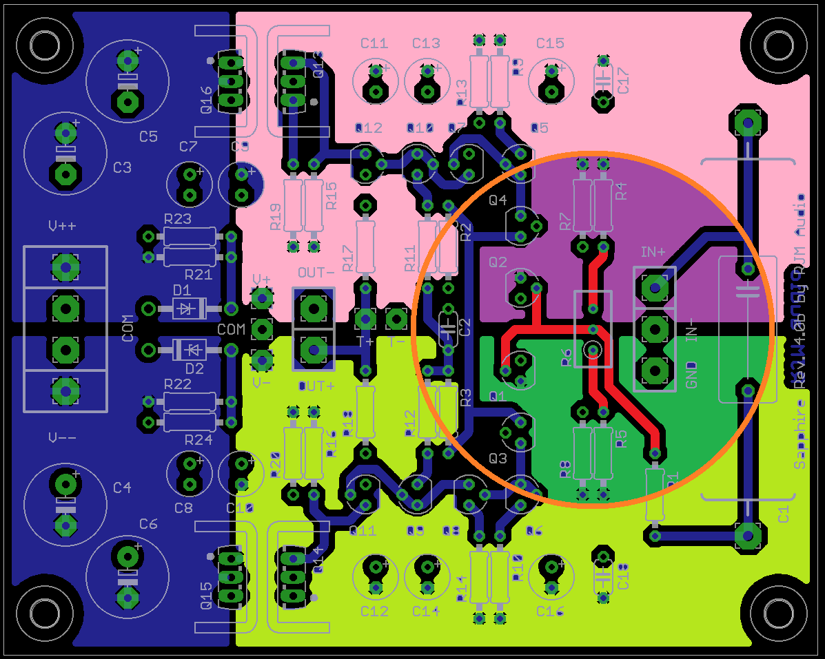

@everyone Attached is an image of the bottom metal layer of the Sapphire 4.0b board. As that middle-management type in Star Wars says "We've analyzed their attack, sir, and there is a danger" ...
The red traces are the input to Q1,Q2 and the near-zero potentials on either side going into the trim pot. This is all high impedance area, biased to about zero volts by the voltage divider R4,5 between the power planes V+ and V-, colored green and purple.
You can see that these power planes go right up to the red traces. This presents a risk, as any accidental resistance from V+ or V- and those red traces will act in parallel with R4 or R5, pulling the bias voltage up or down. Since R4,5 are 100k, a few megaohms would be enough to move the bias value several hundreds of millivolts.
While it's unlikely to be a practical issue please be fastidious about not getting flux or grease or miscellaneous glop spread all over the area around the trim pot.
In future iterations I will address this by adding greater isolation or possibly a shield around the sensitive traces.
note: no I don't think this is what caused Stan's problems~

you wrote millivolts earlier though
"OL, says Fluke; the other side measures 271mv"
Sorry, my bad.
... power planes go right up to the red traces. This presents a risk, as any accidental resistance from V+ or V- and those red traces will act in parallel with R4 or R5, pulling the bias voltage up or down. Since R4,5 are 100k, a few megaohms would be enough to move the bias value several hundreds of millivolts.
I usually wash down a pcb with methyl hydrate or contact cleaner to take away all the excess flux and glop that can be there after working on a board. This allows me to see if there are any solder bridges or such. Sapphire 4 was no exception, I'm quite certain this was not an issue. But I see how easily it could be.
Since you confirmed the resistance of R4,5 in situ to be 100k exactly, we know for sure it wasn't an issue. And anyway I knew without asking you'd have been very careful. I just put it out there because it came up as I was reviewing possible causes.

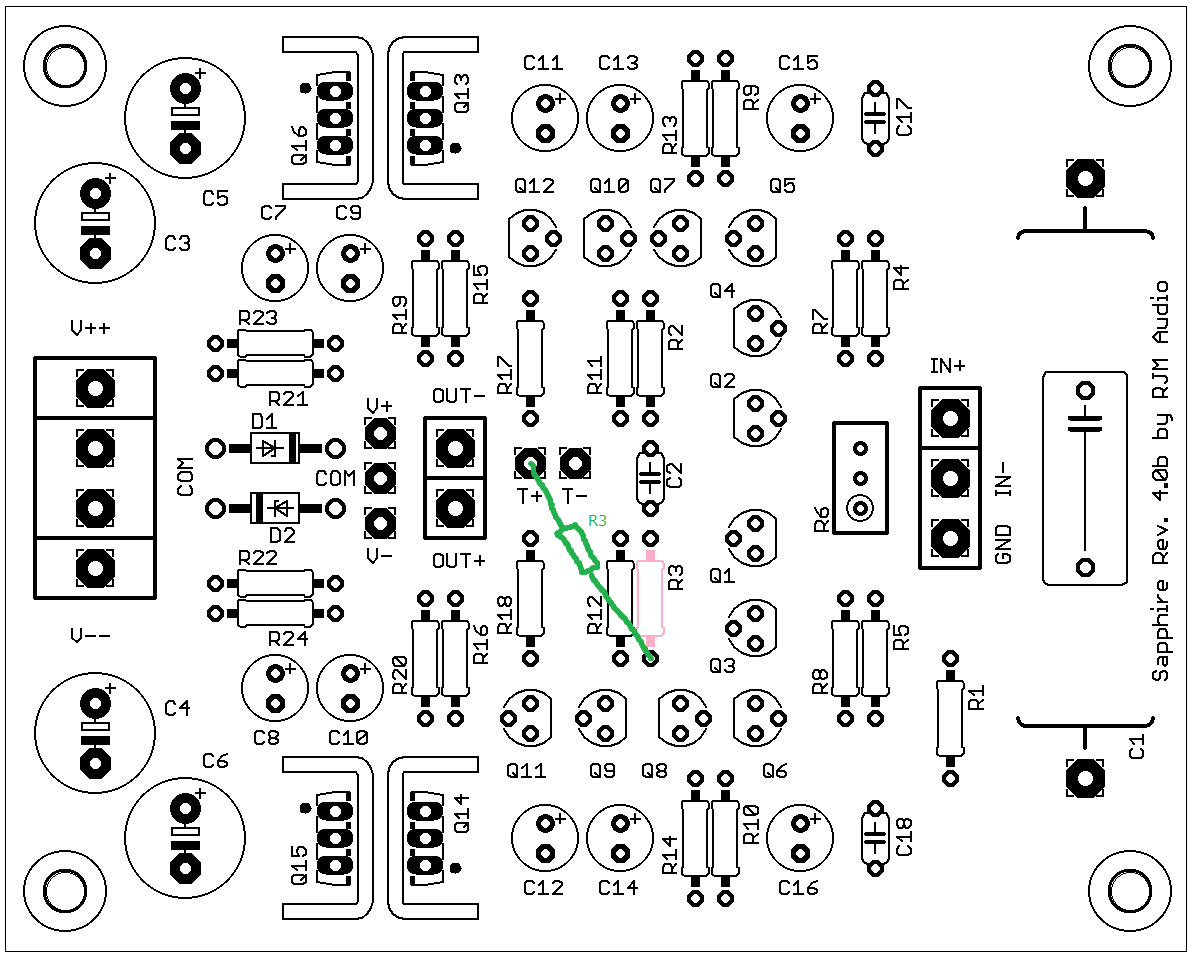

bench notes:
I tried the feedback modification where R3 is connected to the output rather than the current source node R11-R12. R2 was 100 ohms, R3 was 2k21. Test load 47 ohms, 60 mV input, 50 kHz square wave. Works as advertised with C2 = 0. The expected bandwidth is about 2 MHz.
BOM 40b9 attached. R6 changed to Bourns type, and recommended values for R2 R3 with the mod have been changed as I realized the gain formula is different in this configuration. It's R3/R2+1, not 0.5 R3/R2+1 as it is with the normal connection.

bench notes:
I tried the feedback modification where R3 is connected to the output rather than the current source node R11-R12. ...
Listening test? Have you tried this or are your 4.0b boards currently farmed out to another builder? You wrote that 4.0b, compared to your last 3 build, showed some recession of treble intensity and transient response. I didn't get that from my listening and that leaves me wondering what else I may have missed in skipping the last iterations of 3.
Back to my board inequity. I'm tempted to try another set of zeners. Except that it's working and sounds so lovely I'm reluctant to take it apart again. That's how I got stuck on AD8610's. My experiment with designer op amps many posts back was a crashing failure, so I didn't try any others.
The evidence suggests that I follow your lead, but something tells me I need to find the bug first.
I have the boards still, just not cased up. I checked the mod to make sure it passed square waves without flying off its rails, that's it so far.
With a resistive load it works as simulated, but the real world influence of the headphone inductance for example is not considered.

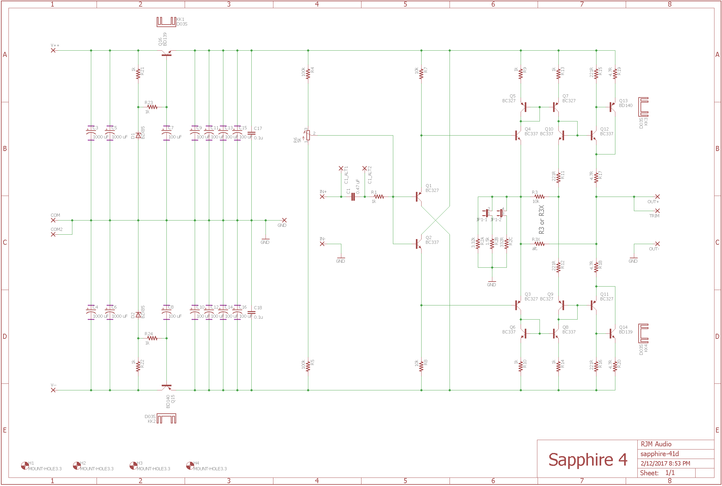

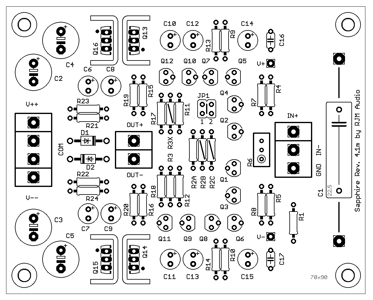

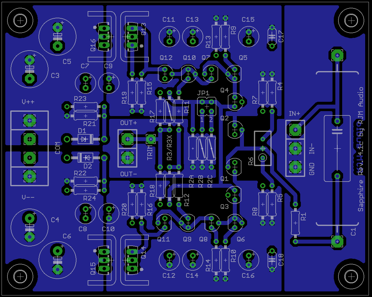

Some thoughts about what features to bake in (and which to remove) on the next board revision.
In addition to increasing the clearance between the power planes and the input, the main thing I feel needs to be addressed is gain selection.
This is done with a two position jumper and three resistors for R2, one fixed and two optional. Three gain options can be configured, 8-15-25 dB for example.
The other is the feedback connection. Rather than the flying resistor mod, what you have here is two R3 positions on the board. Use R3 for the usual connection, or populate R3X instead of R3 if you want to connect to the output.
I considered making this a jumper setting, but the thing is the values of R2 to use with R3X are different than for R3, so even if R3 was switchable you'd have to pull out all R2 and add new resistors to match. So realistically the board would have to be built as one or the other, which is why I opted to nix the second jumper.
Removed the V+ V- pads, and the T- pad (voltage TRIM an be referenced to case, COM, etc...)
Input welcome.
Input welcome.

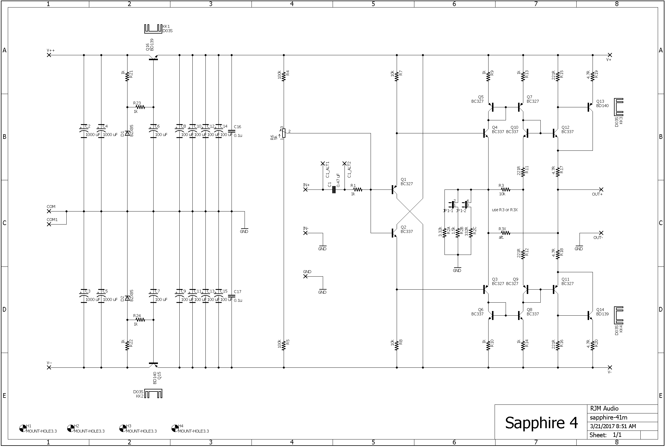

Sapphire 4.1m
There were some layout tweaks in development, but the production boards 4.1m are not very different from 4.1d introduced above. Will have in hand by late April.
No, the 70x90 indicates that the mounting holes conform to the metric standard for RJM Audio boards. The boards are 80x100, like before, and the mounting holes are the same also in this instance. The "70x90" label makes it explicit that this board conforms to the latest standard which I am working to make all my projects conform to, as:
