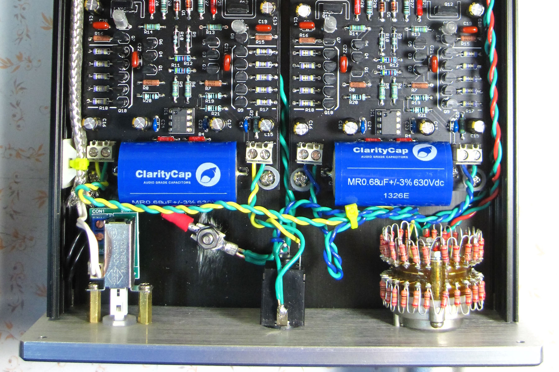

It would be nice to hear a comparison between the Rikes and the ClarityCaps I installed in my Sapphire 3. I bought MR ClarityCaps and Mundorf ZN, both .68uf, with the intention of trying them both against the Multicaps I broke in on Sapphire 2. The ClarityCaps sounded so good they relegated the Multicaps forever to my parts bin; and I've been so happy with them I haven't yet tried the Mundorfs. And I am still running AD8610's.
Very, very happy, indeed, with Sapphire 3. Been thinking about upgrading the volume pot as RJM has on his, I don't like the stiff, large steps of the one I built.
