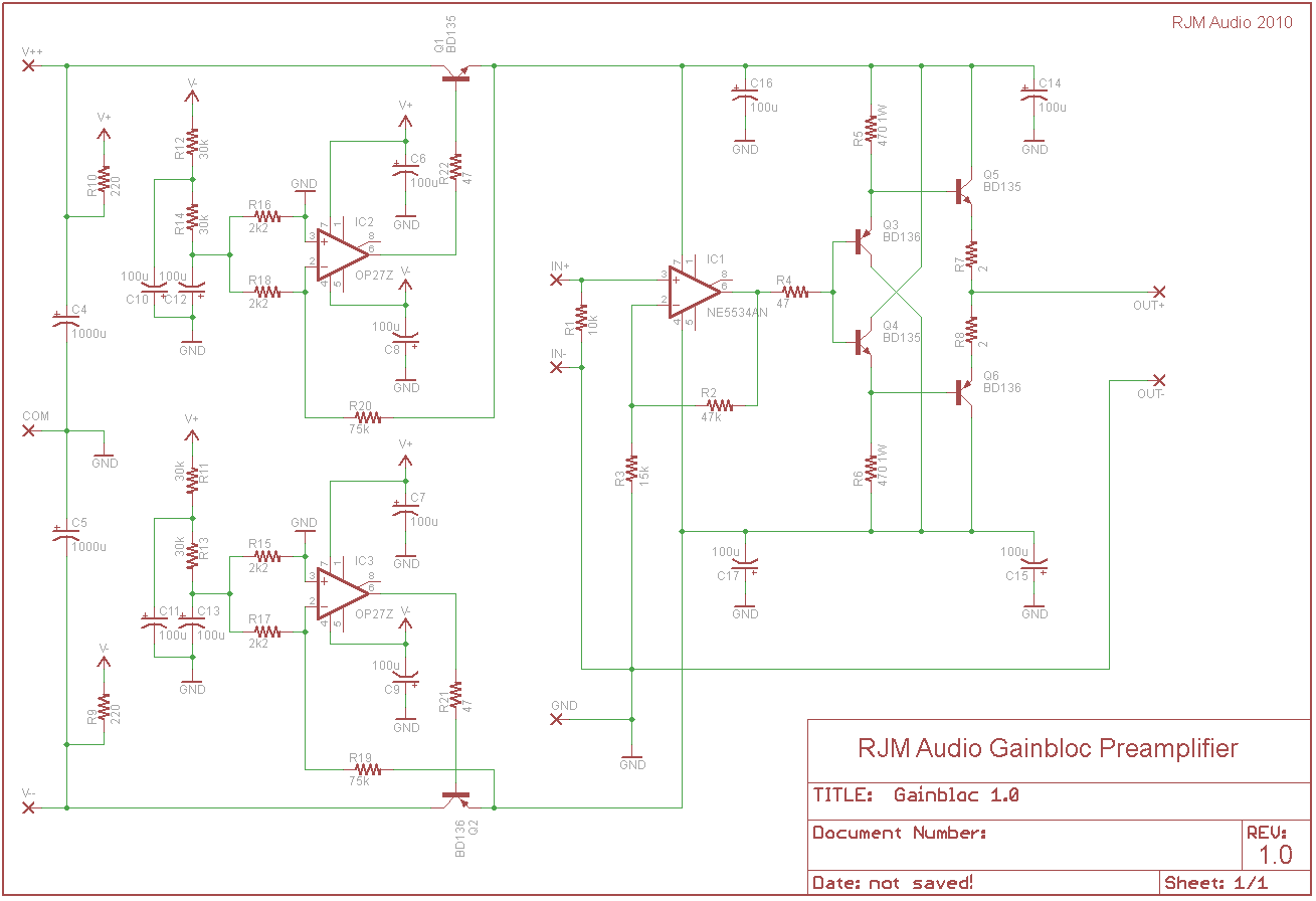

Here is the circuit schematic for the rev 1.0 gainbloc. The circuit is technically functional, nothing more at this stage.

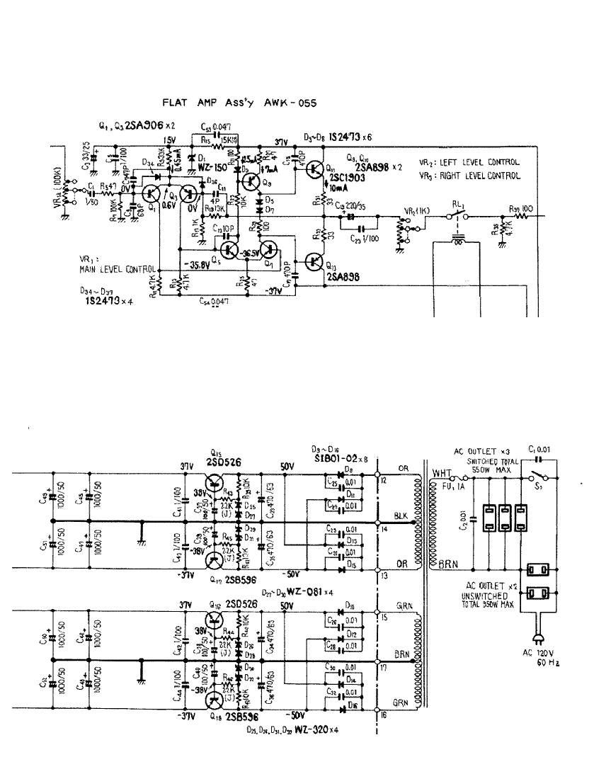

Extract from the schematic of the Pioneer C21 preamplifier showing one channel of the line stage and dual power supply which evolved from separate secondaries for each channel.
This was considered a high end unit at the time.
7 transistors for the amplification, and the old zener+transistor voltage regulator...
Food for thought.
(munch munch munch...)

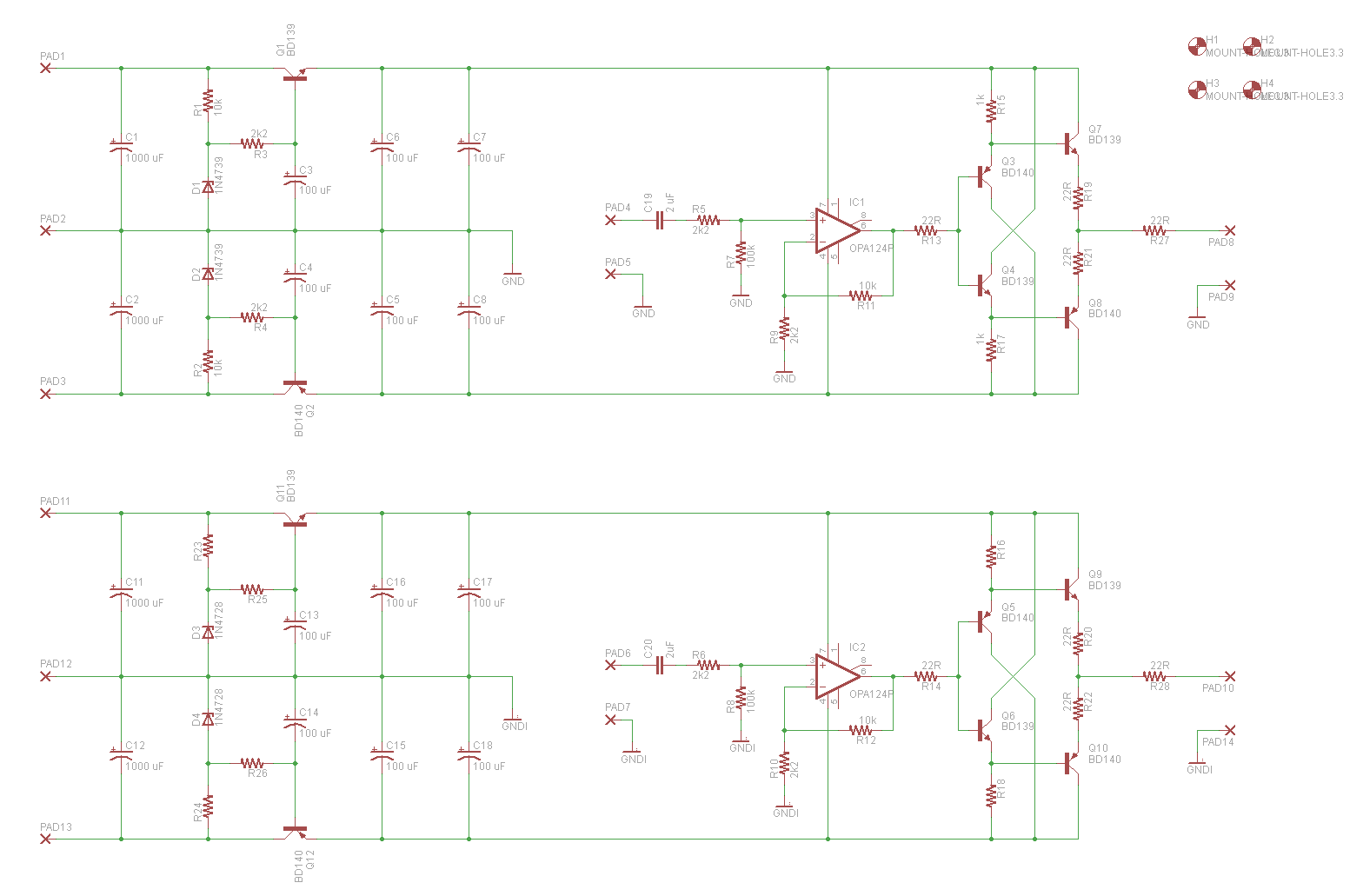

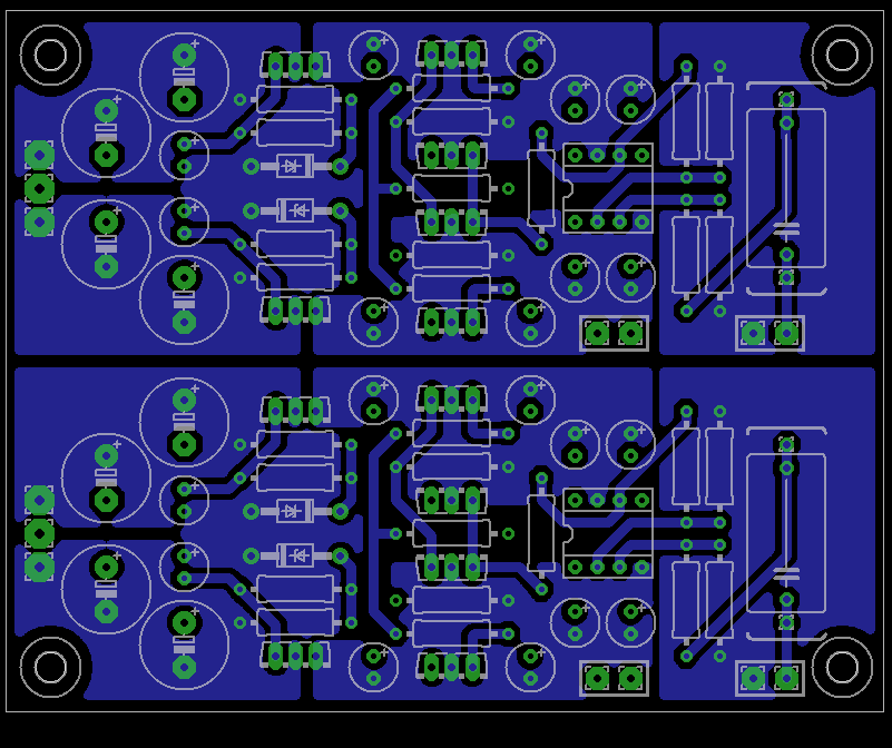

So here's the first revision to pass DRC. It's a preamp - it's a headphone amp - it's whatever you need it to be. Two circuits on a 8x10 cm board.
The strong 70's vibe of this design is intentional. Retro solid state, with a tip of the hat to the Pioneer C-21.
