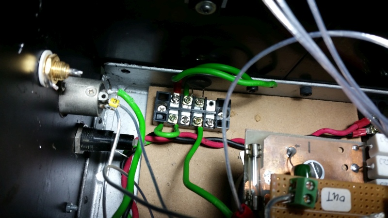

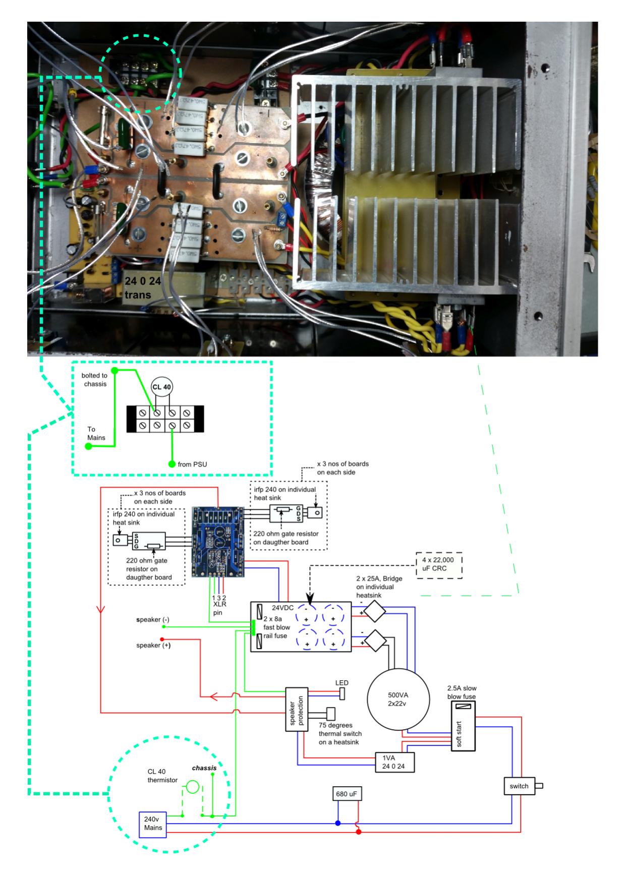

There's only one earth wire at the IEC and there are two connections to it, ie. the chassis and the PSU ground. Somewhere along the way, if the the PSU ground is connected to the thermistor, the chassis connection is bound to come into contact with the thermistor. I don't think there's a way to avoid this.

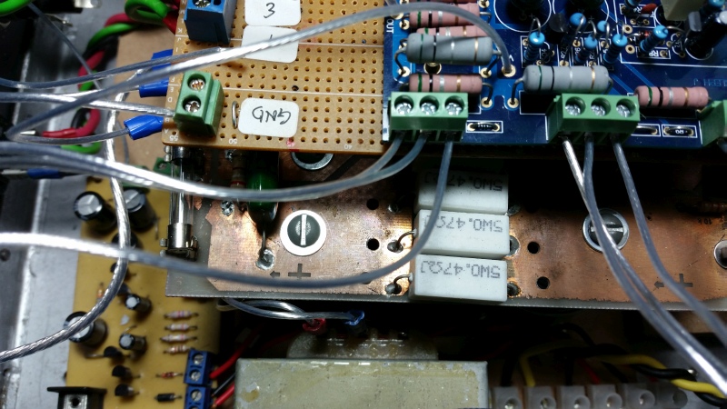

i measure 4.17v across R27 and I have 0.5 3w source resistors instead of 0.47 3w resistors. My question is : why are these source resistors measure at 0.6xx V?

post53 is wrong.
It shows the PE wire connected to a thermistor.
Connect the PE wire to Chassis.
Hi Andrew, Thanks but if I connect the Mains PE to the chassis then where do I connect the PSU ground to? Could you be kind enough to sketch out the diagram?
safety gnd from IEC socket directly to chassis
audio ground (central point) connected to chassis via 10R to 15R NTC
say CL60

Thanks ZM and AndrewT. I appreciate both of your help very much. Does the attached 'diagram5' looks right for the PE connection? Also, what is the likely problem for the big difference of voltage across the source resistor if the mosfets are matched (aj measure2)?

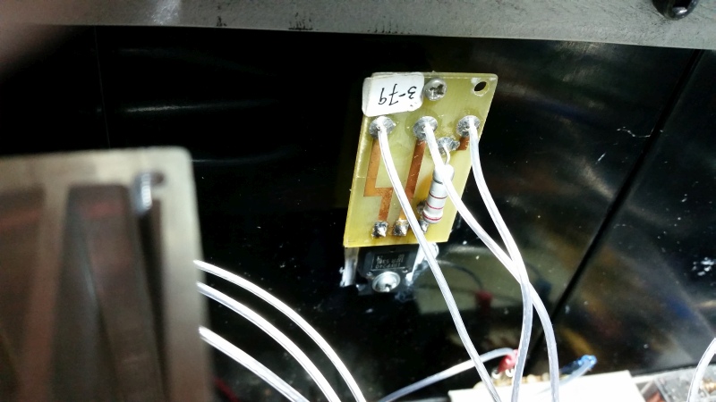

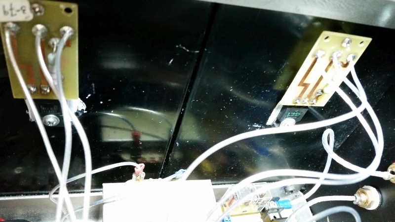

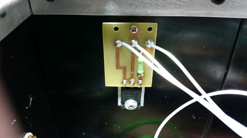

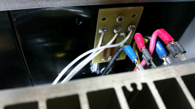

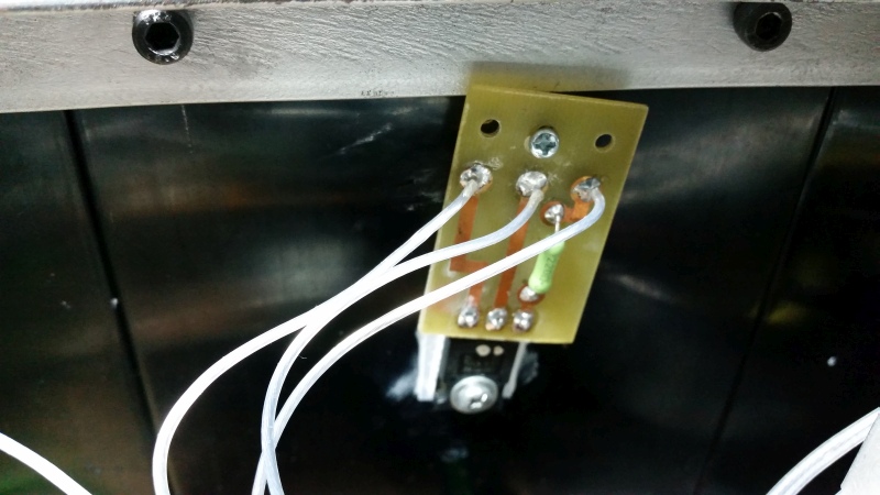

I have changed all components to new ones except for all the source resistors but the problem persists. I don't think the problem is with the board. I suspect it's the power supply. Now, the power supply is at 54V. Previously it was at 56v, I wonder where did the 2v go? and the problem is exactly the same as before, the dc offset went up to 80mv and now it is at 100mV. The additional 19A source resistor goes up even higher at 0.900v but the R19 remains at 0.534v no matter how i swapped them.
mains power at 240v.
